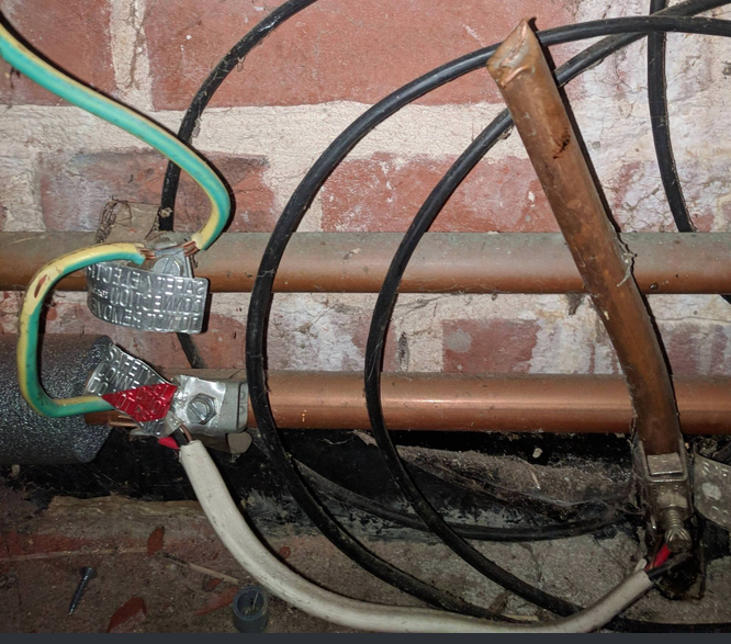

No sign in those photos of an earth cable to the CU.
What wazzock did this?:
the 16mm earth goes up behind the consumer unit and in.
the flex cable is a great touch i know. whoever did it obviously knew the earth was ****
Are you saying that that green/yellow cable coming from the pipe at the bottom (and disappearing behind the board) is 'the' (only) earth?
Kind Regards, John
yep that's all I can see
