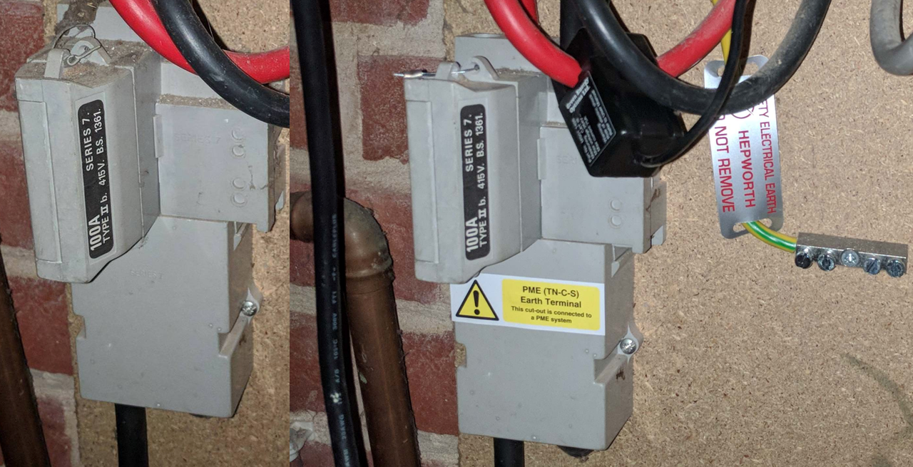

I know DNOs get funny about doing anything on the consumer's side - it appears they have now merely connected an earth block for your electrician to connect to.
You'd like to think they could run a 16mm2 earth from their earth block to your consumer unit.
Some will, some won't.
Seems a dangerous way to knowingly leave an installation.
I agree, but that would seem to be what they may well have done.
And if they didn't connect that block to the earth bar in the CU then you still have no earth, and you must get that resolved as soon as you can, if not sooner.

They came out because I called them again and sent them a photo of the installation showing there was no earth, they didn't know if it was pme or not so sent someone
The annoying thing is uk power networks (Dno) seemed quite annoyed that I'd been suggested to call them and they were frustrated with the electrician and we're saying "oh he made you worry you didn't have any earth".
but it seems i do have an earth just nothing connected into it and no way to connect to it until they put the earthing block in.
quite a frustrating scenario.
I'll run a piece of 16mm earth to the block they installed from the consumer unit.

Yes connect the terminal to the main earth bar and make sure the bonding is secure.
Ironically by adding that exposed terminal but not the bonding, they've created a dangerous situation, as the neutral/earth of the supply could be at a different voltage to any earthed metalwork in your house, even with the main switch off.
If you want to be really sure, avoid touching that terminal or anything connected to it directly at the same time as any other metalwork in your house, including the consumer unit earth terminal. Once they're properly connected it's fine. Don't wear shorts and lean on a metal water pipe for example.
You sent them a photo, they couldn't tell if it was PME or not, and they sent someone out who said "its clearly pme".
Now it clearly is, but before it wasn't - spot the difference:
Electricians may not unilaterally decide that a supply is PME and use the incoming neutral as the earth.
He was right to worry you - you didn't have one.
There was no provision for you to earth your installation until they made their supply earth available to you.
ASAP! Until you do you still have no earth.

I've connected up the earth into the consumer unit.
inside the consumer unit I've put the earth into earth 16.
