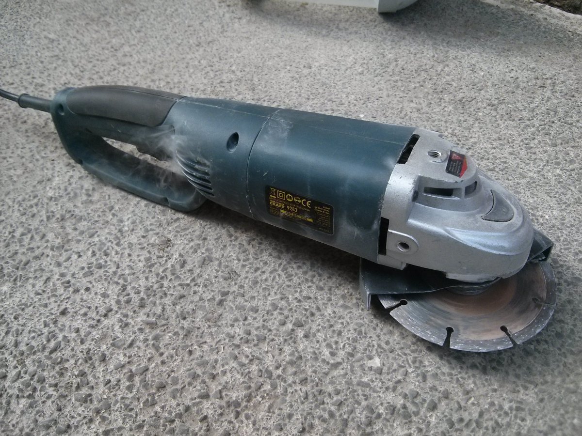

I have a 10 year old Aldi powercraft 4 inch grinder which I had used to grind lips off brake discs, cut the odd brick in half and such on.
About 12months ago it started with the intermittent stop/starting which turned out to be brushed. Luckily they supplied some spares which I changed.
Over the last few weeks they have gone again and I've bought some cheap ones in eBay to get me going. After fitting these Thursday all was back up and running. Late Friday afternoon, it started with the intermittent stop/starting again so I'm assuming (without properly checking( it's ate them set of brushes. It did do quite alot of hard graft Thursday with cutting base panels on fencing and grinding the inside of a gnarly concrete fence post.
Any tips or help as to what could be causing the excessive usage? If it's terminal, I'll look at replacing it with a Makita but if it can be saved with minimal fuss.. it's worth a few hrs of my time to fix :)
Cheers

Thanks for your replies. I was more interested than anything. I did take another look inside and replaced the brushes with a second pair I bought. Cleaned in the insides down best I could and reassembled.
It did work for a short time, just enough to cut me a square guideline in concrete where Im going to be putting in a gate post and then bite the dust.
For seeing it's timely end I ordered a Makita GA4530 which is on its way.
Rest in peace my friend

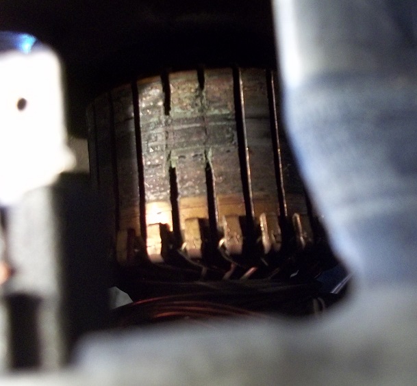

Excessive brush wear on new brushes is invariably due to the commutator being damaged by arcing from the previous set of brushes.
When changing brushes the commutator should be inspected and checked that the segments are smooth and level and the insulationg material between them is clean and free of metal contamination. If possible the commutator surface should be polished by spinning the motor shaft ( using an electic drill or similar ) and using fine grit sand paper to smooth and polish the segments.
This one was recovered enough to give another year of life.
Rapid wearing of new brushes may also be due to shorted segments or defective windings on the armature causing arcing when running normally.
