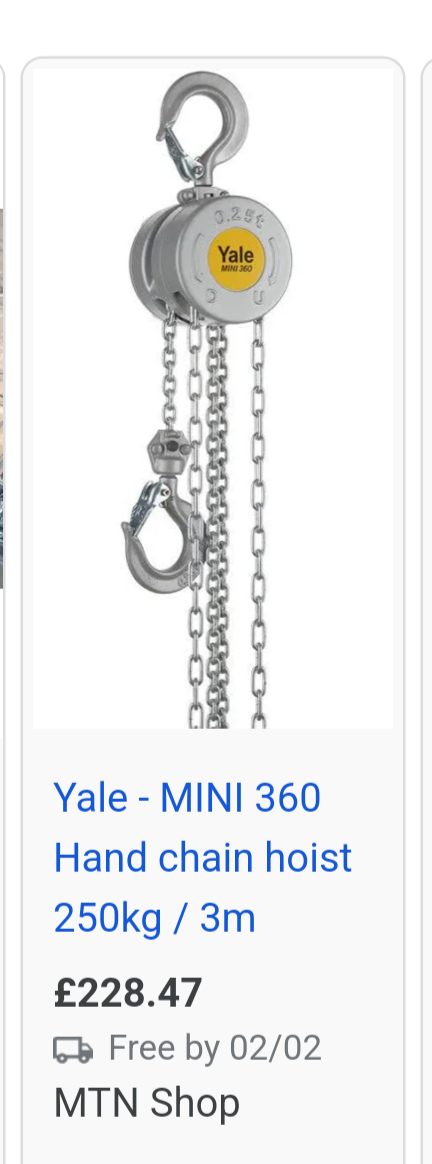

Personally I'd consider some kind of manual chain winch for the small load involved and safety. You can get "mini" block and tackle that stop dead when you leave go and could be operated from either floor. Yale do one that's quite pricey but there are cheaper alternatives.

Thanks for the Yale style alternative
I’ll give that some thought also
