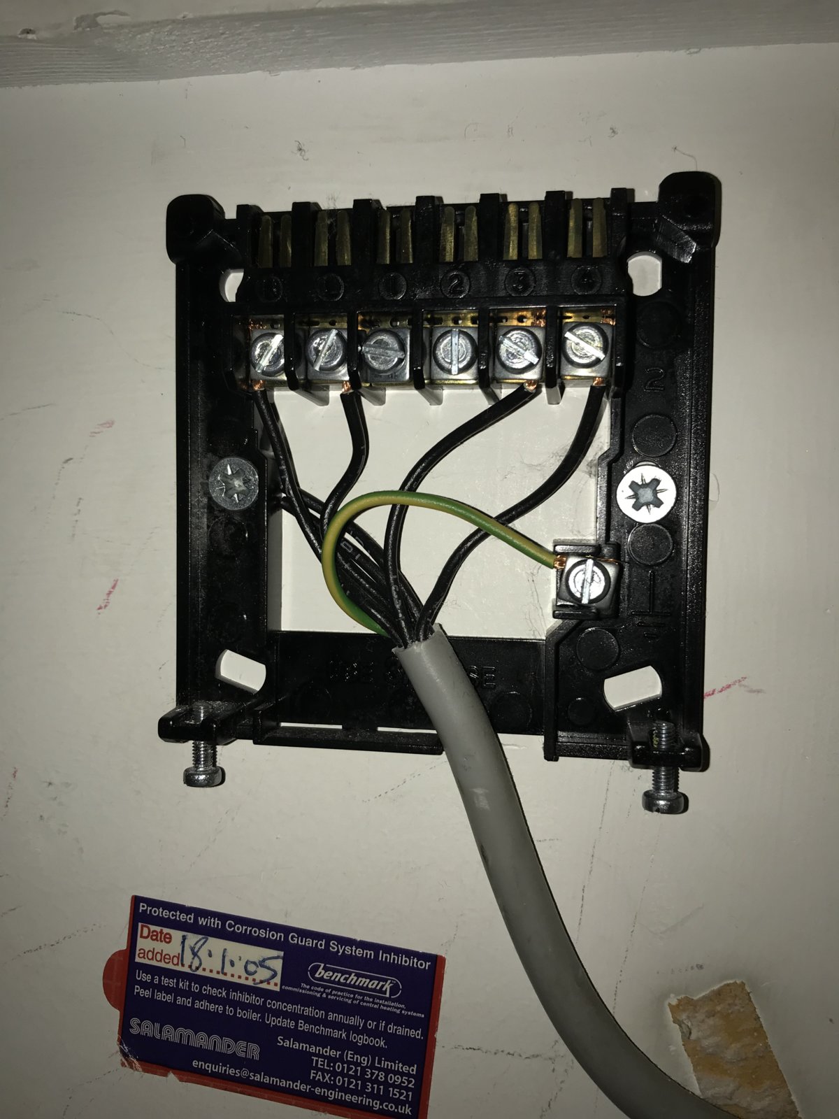

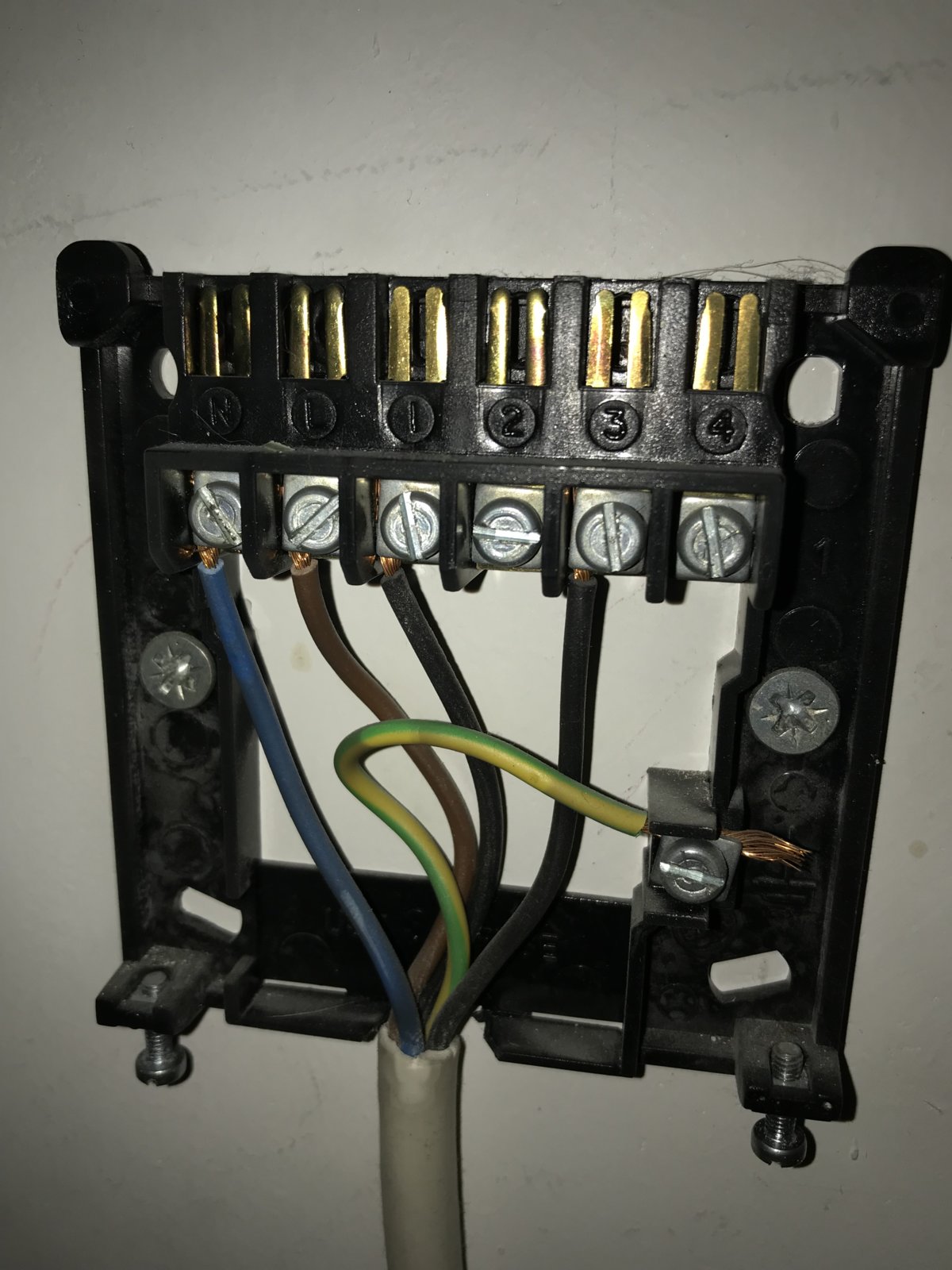

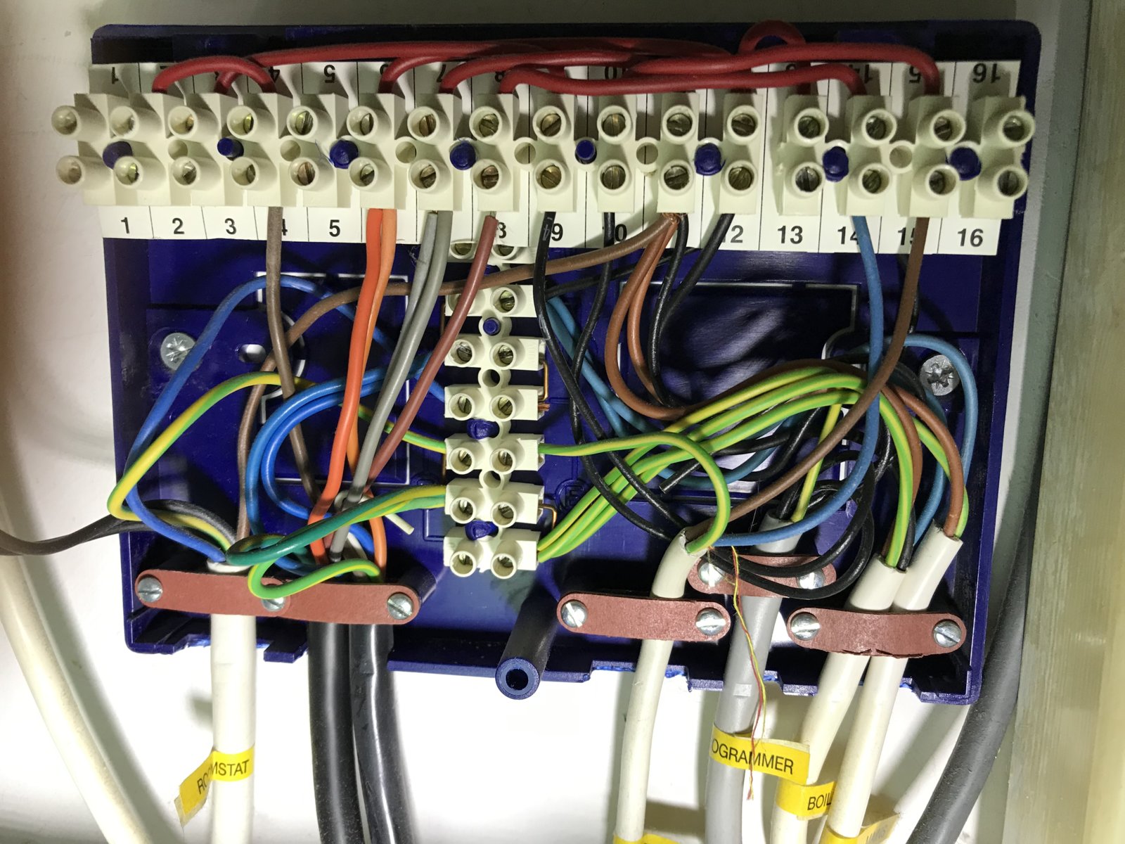

Current system is a UP2 + WR1
Have followed advice from 2 previous threads about removing the WR1 yet on both occasions the Heating works, the Hot water doesn't. so either my current UP2/WR1 install is slightly different or i'm making a mistake.
first tried, removing the WR1 from the circuit loop by joining terminals 1 and 3
second, removed the WR1 connections from the main terminal block and moving the brown cable from 4 to 3.
both of those recommendations were from previous posts yet the hot water didn't come on.
WHAT HAVE I DONE WRONG...?
The WR1 Block is the one with the coloured cables, the UP2 block is the one with all black cables.
The picture for the main block has cables 2 and 3 removed (as i hadn't yet put them back when i took the picture)
Thanks for any advice in advance.

You should have a Hive Dual Channel Version to get heating and hot water control. I guess this is what you mean by "2 ch"
With your type of system, the Hive replaces the UP2 programmer, not the thermostat receiver. [There aren't any wires relating to hot water control at the thermostat receiver. You are probably following the instructions for a combi boiler] The UP2 and the Hive are wired the same, so the wires are the same.
The old room thermostat receiver should be decommissioned by either putting both of the wires that presently are in terminals 1 and 3, together in terminal 1 and leaving the thermostat in place. Or alternatively if you want to remove the old thermostat, the trace the wires back to their origin disconnect the thermostat cable and link together the terminal you have just removed the aforesaid two wires from.

The wire in the programmer terminal 3 is the one that controls the hot water by the way, if you are looking for a "dry connection"
