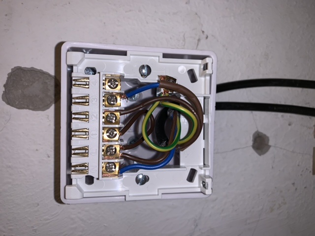

Long story short I have been left with a hive fitted to a baxi 105e and it’s a dual receiver when it should be single. Now the wiring looks like it’s been wired for a single can anyone advise on changes to make it work please.
luckily boiler still works but it only kicks in when overriding the hive.
No that is completely wrong, you should only have N&L which you have and 1 wire in terminal 4 to bring the boiler on, all the other wires are not needed you dont need any links
Thank you for the reply after some further research yesterday evening I see that is the case. Oh the joys!
So the link needs removing as there is no common, (3) needs moving to (4) as that's the correct heating and 2 just needs to be isolated?
Thanks for the help.
