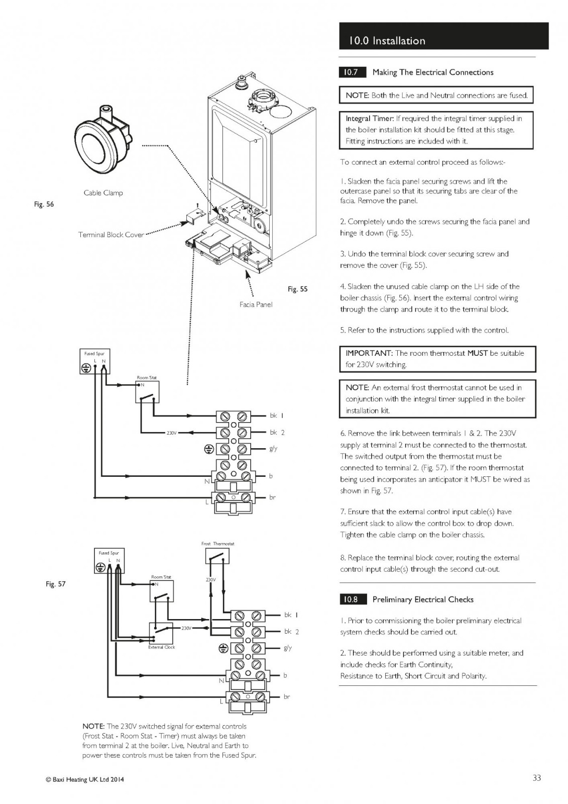

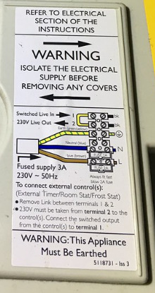

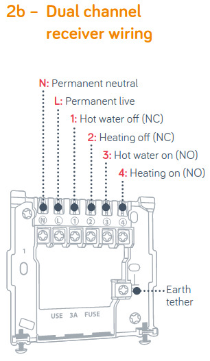

Hello, I'm using a Dual Hive for Combi (I'm using this and not single because it got it soooo cheap ). I have researched as much as i can, before asking.
Have I set this up correctly ?
Hive = Boiler
Earth = Earth
N =Blue
L = 230v Live Out
4: Heating On (NO) = 1
References used :
https://www.diynot.com/diy/threads/hive-dual-receiver-to-combi-boiler.542208/
https://www.diynot.com/diy/threads/hive-dual-channel-receiver-with-a-combi-boiler.502603/

Yes you can do that as your boiler uses 230V, but it's a bit of a fudge / bodge IMHO you will have an app with hot water control that won't do anything. Personally I would want to exchange it for a single channel Hive and do it properly. But if that's not an issue for you, that's fine.
Thank you, I got the Hive really cheap so I'm trying to be smart, but failing, also further down the line I need to change the boiler to have hot water as combi not doing it for us.
Only issue i got is the temperature moving up and down doesn't seem to do nothing to the boiler, the boiler temperature doesn't seem to go up or down.
OK keeping the dual channel makes sense.
Hive controls the room temperature, not the boiler temperature, it's simply an on/off switch that turns the boiler 'off' when the room where the thermostat is located gets to the set temperature and back 'on' when the room temperature falls below the set temperature.

Is there another thermostat that you replaced with Hive? If yes, what have you done with it?
That's where they should go. What happens if you turn the heating off using the button on the front of the receiver?
I checked and it looks like the heating is working with the hive the boiler turn on when i tell the hive to turn it on, and off when i tell it turn off.
