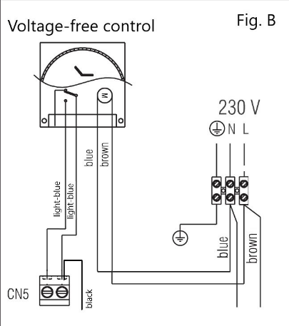

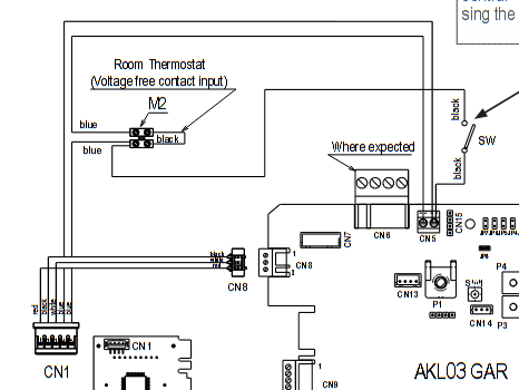

looking for assistance. Trying to connect hive hub to my Easi Heat Plus Ci. I have attached pictures of what I have done. What do I do with the cables from cN5? Should the black still be connected in CN5?. There's a loop in a terminal block do I leave as it was?
