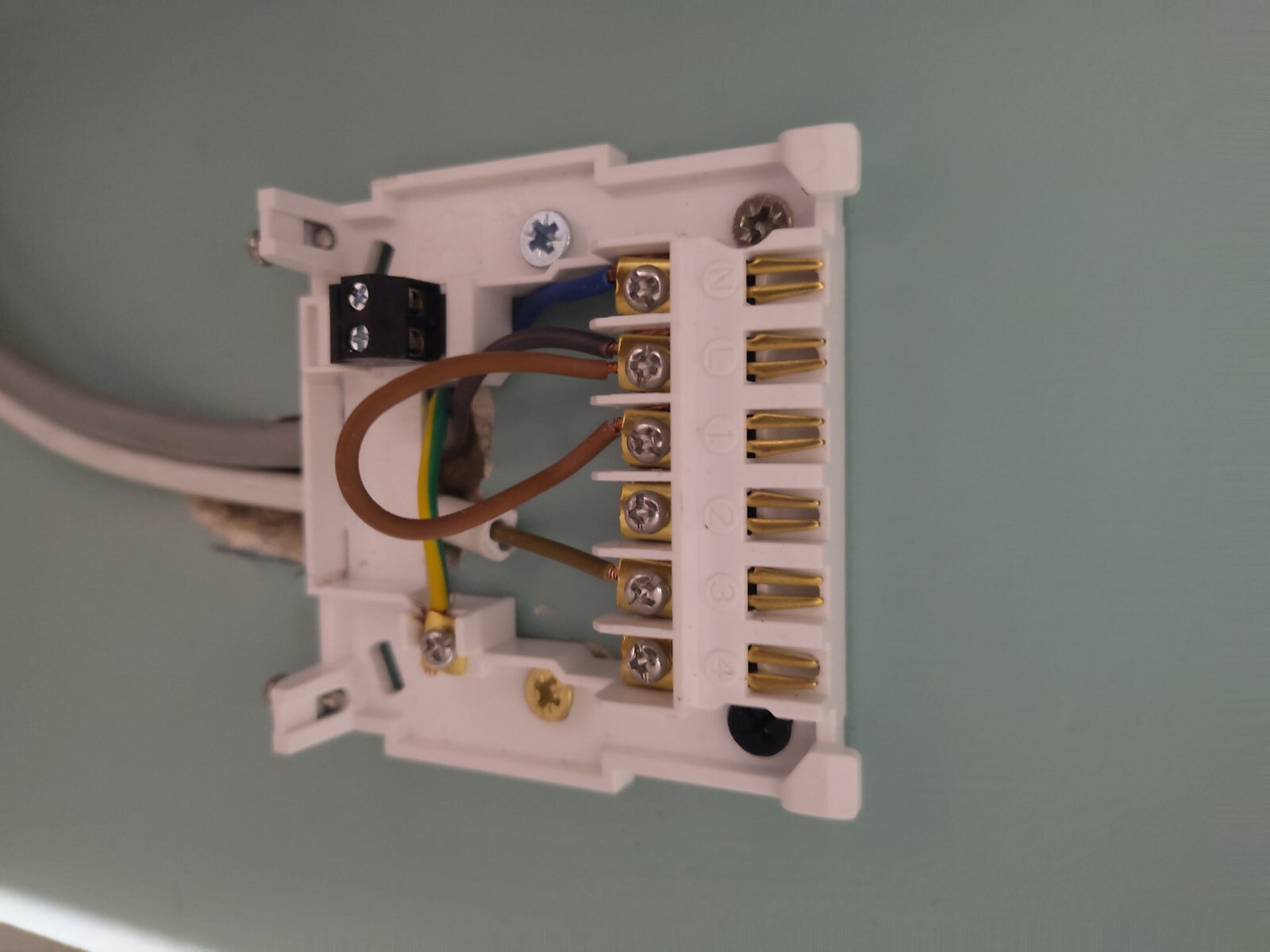

The tradesman installed the hive controller last night but it blew the circuit board on my Vokera plus 29c boiler. The boiler powers up and makes a noise but the indicitor lights don't work and there is no hot water or heating.
The tradesman connected the live and neutral on the left two connectors on the Hive, looped the live to the third connector. On the fifth connector (3) he connected to CN5 right on the PCB.
What went wrong?

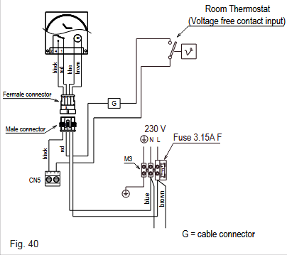

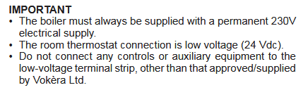

1768489064469.png Only need to read the manual to see CN5 is extra low voltage. As to gas safe, I do find it a problem finding out which boilers you can assess the wiring without breaking a room seal, and which do require a room seal to be disturbed, I remember working with pumps, using a tyre inflator to pressurise the junction box to test for leaks, but with my old boiler where the cover did seal from the room, I never found a way to test the seal, years ago and boiler now scraped, and since in the garage it did not matter that much, but only real option would have been to renew the seal, which did seem a bit daft, and mothers Bosch the cover did not form any room seal so not problem removing.

As suggested - For some strange reason he thought that the boiler would need a switched live when it uses a volt free contact. Obviously didn't check with the MI, schoolboy error and an expensive mistake.

I know today one can download the instructions for most boilers, in this case it states "A qualified electrician should connect the appliance to the electrical supply." so one assumes as an electrician we can gain assess to the electrical connections. And it directions one to section 8 (page 25) it does say
and
So reading the two pages to do with the electrical connections found here pages 26 and 27, there is nothing to say one must be gas safe to connect up the electrics, I have a feeling 30 meters is incorrect, it should read 300 mm, which is around 12 inches. But that is because I am an electrician and am aware of normal separation required.
