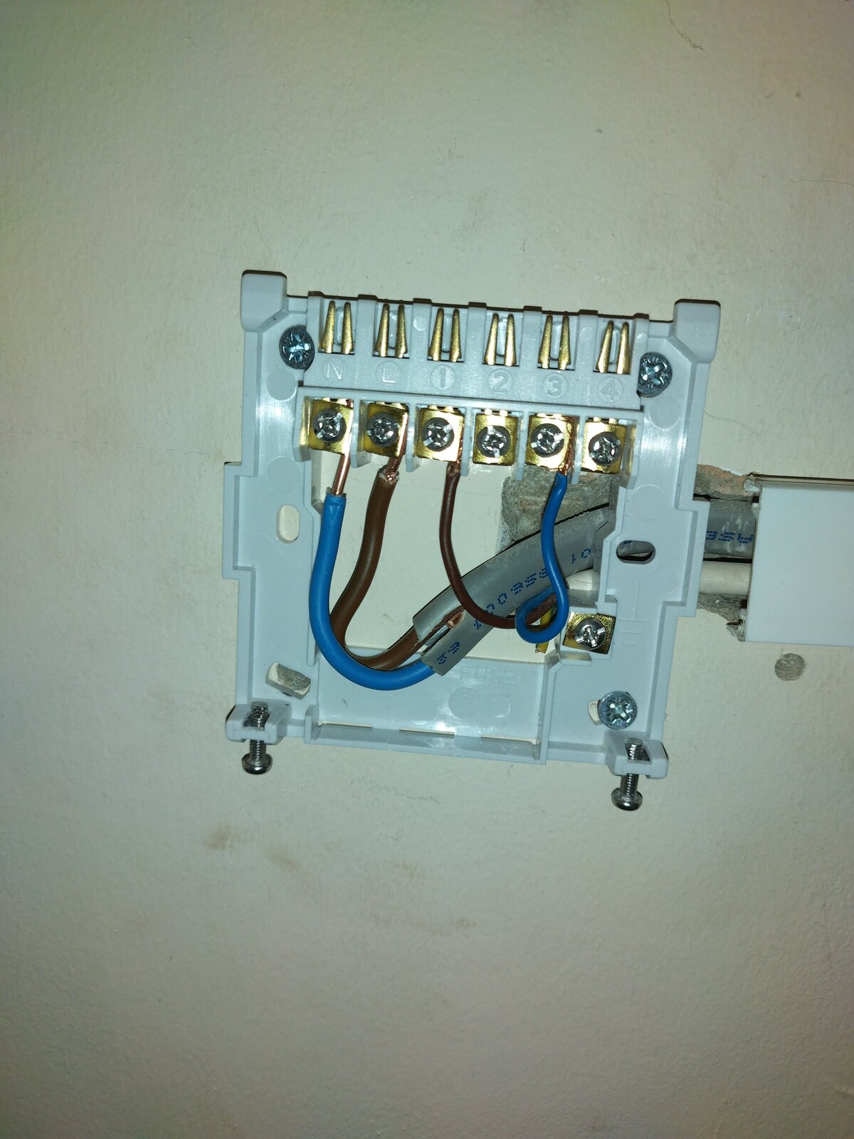

Fitted hive to grant vortex pro boiler. Everything worked fine for an hour or so. Then later found that the boiler had stopped working and the power light is dimly flashing. Checked wiring and it has live and neutral from the spur and 1 and 3 goes to the same ports on the boiler that the old thermostat went to. I believe the light points to a blown PCB but would anything done with the hive cause this or is it just a coincidence that it blew shortly after installing.
Before concluding that it’s the pcb, check wiring and voltage, could be a loose connection or crimped on insulation. If it were crossed wires, it would usually point to a dead short and would have gone instantly (usually ime).
Post some photos of the wiring.
live and neutral are a spur taken from boiler socket. 1 and 3 are the old wires from the old thermostat and remain in the
exactly as they were in the boiler as per instructions I found online.
Quite a bit of copper on show, although probably not enough to arc and trip.
I know I was going to shorten it today. Just wanted to see if it worked. Can you see any other potential issues.
