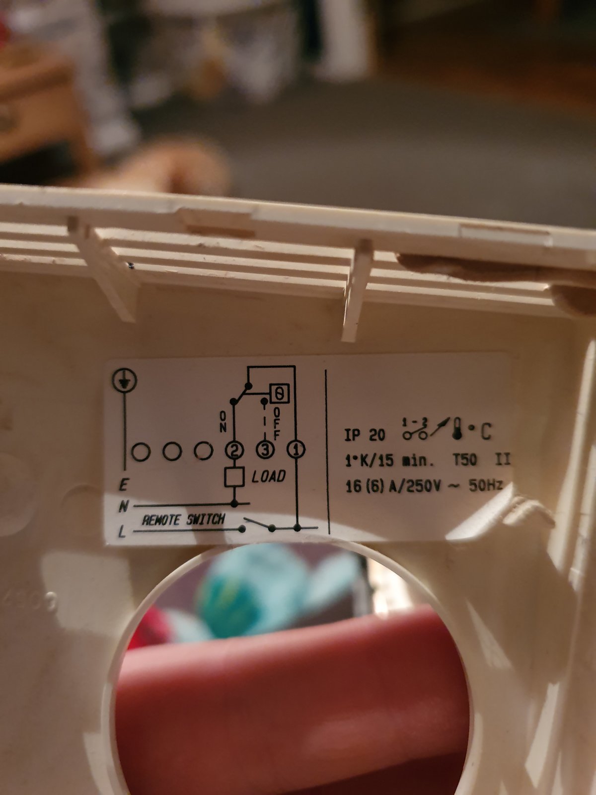

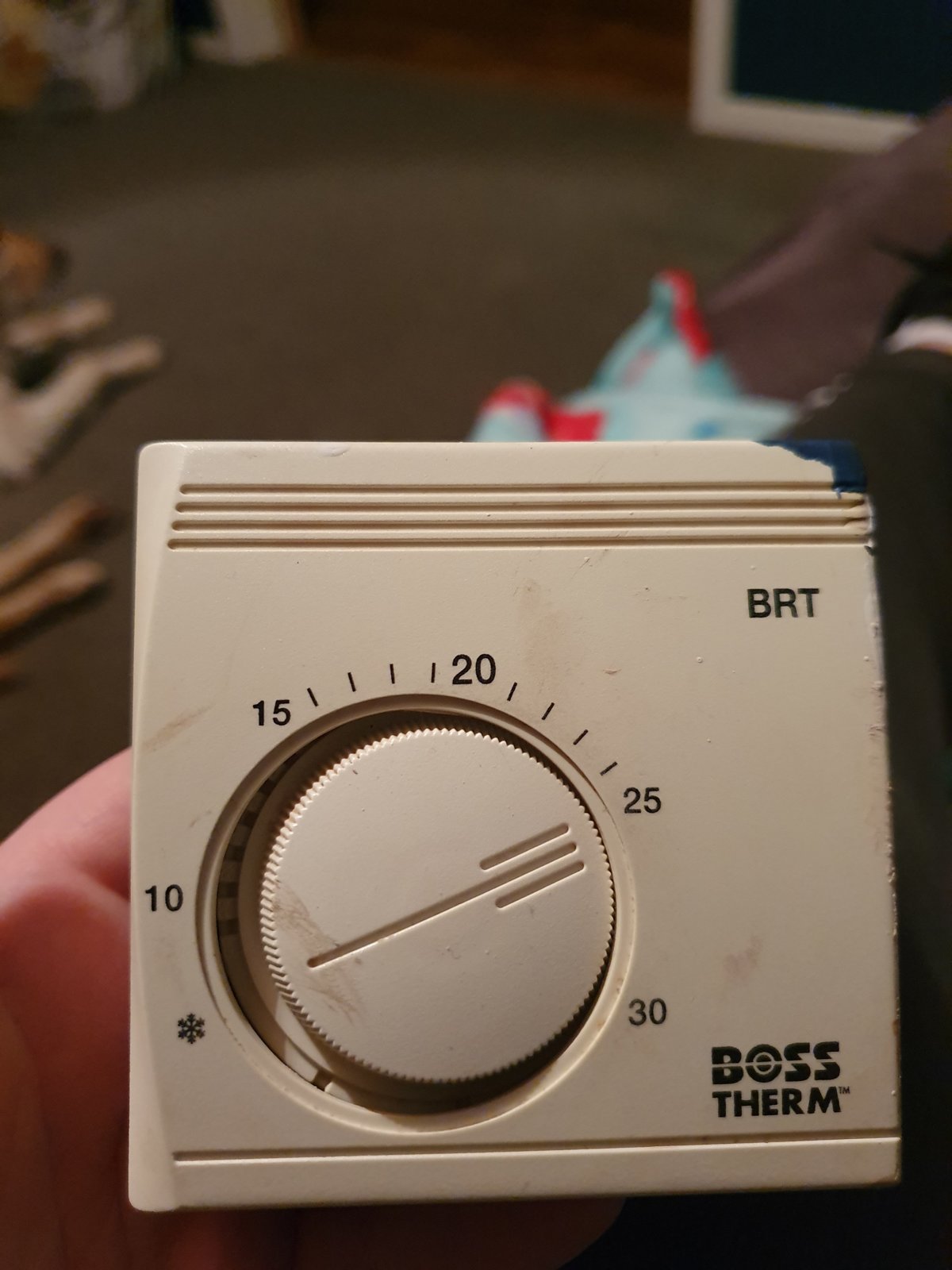

Please could someone help me ...
I have only 3 wires coming out of my thermostat... reading 240 volts from the live
I've tried connecting a few ways and still not working ...
I will post an image below of old thermostat
site rules prohibit Hi-jacking old posts for good reason, the advice you require is different so if you want the correct answer you will have to start your own post and say which boiler you have and what you are trying to connect
