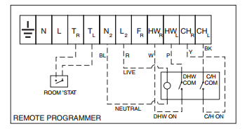

Have you put a link in between Tr and Tl as shown in the wiring diagram.
Also you don't need the connections to 1 and 2 on the Hive.

Tr and Tl have been looped.
I have connected 1 and 2 on the hive but I guess I can disconnect them for the purpose of your suggestion but I can't see why that would make a difference?
Hey guys, after further investigation it turns out I have a faulty hive receiver so I've had to order a replacement through British Gas :(
The CH channel is not producing a signal when it command has been triggered - the led lights up and you can hear the relay click but thats it, to trigger output.
Thank goodness I came across this forum as according to British Gas, there was a problem with the boiler and they wanted £100 to send an engineer to visit but with a little help and perseverance I was able to diagnose the fault myself. Guess I got what I deserved buying second hand goods from eBay lol.

if you look at the boilers manual it states that only voltage free connections should be used for the room Thermostat so the twin channel hive is not suitable for this

It is true that the manual states volt-free contacts should be used so the Hive might not be compatible.
However, there is nothing to suggest that the controls are not 240V and as Lloyd has operated the DHW with 240V and not damaged the PCB I think we can assume that they are 240V.
Lloyd:
The original link in your OP is clearly WRONG
The manual shows this to be the required way to wire the controls
You will see that HWL and CHL apply voltage to the programmer switches and when HW or CH are called for by the programmer voltage is applied to HWR and/or CHR to turn on the boiler.
As you have done, just applying voltage to HWR and/or CHR will operate the boiler (albeit the CH part of your Hive is faulty).
BUT whether the boiler might switch off the volage to HWL or CHL (switching off the boiler while the programmer is still calling - which would not happen while using the Hive as you have done) for some safety reason, I do not know.
You would have to ask Potterton about this.

Extract from the Potterton Powermax HE manual:
"The integral programmer can be replaced by one sited away from the boiler if required. It is recommended that it should be of a type having volt free contacts. Wiring connections are indicated in Fig. 25, Page 36. When using an external programmer, the integral programmer must be disabled, see Fig. 13."
