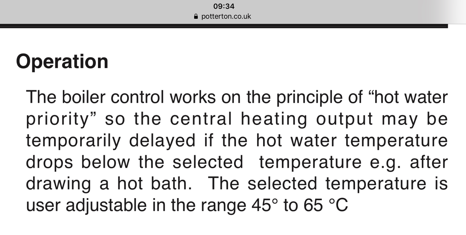

Hive installation on Potterton Promax HE Store
Having looked at the instructions, it incorporates a store for hot water, So you would need the hot water set to on to have hot water delivery. Although it’s a combi, it doesn’t mention running a tap to get hot water?
I think the only thing I need to do is rewire as it was originally but then feed the 2 wires from wired thermostat to Hive and supply power to hive. Every other change seems unnecessary?
