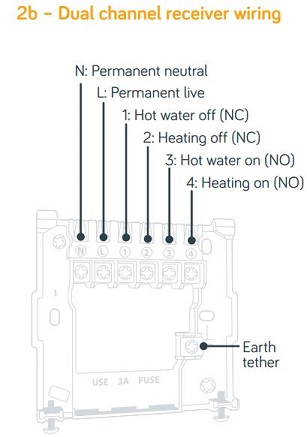

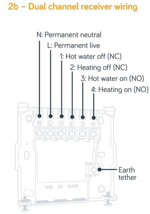

You exchange the Drayton LP for the Hive (you need the dual channel version)
As you can see from the diagrams below, the terminals are exactly the same. So a straight swap. Lucky you (y)
Drayton Programmer
lp522-jpg.152582
Your heating system dictates what wires are required, so don't worry that not all of the terminals have wires connected, that will depend upon the type of system you have. If there isn't a wire there now you won't need it with the Hive either. I've never yet seen a programmer in the UK that has a connection to Central Heating OFF. So it's the norm, and not unusual at all.

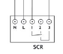

Once the Hive is installed, the old room thermostat needs to be decommissioned. It can't just be disconnected as the wiring would be left 'open circuit' and the heating will not operate. So the live switching wires need to be permanently connected together to complete the circuit.
The easiest way is to leave the receiver and wiring in place and add a link between terminals 1 and 3 so that they are electrically connected. [Your BG thermostat receiver is actually a re-badged Drayton SCR]
If you want to remove the redundant receiver completely instead, then post back a photo of its internal wiring connections and I will tell you how to do it.
aa-jpg.185378
The front and back of the receiver, and the wiring behind it looks thus
So for option 1 (leave receiver in place), I just link together the brown and blue wires in slot 1 and 3 respectively using a connector like this? Do you know what current rating I need?
https://www.screwfix.com/p/3a-terminal-strips-pack-of-10/25545
And put the receiver casing back over the top and forget about it?
I would probably prefer to remove it completely but I suppose it's one less thing to go wrong if I change as little as possible.
For the old thermostat on the wall, I'll just be able to throw that away for good with the wiring now completed I imagine. That'll be nice!

Well done sounds as if you have sorted it. The SCR (Receiver box) is still powered up so the lights will be on, but it won't have any control of the heating anymore.
If you want to remove it then you can, but the way yours has been installed it is also serving as a junction box. (ie having two wires in each of the N and L terminals) which is why I asked for a photo before advising how to do it.
You could remove it and replace it with a junction box as follows:
1) Put both blue wires now in N into a single terminal in the JB so they remain connected together
2) Put both brown wires now in L into a single terminal in the JB so they remain connected together
3) Put the brown and blue wires in 1 and 3 into a single terminal in the JB so they are directly connected together
