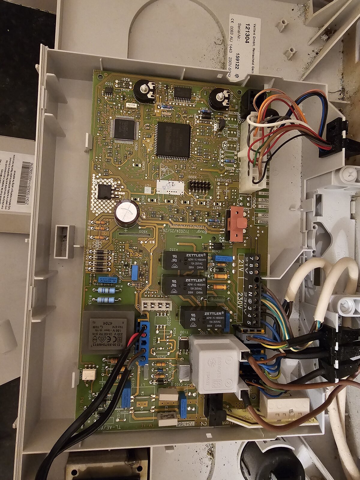

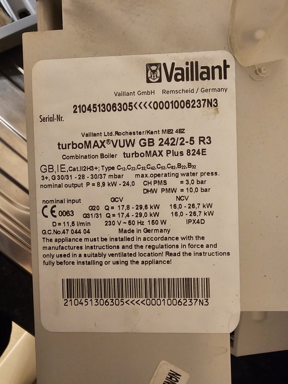

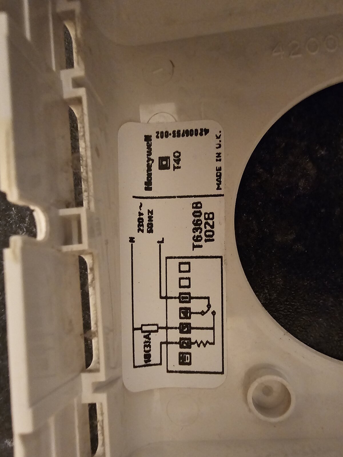

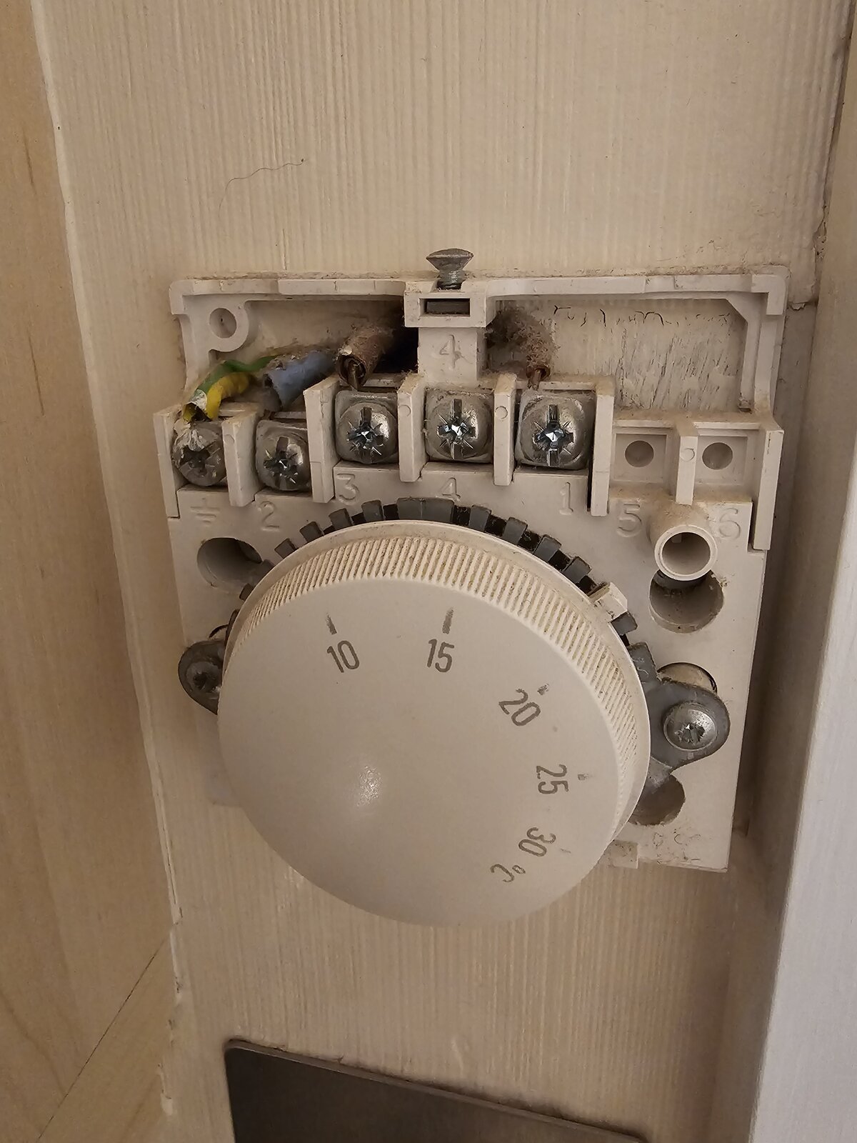

Hi,
First post im hoping you can provide some advice on the installation of a hive mini thermostat.
Before i continue i purchased a dual channel reciever but i have a combi boiler, i read that i only needed single for a combo, as I've thrown the box away can I still install?
Id like to put the reciever where the exsisting thermostat is, can anyone tell me what i need to wire where and do i need to do any wiring boiler side?
ive attached pics of everything if anyone can give me wiring guides / steps i need to take id be most grateful.
thank you!

Hello, this should work for you, Honeywell to Hive:
1 to L
2 to N
3 to heating on/NO
Earth to earth
That wont work Chris
