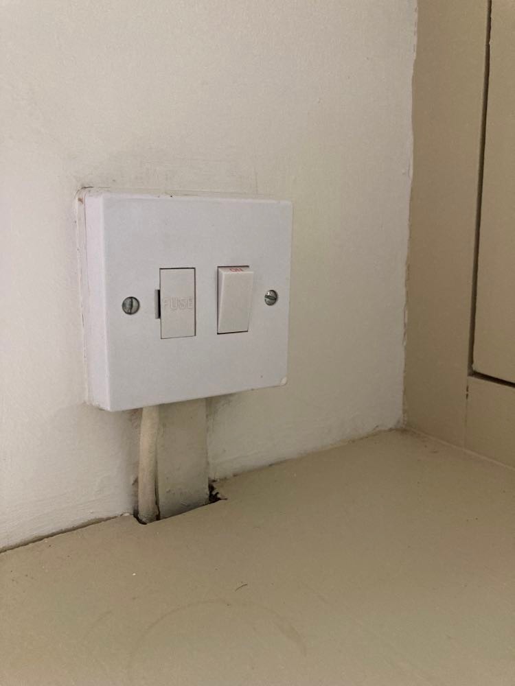

Can you see the cables coming from the FCU or the one going to the receiver?

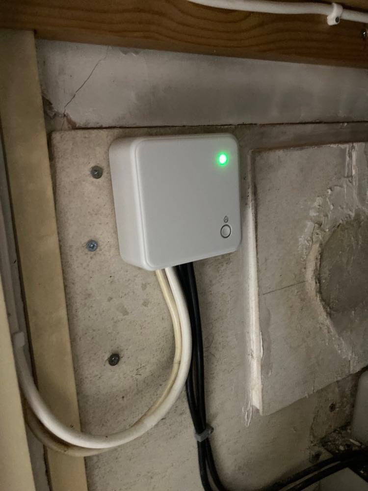

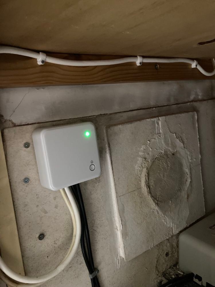

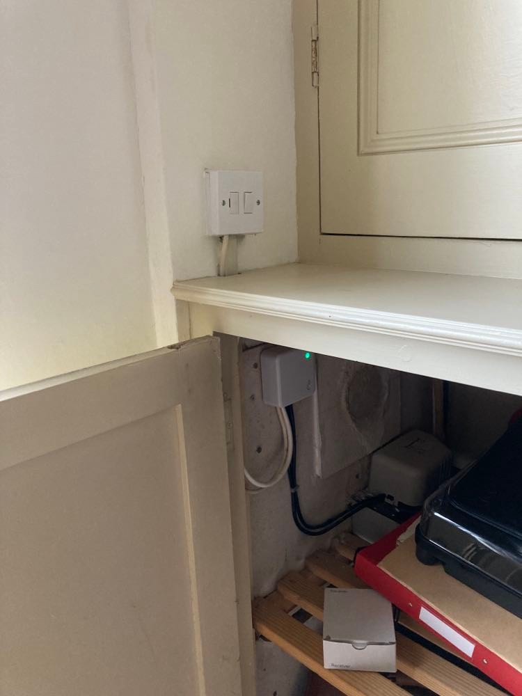

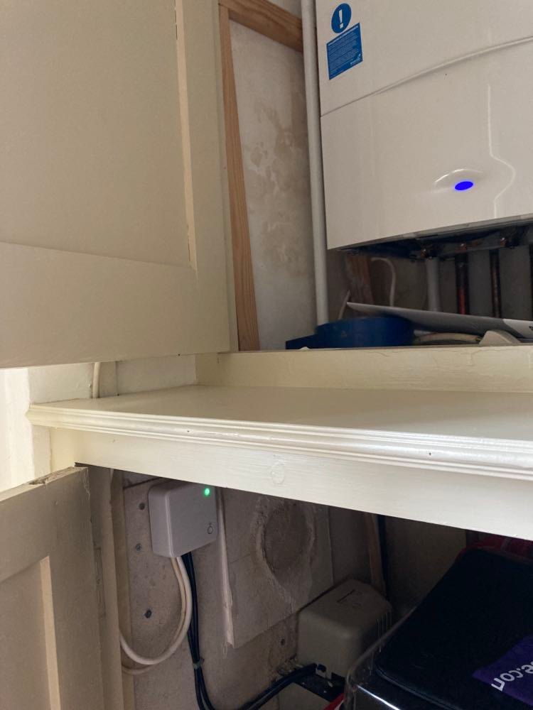

As you can see from photos, it's all working at the moment, but it has gone off twice today already.

Intermittent short from a single strand of wire or two??? - there's a good few wires going into that little hive receiver.
OP, do you feel confident enough to turn the fcu off and show us the wiring behind the receiver?
Not asbestos, it's mdf/chipboard. Yes it's the hole where the flue from the old boiler used to be, when BG fitted the new boiler 4 years ago (along with the hive), they had to move the flue slightly higher.
Did paul daniels fit it? in your pics wiring for a condensation pump has suddenly appeared by magic ? when was that wired into the hive receiver? I would put money on it that is your problem, it shouldnt be wired in there
British Gas, it was all fitted 4 years ago at the same time, worked fine for the last four years. I did mention to engineer last week, that it might be something to do with that. It always makes a strange glug sound when I manage to turn hive on again (the boiler/condenser makes the glug sound, not the hive). But he said no, that didn't have anything to do with it.
I will guarentee you it is that, I have no idea how they got so many wires in there , the hive receiver terminals are tiny, I guarentee you what is happening is when the condensate, sump fills and the flow switch is activated then the power to the hive is cut, if you can see a way of manually poring water into the condensate pump, some have little caps on the top of the body , or some other way , pour water into the pump till it activates and see if the hive light goes out when it does, my bet is the supply to the hive is interrupted by the pump alarm and the pump outlet hose has a kink or partiall blockage somewhere
Thanks Ian, I will pass this onto the engineer on Tuesday, and let you know what the outcome is. Any idea why this would suddenly start happening, when it's been trouble free for all these years?
As above, the pump has 2 cables as you can see, one is power to the pump , this is float activated, when the condensate gets to a certain level , the pump activates for about 5-10 seconds to pump the condensate out, the 2nd cable is the failure alarm, if the pump fails and the condensate goes higher than the level of the float the alarm breaks either the power to the boiler, or the switched live to the boiler, so no more condensate can be produced causing the pump to over flow, bet you some idiot has wired the pump alarm into the permanent live on the Hive and the outlet hose has a kink or partial blockage somewhere and hence why the power keeps going off at the hive, should never be wired into there
