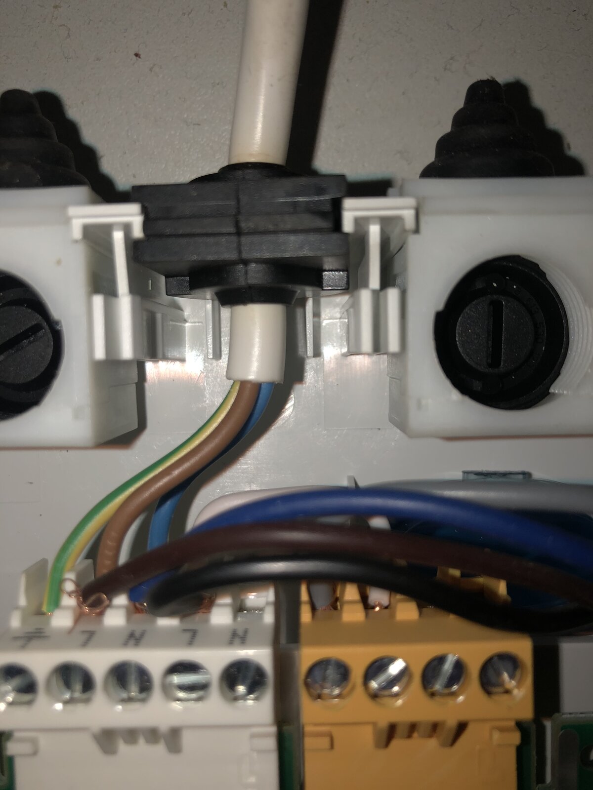

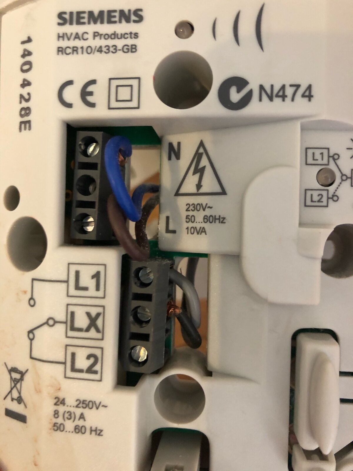

Old Siemens reciever https://i.imgur.com/5nzTFkW.jpg

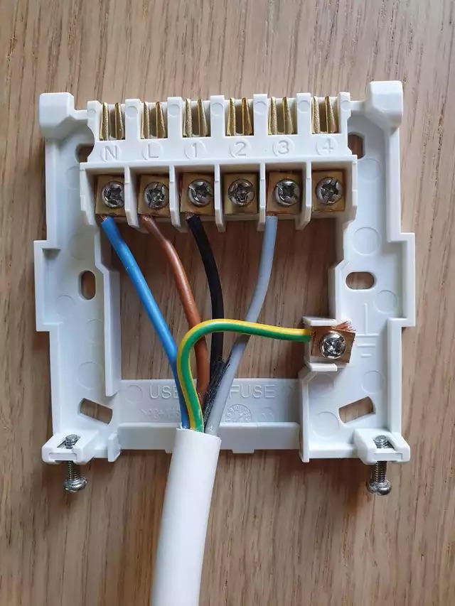

New Hive https://i.imgur.com/lqLys57.jpg
I wired this up yesterday but no lights came on at all, checked the wiring and it all looks fine, figured it was a faulty receiver but not sure.
One thing I'm thinking is that I know the siemens receiver doesn't have polarity so is it possible that L1 and LX are wired the wrong way - not an issue, but when I wired the hive this assumption blew the circuit board because it was backwards? Does this make sense?

Siemens L1 and LX and Hive 1 & 3 are just an on / off switch. In both cases the terminals are electrically connected together when the device switches 'on' So, from a functional point of view, it doesn't matter which way around the wires go. However, convention says that LX and Common (terminal 1) would correspond, which is what you have done.
As the wiring looks right to me, here are some suggestions:
1. Make sure that you have the correct version of the Hive receiver. You should have the 'single channel version' with only one button and light at the bottom marked "Central Heating".
2. Is there a timeswitch or programmer somewhere that controls the heating? If so that should be set to be permanently 'on' 24/7 otherwise when it is 'off' it will switch the Hive 'off' also. Separate time control isn't required as the Hive provides time and temperature control in the one unit.

Some installations require a link inserting between terminals L and 1. Yours doesn't, but if you tried that configuration at some point it might have caused some damage and perhaps blown a fuse somewhere. Is that a possibility?

Hi me again, just checked the wiring to the boiler (see attachments at bottom of thread) and it seems like my Live wires might be the wrong way round - should I swap L and 1 connections on the hive?
L in from boiler (brown) to L on hive
N in from boiler (blue) to N on hive
L out from boiler (black) to 1 on hive
Heating ON boiler (grey) to 3 on hive
Thanks again for your help.

The connections are as I would expect for a boiler wired for 230V control. The two L terminals at the boiler are connected together (so are effectively the same terminal) It doesn't matter which one you use.
The brown wire is live
The blue wire is neutral
The back wire is the live supply to the switch (which does stick to convention (y) & is connected to common 1)
The grey wire (not shown in your photo) will be the switched live to fire up the boiler
The bottom line is that you are swapping one device that requires a 230V supply and has a voltage free switch for an identical device (from a wiring point of view) that also requires a 230V supply and has a voltage free switch.
So if the Siemens worked OK there is no need to change anything. Think of it like changing a light bulb, one out, one in.
However, my big concern is the bad connections with wire whiskers poking out. That is well dangerous and needs sorting.
Do you mean the brown live wires, I'll tidy that up and make sure to mention it to the gas safety engineer when he comes round next time to do whatever he does to give me my certificate.
Thanks!
You got it. That stray strand is close to the earth terminal.
Perhaps I should mention that with some boilers to access the wiring terminals it is necessary to open up a room sealed compartment to get to them. If yours is like that only a RGI (Gas safe) engineer should open it so that the appropriate safety checks can be carried out afterwards to make sure that it is properly sealed up again. I suspect your's isn't like that, but I can't say for certain.
