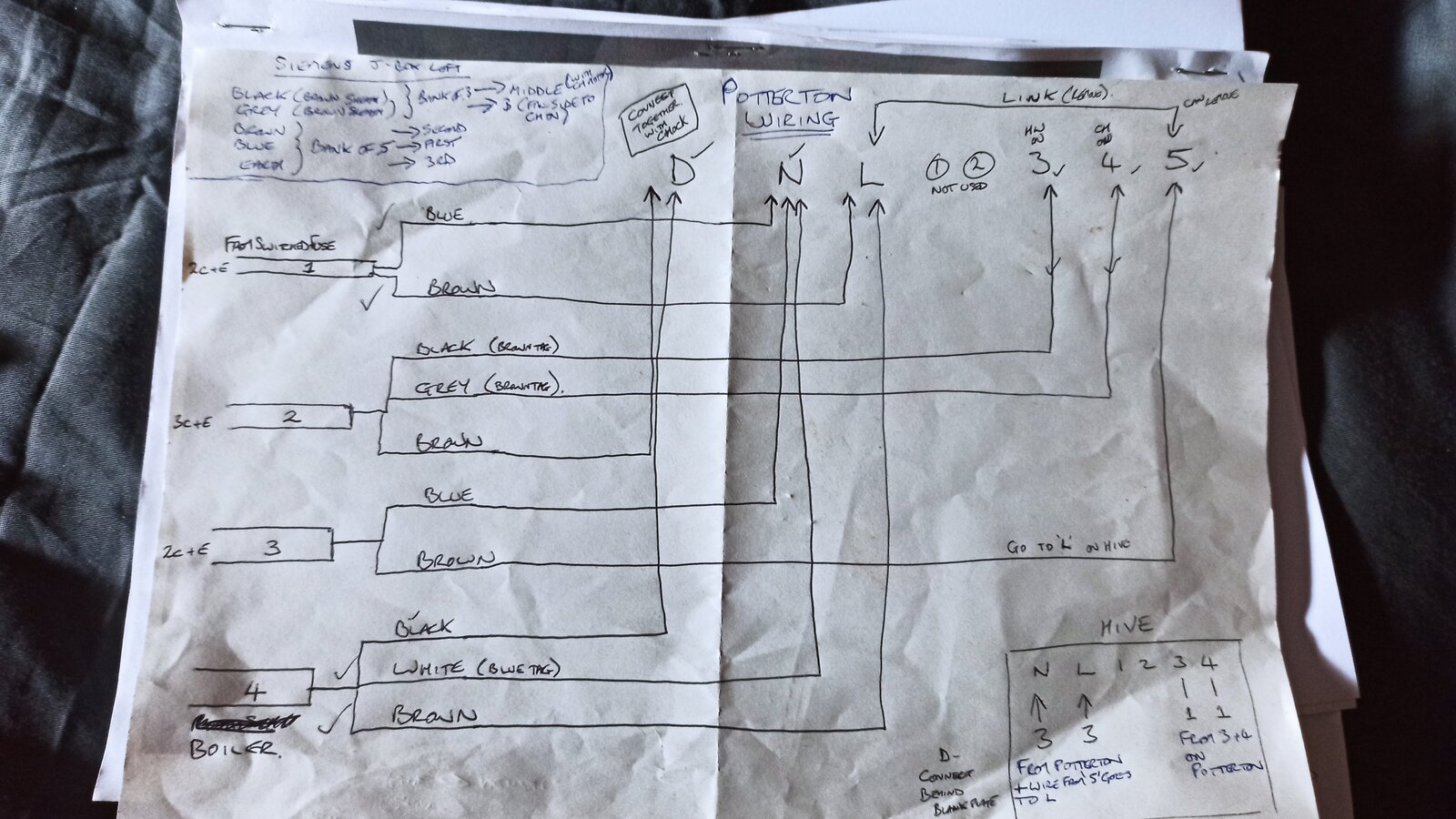

I have removed the potterton and replaced it with the hive receiver unit ( wiring diagram attached). Everything worked fine as long as I turned up the Siemens roomstat to max.

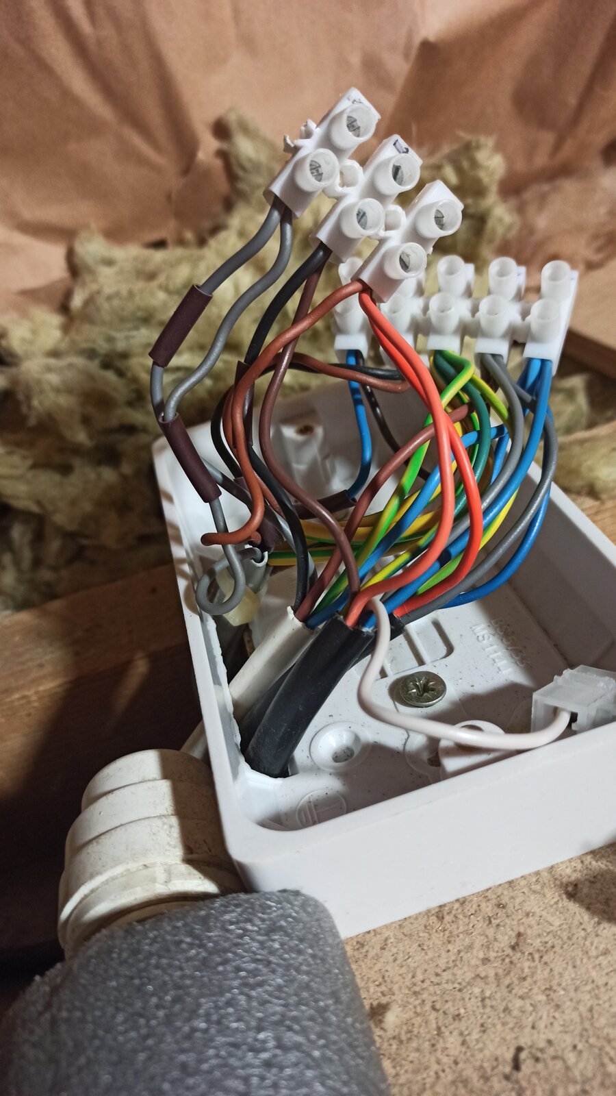

I have located the wire from the receiver unit to the "wiring centre" ( photo attached) which is White 4 core and earth, and removed it, but now the boiler doesn't fire up when the hive receiver is calling for heat for central heating.
I assume from reading about other thermostats that I may need to put a link in somewhere - but where?
The 4 cores from the Siemens are -
Black (has brown sheath) - connected to terminal along with wire from CH valve
Grey (has brown sheath) - connected to terminal along with a wire going to CH on in the hive receiver.
Blue and brown I assume are neutral and live.
Do I just put a link in between where the black and grey wires were?

Whichever the 2 switching wires were at receiver end (L and Lx) these need to be joined together or wired so that ch on corresponds to the switch live for the thermostat.
Many thanks CBW
The black and grey wires went to L and LX, so can I just put a link in between the 2 terminals at the wiring centre which these 2 wires were removed from? ( Ch on to programmer and Ch motorised valve) or can I just put both those wires into the same terminal?
