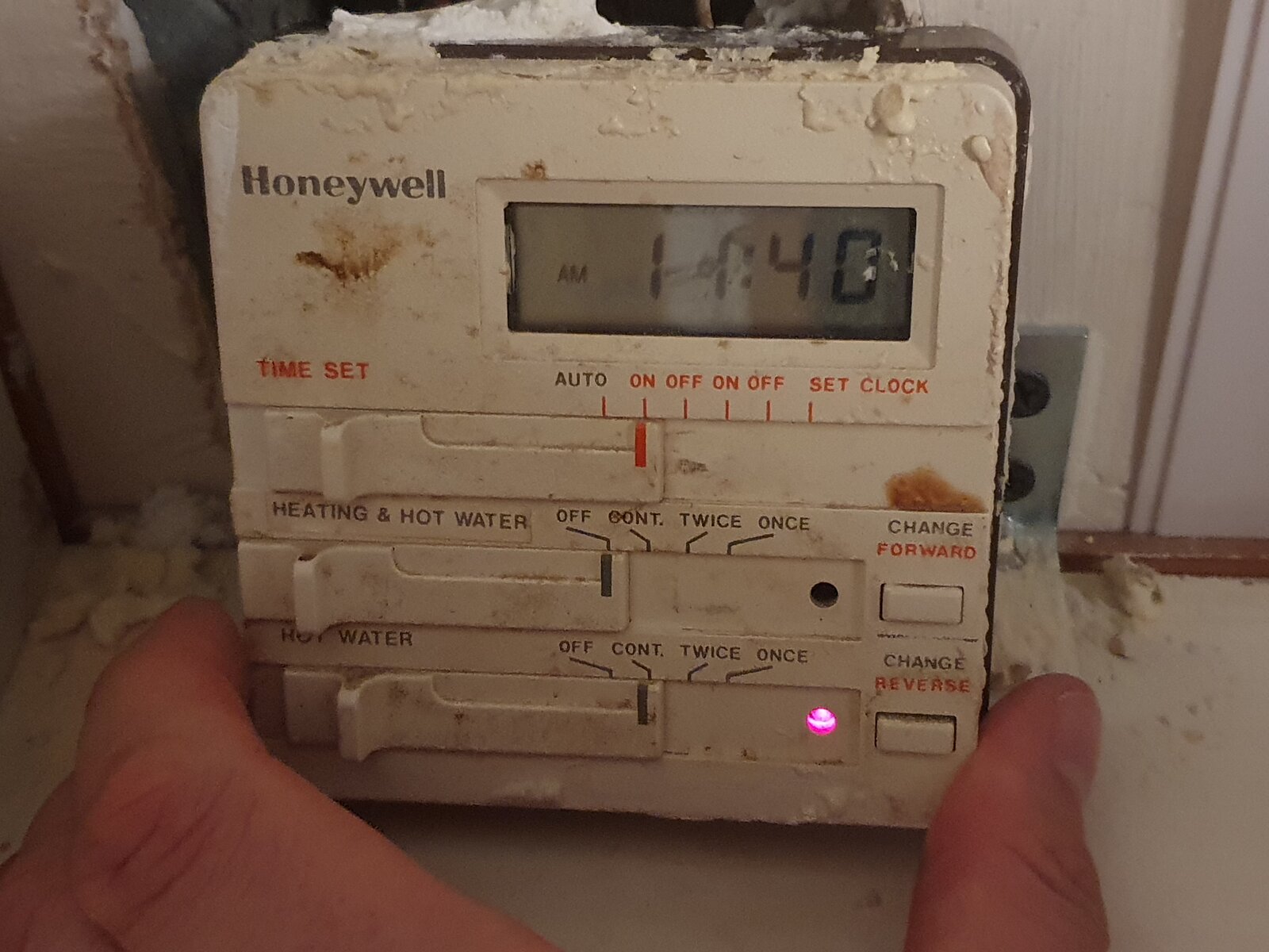

I have ordered my partner a HIVE thermostat to replace her old tired one. I have tried to get someone in to install it for her, but they have come back with rather high quotes, which I'm assuming is because of Covid.
Thanks to the kind people here at the beginning of the year, I was able to fit my Central heating HIVE with ease. Therefore I was hoping someone could offer the same assistance.
The old thermostat is

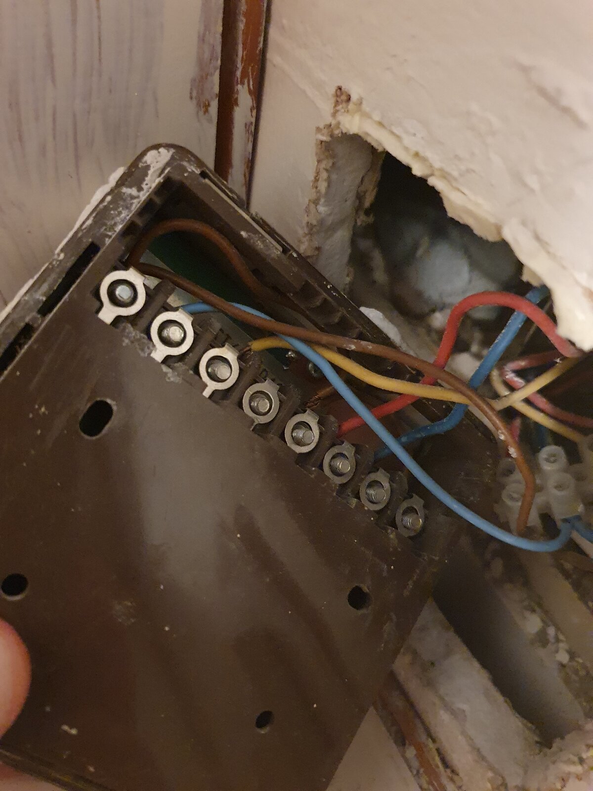

The wires on the back of the old thermostat are:
a>
I would really like to be able to do this for my partner as she has, been through a lot this year and it will really help her out.

The Honeywell ST699 or ST799 shown in your photo is a programmer and not a thermostat.
You will need a dual channel version of the Hive to replace it and all of the existing wires are transferred from the terminals of the Honeywell as below....
...to the terminals of the dual channel Hive that have exactly the same functions. So N goes N, L to L, Hot water on, to Hot water on etc...

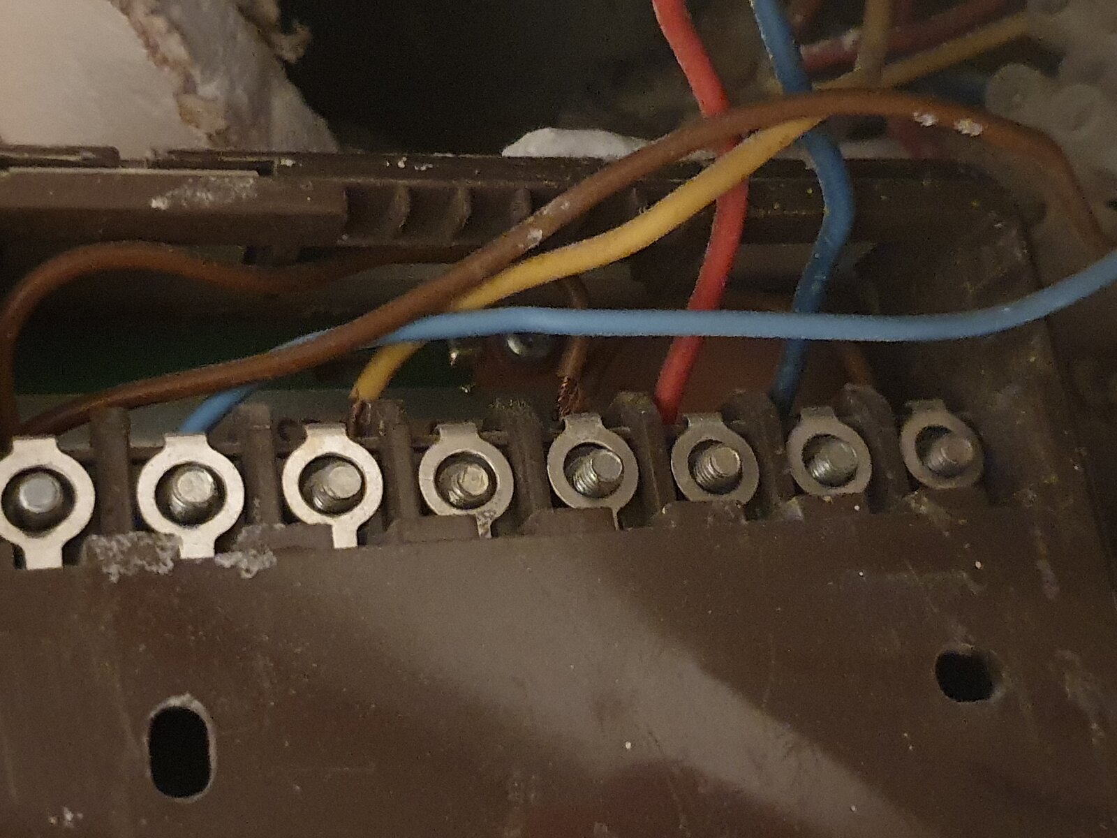

I have studied the diagrams that you have provided. Looking at the existing wiring, I can see neutral (blue R2/N) and CH on (Red R3) but the yellow, light blue and long brown wires seem to be in the wrong places? I'm assuming this is why the timer has never worked?
I am also assuming the long brown wire is the permanent live, therefore, that leaves the light blue and yellow wires? It looks like one wire is missing?
Don't get hung up on the wiring colours, they would have been selected by the original installer according to their preferences. It's what the wires are connected to at each end that determines what they do, not the colour of their insulation.
Why it doesn't work now maybe because the programmer itself is faulty or there is a fault elsewhere, but there are wires at the programmer exactly where I would expect to see them (The wiring indicates that it is a Y-Plan system with a 3-Port motorised valve, so you can ignore my earlier comment about gravity circulation of hot water)
You will only need the wires that are already there, and like I said before, they simply transfer from the Honeywell terminals to the Hive terminals that have exactly the same function. So after you have discarded the brown links between L, 5 & 8 as per @ianmcd
  • Honeywell L = Hive L (Brown wire)
  • Honeywell N = Hive N (Blue wire)
  • Honeywell 3 CH ON = Hive Heating on 4 (Yellow wire)
  • Honeywell 6 HW ON = Hive hot water on 3 (Red wire)
  • Honeywell 7 HW OFF = Hive hot water off 1 (Blue wire being used as a live wire and should have a brown sleeve over it to show this)
