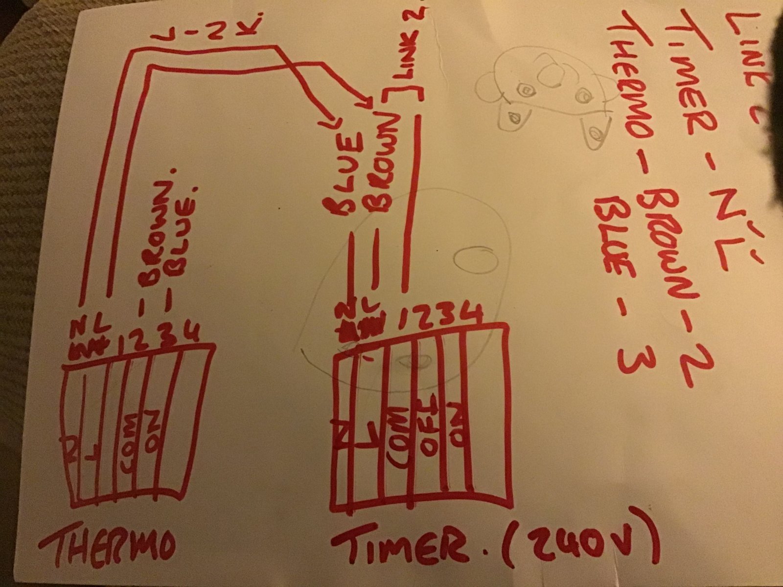

Apologies Gentlemen

First of all ericmark is correct, you should really have started your own new thread Hi-lacking someone else's is against the forum rules. Don't start a new one now otherwise you will have duplicate threads going and that is also against the rules. Anyway, back to your question.

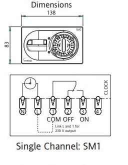

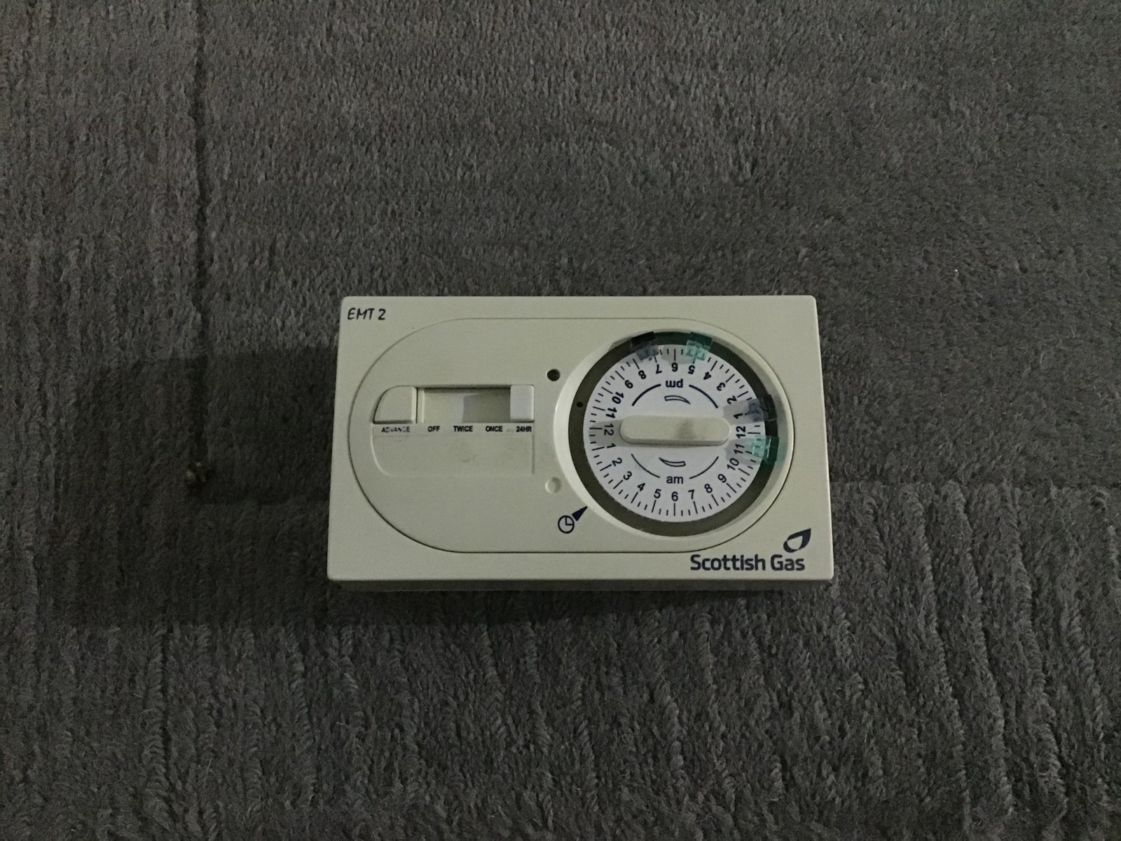

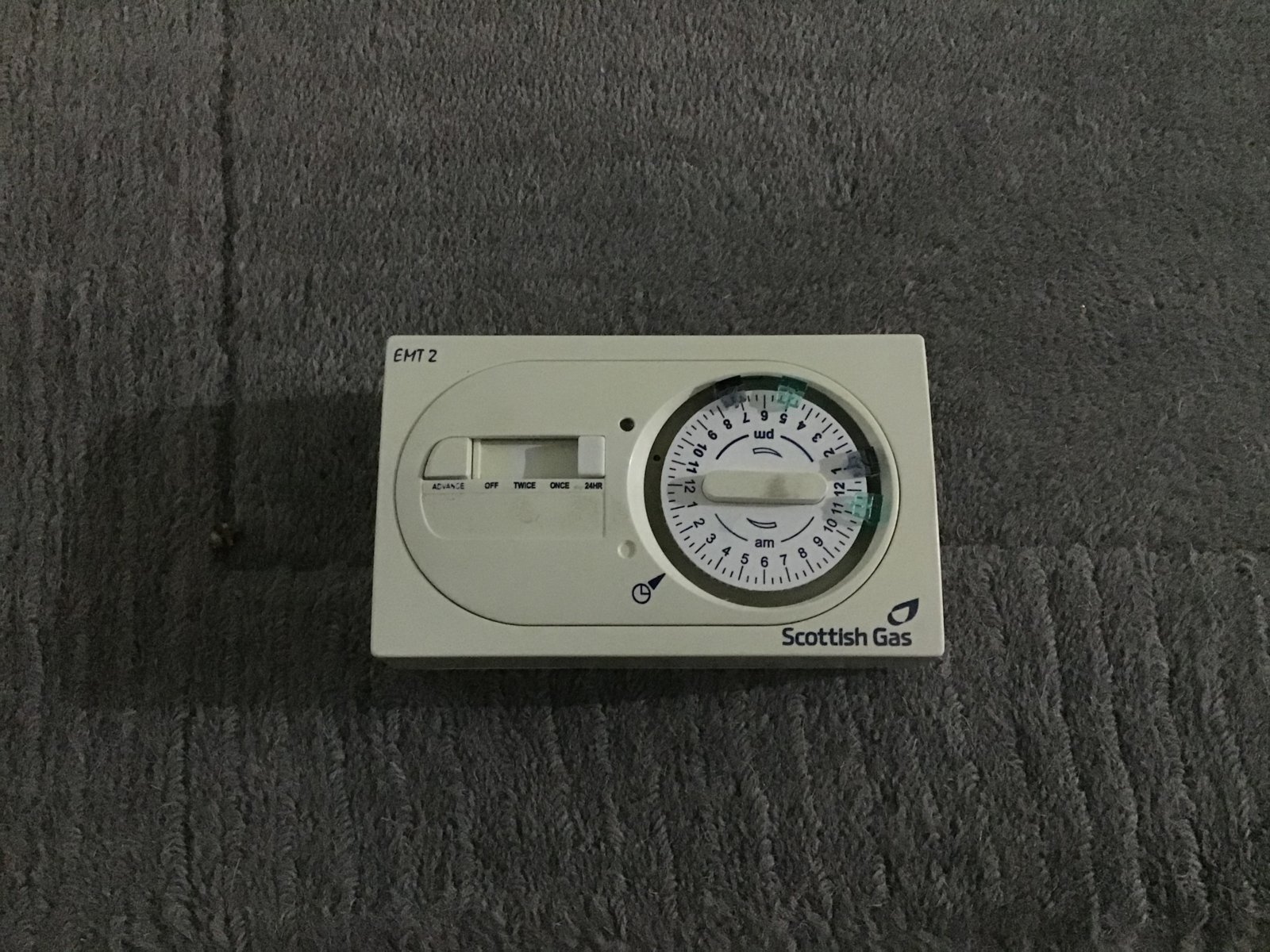

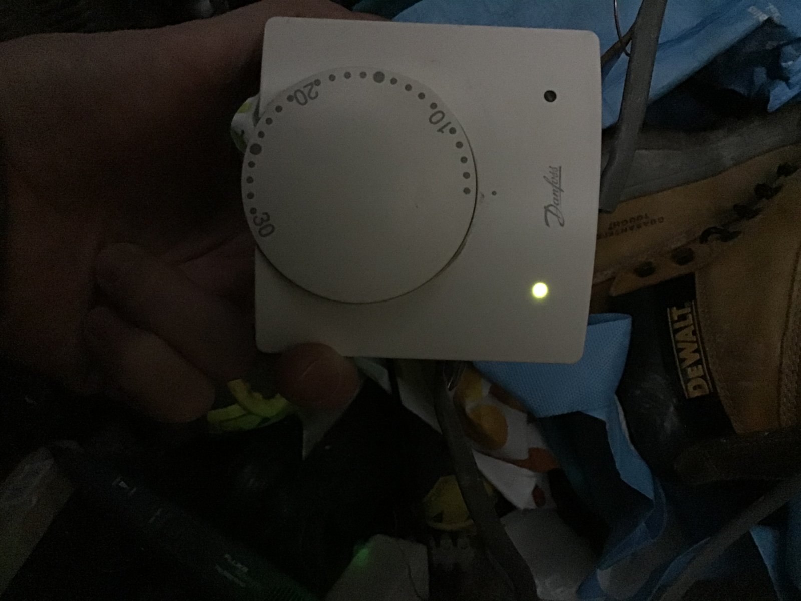

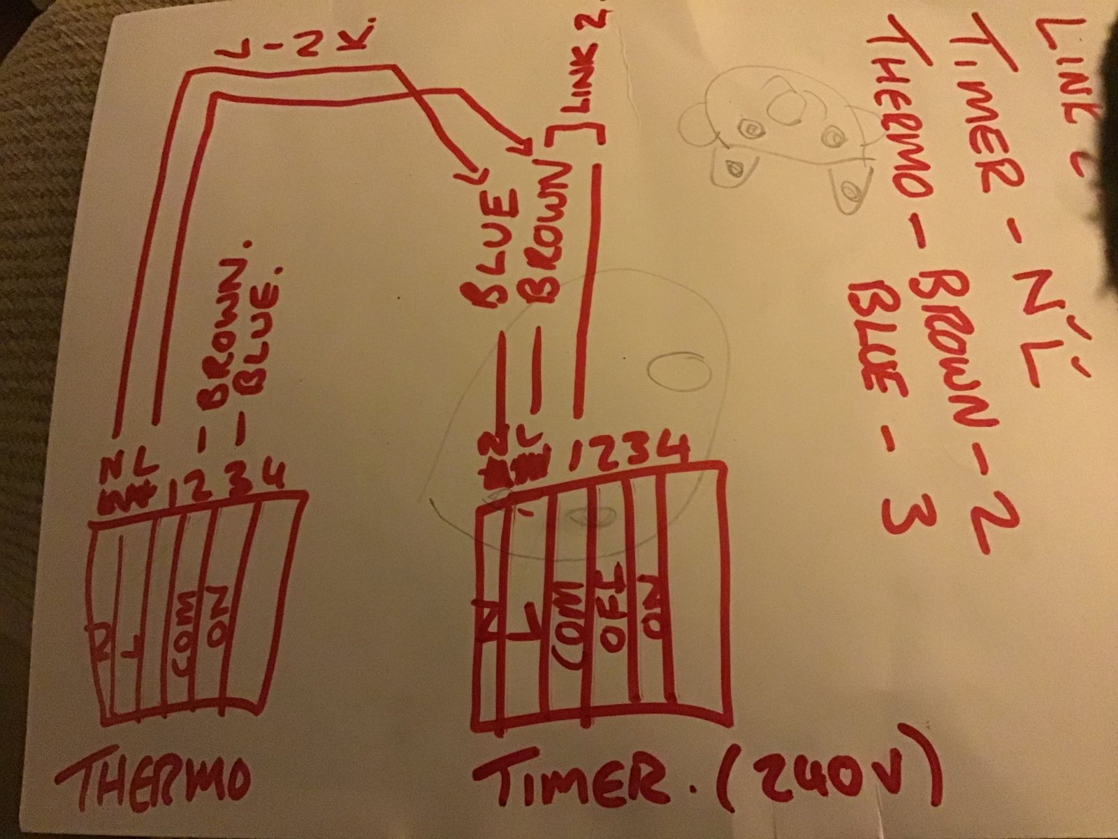

The timeswitch is actually a Drayton SM1 rebadged as a Scottish Gas EMT2. You don't tell us what it is controlling, so as you are trying to replace it with a single channel Hive, I will assume you have a combi boiler and the timeswitch is only for central heating and that you don't have a hot water cylinder attached to it. [If you do have a hot water cylinder attached to the boiler then you will need the Dual Channel Hive to control the water heating.]
The wiring for the existing timeswitch is as per the diagram below.....
....and as you can see, the Hive Single Channel Version is exactly the same, so they are a straight swap over like for like. Lucky you! :)

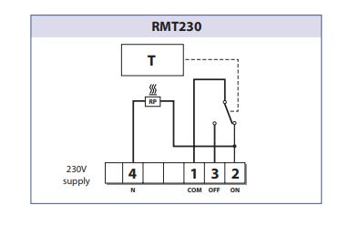

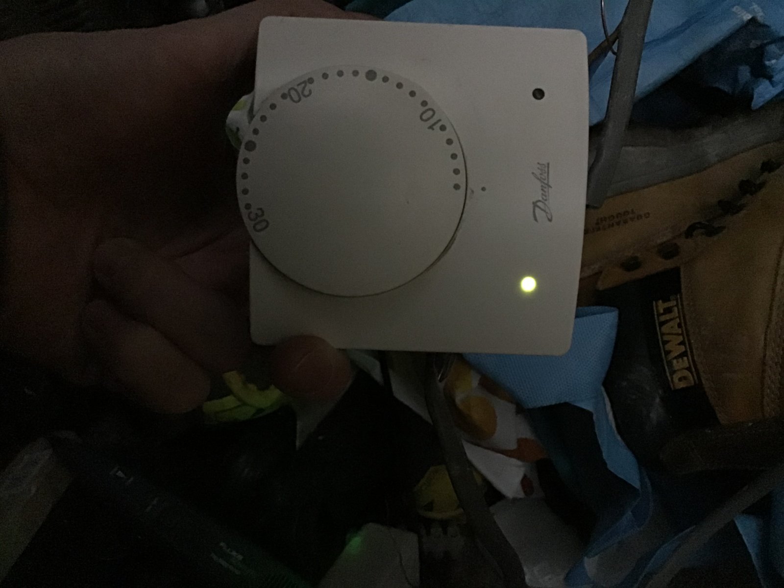

The only other thing that you need to do is to decommission the room thermostat which looks to me like a Danfoss RMT 230. [If it's another model don't proceed and post back details of it] The RMT 230 wiring is:
You now have some options.
1) Either leave the thermostat and its wiring in place and simply add a wire between terminals 1 & 2, so that they are connected together. Or...
2) Disconnect the wires from the terminals of the thermostat and put them into a junction box. The Neutral wire from terminal 4 should be isolated, but the two wires in terminals 1 and 3 should be connected together. Or...
3) The professional way of doing it would be to trace the cable from the old thermostat back to its origin, firstly make a note of where the wires are connected, then disconnect the cable then join together the two terminals where the wires that went to the thermostat terminals 1 and 2 have just been removed from together.
