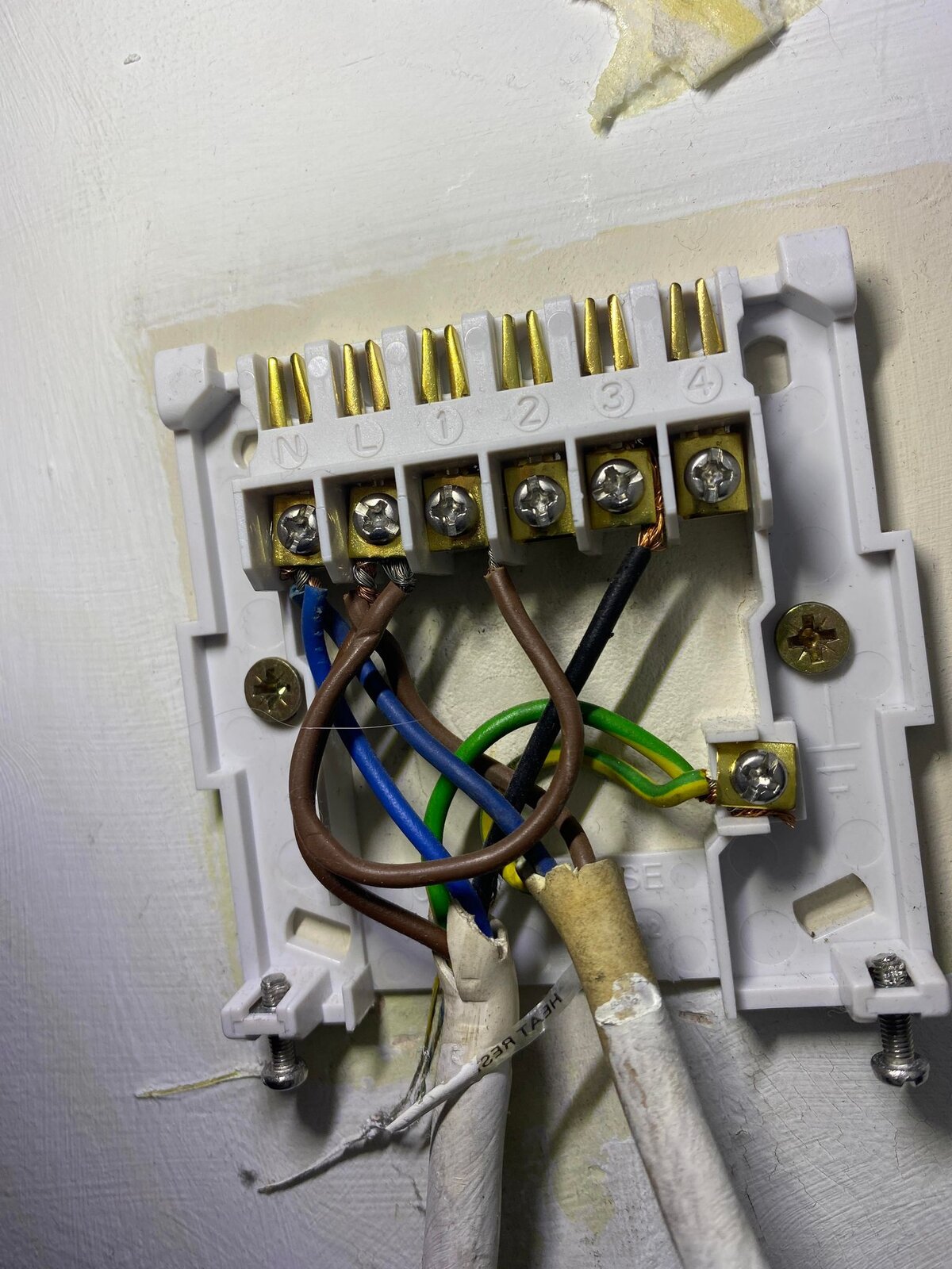

Evening All.
Earlier this year the Controller/Timer packed in (Honeywell?) on our Combi Boiler.
I replaced it with a Hive Wireless controller.
Thinking back, I dont think i ever tested the heating when i fitted it since the hot water worked perfectly fine,
but turning the heating on this morning didn't work, The controller shows the heating as "on". But the heating is physically not working and i cannot figure out why. Both the old wiring panel and the hive panel had 6 poles with the same markings so i wired the hive into the same poles.
Some searching found some others with similar issues regarding the thermostat for the boiler. We do not have an external thermostat so can only assume theres one inside the boiler.
The heating has always been either "on or off".
1&3 are the correct wiring, show a pic of what they are connected to at the other end, is it definately a single channel hive and not a dual channel hive ?
Yes, Single. We do not have separate control for the water.
It could be a red herring, in that the Hive is fine and the fault is elsewhere.

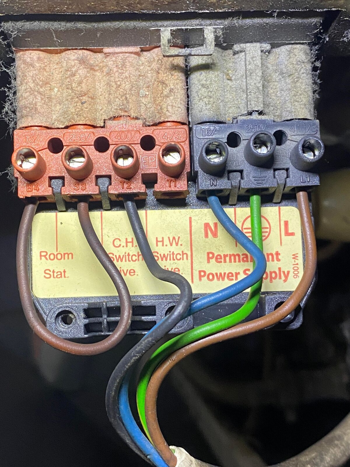

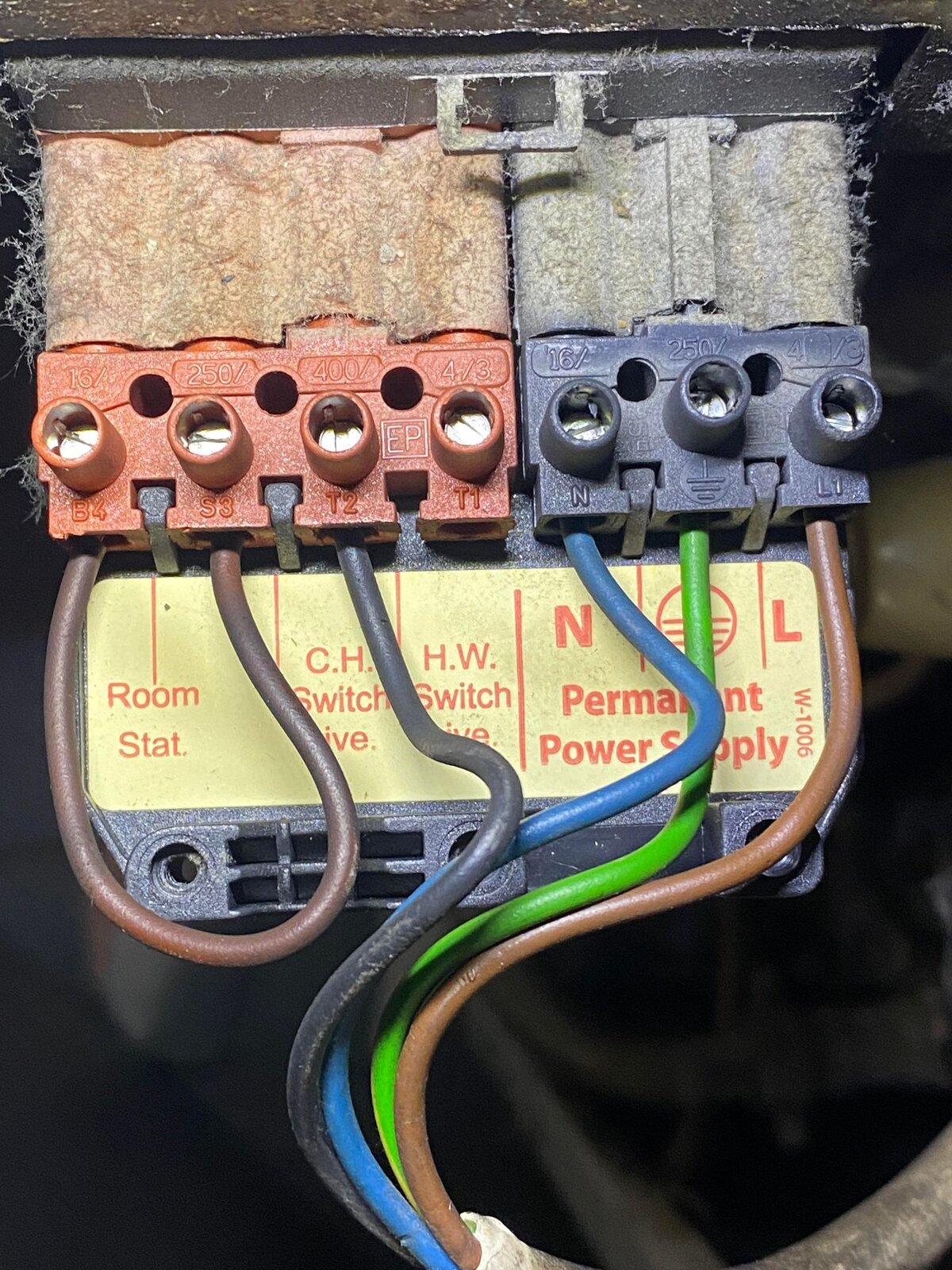

This is the other end of the cable into the boiler.
in this pic remove the link at room thermostat, one terminal to 1 on hive the other to 3 on hive doesnt matter which way round, remove the link you made between 1&L on hive , make no links and remove wherever you have wired the hive into already , N&L remain the same
So just to clarify, Move the links both ends?
(These links were present when i removed the old Honeywell unit)
I Removed the links at the plug at the boiler end and removed the link in the HIVE wiring on the wall. Heating still not wanting to play. Hot water works fine still.

If you haven't changed anything at the boiler end when you installed Hive and assuming it worked with the previous controls, put the wiring back as it originally was when the old thermostat was installed. What happens then if you move the black wire on the Hive backplate from 3 and put it in 1 with the brown link wire already there? If it works then, the Hive is faulty.
