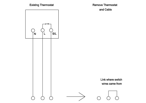

The old thermostat can't simply be disconnected as this would leave the heating wiring 'open circuit' and it would not operate, the integrity of the circuit needs to be maintained. As not all thermostats are the same, or indeed wired the same, the specific instructions vary from installation to installation. In the diagram below, I have marked the terminals Neutral / Live / Switched Live to indicate their function, but the thermostat manufacturer may have identified their terminals with sequential numbers or letters. So, whilst the steps are the same, some working out will be required in each case.
The room thermostat is just an on / off switch so when set to the highest setting will be permanently 'on'. When the thermostat is removed the switch terminals need to be bridged to achieve the same thing. It appears you are on the right lines, but something has not been done correctly.
1. Look at the wiring diagram for your make/mode of thermostat that you are removing. If you don't have the instructions for it, a diagram is usually printed inside the lid. This will show which are the two switching wires, and which is the neutral wire. (If there is a neutral present. Not all thermostats need or have one fitted)
2. Trace the cable from the thermostat back to its origin.
3. Take take a photo, or make a note of where the switching wires are connected at their origin.
4. Disconnect all of the wires going to the old thermostat and remove the cable and thermostat. All other wires to remain in place.
5. Insert a wire link between the terminals where the two switching wires have just been removed from, so that they are now electrically joined together.
If you need any further help, provide details of the make / model of the existing thermostat, or post a photo of its wires and connections internally.

If there were only two wires, then the thermostat information isn't necessary, one will be the live supply and the other the switched live. (no neutral)
Unfortunately when it comes to wiring of heating systems the colours of the wires for each function are chosen according to the personal preferences of the installer, and the materials used, sometimes blue and black wires are used as a neutral, some times as live, so it's dangerous to guess the function of a particular wire from its colour, it needs to be determined by what is connected to each end of it. Also, although there is a general method of wiring systems up again there are many variants as to where the control signals are picked up from depending upon the layout of the heating components in your home.
First of all, check the work that you have done, in that the conductors are securely in the terminals and that adjacent wires haven't been disturbed or loosened.
My next suggestion would be to put the wiring back exactly as it was, but with the two wires where the thermostat has been removed joined together. Then once the heating is working start again. You need to do this, because it would appear that you may not have identified the room thermostat cable correctly and may have disconnected another part of the wiring, if so, that will need to be reinstated first.
Once the system is working again, you may be able to identify the room thermostat wires by where they are connected. Usually one of the room thermostat wires will be connected to the live heating supply from the Hive (terminal 4 of the dual channel version) of the programmer/timer, and the other will go to the brown wire of the 3-Port motorised valve (I assume this is what you are calling a '3 Port Switch') once you have identified what you believe are the thermostat wires, note carefully where they are connected and remove them, to be sure you have the right wires they can be tested with a multimeter. The wires may not go directly from point to point, there maybe a junction box somewhere in between so their colours may even change from on end to another.
If you can't reverse what you have done and get it working again, then you will probably have to engage the services of a professional who can inspect / test the wiring and work out what has been done.

A couple of suggestions for you:
Option 1. As you have found the origin of the thermostat cable, and you can see that one of its wires goes to Hive 4. Then if you can see that, you should also be able to see where the other wire goes. Then it's just a matter of removing the thermostat cable and linking Hive 4 to wherever you have just disconnected the other wire from.
So:
Becomes
Option 2. Remove the thermostat cable and connect the white wire from the motorised valve directly to Hive 4.

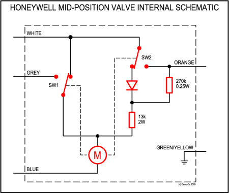

Although there is no colour code for installation cables, the three port valve do tend to have a colour code, I will stand to be corrected, but I think a three port valve means you have either a Y plan or W plan most likely Y plan.
So the valve blue = Neutral, Green/Yellow = Earth, White = output from wall thermostat, grey = N/C contact of cylinder thermostat, and orange goes to boiler and possibly pump.
Basic idea with most motorised valves is the thermostat works the valve and the micro switch inside the valve works the boiler and pump so boiler will not fire up until valve is open. However the three port is slightly different as the default is DHW so all three connections used on the cylinder thermostat com, N/O and N/C some people are rather naughty, it should be a 4 core cable to the cylinder stat, but I have seen many times where people have used the earth core and only used three core cable, so green/yellow is some times a live wire, be careful.
Testing wires can give some odd results, as inside the motorised valves there are quite a few components mid-position-valve.jpg so you can get back feeds, I note the Nest wiring diagram for Y plan shows the valve colours, don't know what Hive shows. But if No 4 (CH on) goes to white on motorised valve it should work.
