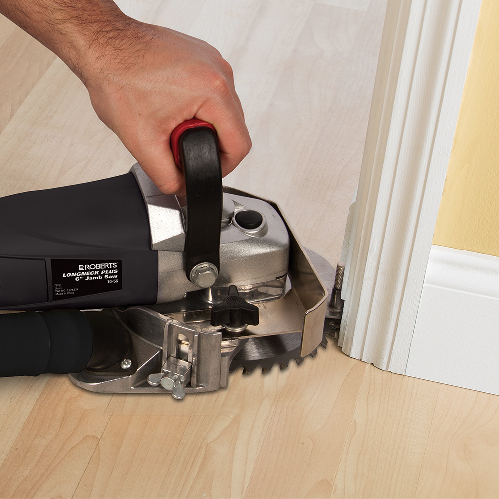

Hire the right tool for the job at 20-30 quid, cut the skirting, crack on... leave enough clearance and fill the eventual small gap with slicone. Id not grout up to skirting, which is wood and expands and contracts...
Out of interest, what would the right tool be in your opinion?
This is along the lines of the right Tool , it’s a Skirting Board saw , most good Hire shops will have them
