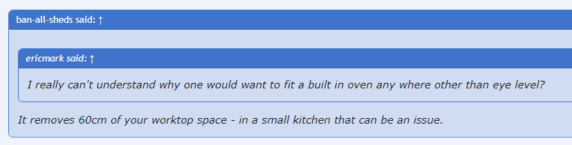

I really can't understand why one would want to fit a built in oven any where other than eye level?
It removes 60cm of your worktop space - in a small kitchen that can be an issue.

I'm lost. A oven installed under a hob (so clearly 'other than eye level') surely does not "remove 60cm of your worktop space"?
On the other hand, if one installs it at eye level then it does "remove 60cm of your worktop space", which I thought was the point you were making.

I assumed that BAS meant that some people might want to install a oven 'other than at eye level' because if they did install it at eye level it would "remove 60cm of workstop space".
Yes, more or less.
Eric said he couldn't understand why one would want to fit a built in oven any where other than eye level?
Bas replied - [because] it removes 60cm of your worktop space.
Did you interpret it as having some different meaning?
I don't think so.
Yes, more or less. ... Eric said he couldn't understand why one would want to fit a built in oven any where other than eye level? ... Bas replied - [because] it removes 60cm of your worktop space.
Ah, having now re-read it ten more times, I now see my mistake :oops:
Strangely. although (as I subsequently demonstrated), I understood what BAS meant, I think my brain must have focussed on what he "actually wrote" which, in the absence of any qualification, seems to say that the reason why someone would want to to install the oven "other than at eye level" is because that would result in "removal of 60cm of your worktop space" (which is the opposite of the truth). Strange the way minds work, and I haven't even opened a bottle yet :)
