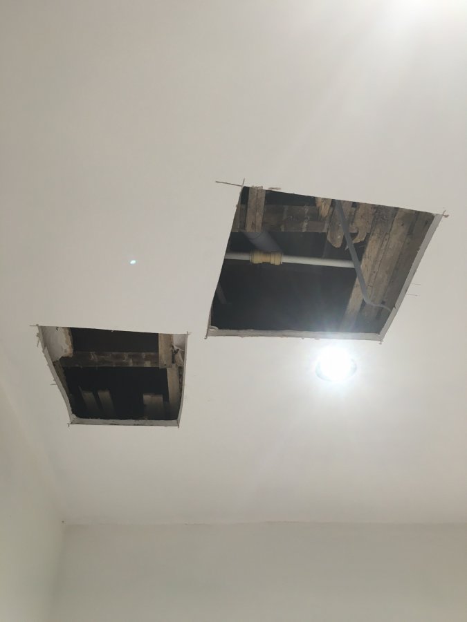

So a rogue plumber installed a bath which then leaked into my kitchen ceiling, leaving a HomeServe guy no option but to carve two holes in the ceiling to get to the problem. So now I'm left with two jigsaw shaped ceiling parts to reattach (see image) Now while this may be bread and butter for the majority of you, I am a DIY novice to say the least.
I am thinking some adhesive/polyfilla and a lick of paint to finish it off?! Any recommendations or pointers would be greatly received.

Depending on the size you could fit a hatch into at least one of them to access that area in future. if you have the cut-outs you can put some battens across and then screw it all back in then get plasterer in to fix it.
I think the hatch is a very good idea. It could give access to the under-bath or under-shower plumbing and waste, which are relatively common causes of leaks and quite difficult to get at.
In my case the kitchen is beneath, so judicious positioning might allow any water to drip or gush onto the sink or drainer below, minimising damage.
I'm thinking a plastic hatch, or WBP ply of the same thickness as the plasterboard, undercoated smooth and painted to match the ceiling. Unless you have uplighters, it might not be very conspicuous.
I suppose a multicutter will go through plasterboard? I've only used the score and snap method. What's least dusty?
Patch it in with plasterboard and reskim the ceiling. If the plumbing is done correctly there's no need to have a hatch in your ceiling just in case lol
I would probably find the ceiling beams and cut back to them, possibly making 1 big hole instead of the 2. Re-board the patch, and a good plasterer could hide it pretty well. Then it's a mist coat and a couple of goes with filler (drywall jointing compound is excellent for this, quick drying and easy to sand), and 2 coats of paint - 1 over the patch and 1 over the whole ceiling.

Be careful not to cut through any wires that may be lying on the plasterboard out of view. While a multitool won't easily sever them, it will chew through the insulation reasonably easily and could bridge the cores or liven up the blade
Score and snap method creates less mess.. but as other say, cut a new piece to cover the hole, screw to ceiling and use a patching plaster to cover the cut line. Then a sanding sponge or fine sandpaper to blend in the patching plaster. It will take a couple of goes as it shrinks, when you are happy its smooth - just paint it as normal It will be invisible if you take your time with the sand paper.
