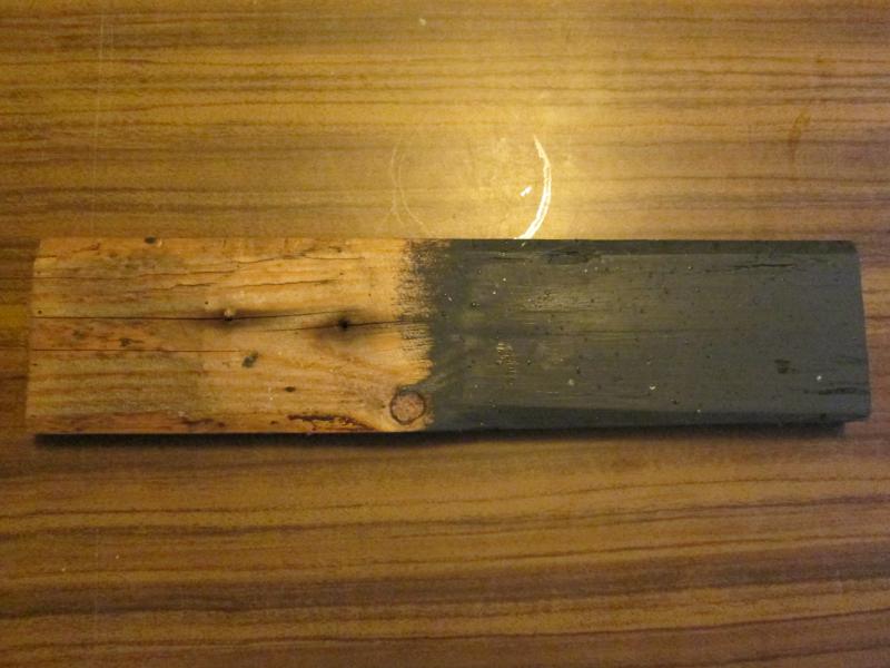

Also, a scrap of old pallet painted with Holkham which has been on my sunny bedroom windowsill since I started the experiment shows no sign of failure.
Early days yet, but so far so good :)
EDIT picture of my scrap of pallet, on a drizzly day

I wouldn't say the grain IS visible. What you are looking at in the picture is a very scrappy bit of pallet, with a couple of shakes and a bit gashed out near the top of the photo. The pallet scrap in the picture has had the full 3 coat system.
Definitely a silk or eggshell, not a gloss. May look glossy when first applied but give it a few days and that goes.

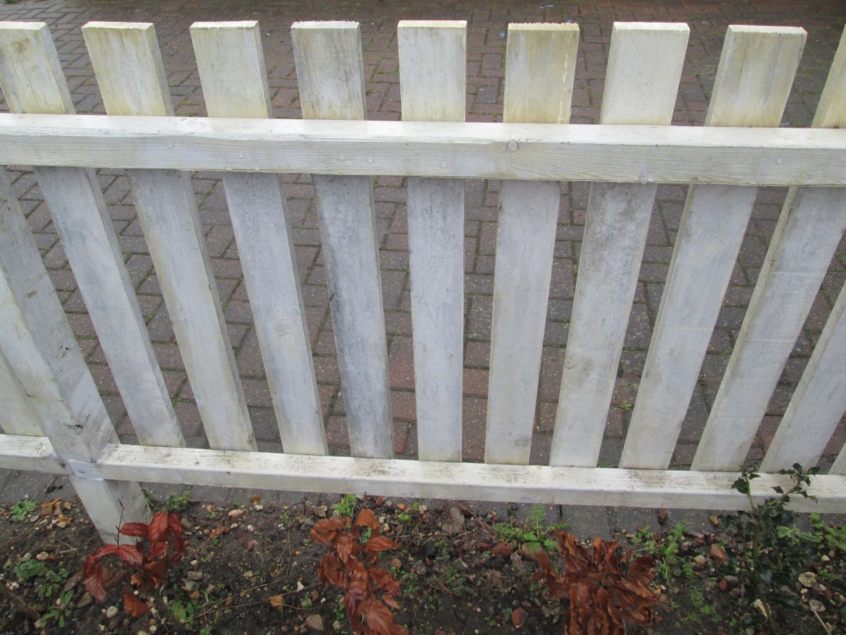

I decided to use white Allback paint on the new garden fence in June 2014.
Some was primed with the 'wrong' ie non-Allback brand oil. Some with the Allback branded stuff. Some oil was applied hot, some cold and then heated with a blow-torch. Some parts of the fence installed before the new drive and then covered in clay. Some installed after, so kept clean.
This was on the Southish side of the house in June.
By November, there was a bit of a grubby look to the fence. The factors above seemingly had no bearing on performance. It washes, but has some residual staining. No doubt it protects alright, but as a decorative finish, I would not recommend using white outdoors in the British climate based on this experience.

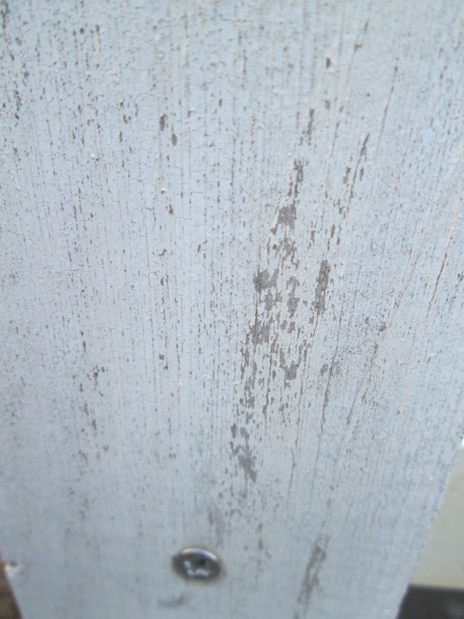

The pallet scrap sat on my windowsill has peeled _very slightly_ in a couple of places (not sure whether I even primed that scrap properly to be honest), but, unlike gloss, the Allback has not peeled back and trapped water, and the oil does seem to be protecting the wood even there). It does shed pigment when wiped with a microfibre cloth.

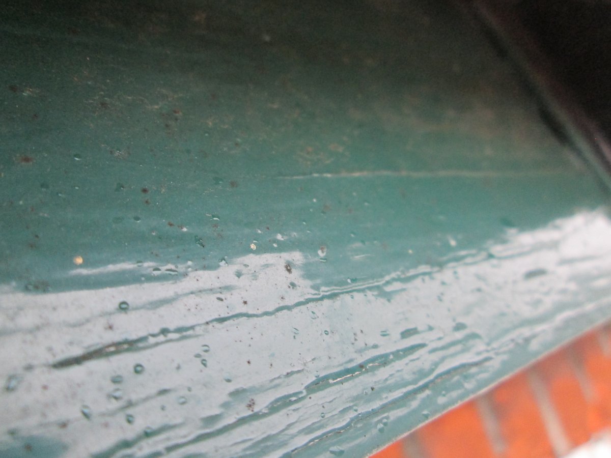

The dark green gloss (now 4 years and 5 months old) is starting to show signs of failure where it was applied over previous paint, but still working perfectly where it is on a sound surface. Small hairline cracks have appeared in the gloss.

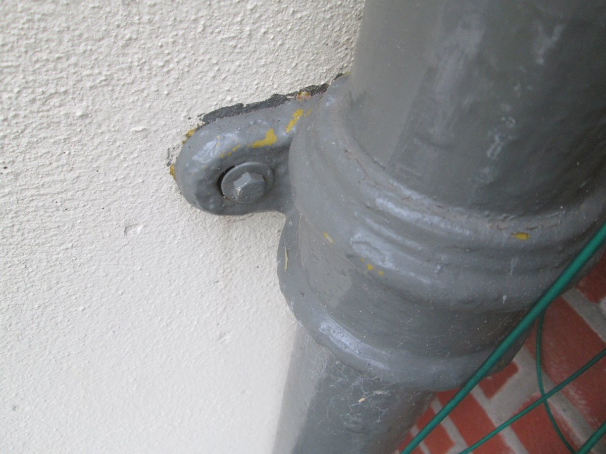

The grey Bedec Barn (now 2 years and 7 months old) (next to the very dark green section) is still holding well. In a couple of patches on the iron downpipe, it has come off, leaving the previous coat of gloss exposed. This may have been poor preparation, but I think I'd have got away with this had I used gloss.

The other question is, what about the white fence installed in June 2014?
Actually, I'm not happy with the white fence at all. Some of the pickets weren't primed with the right brand of oil, but ALL the pickets are mouldy - just different colours of mould. 15% zinc oxide was mixed into the first coat of paint as per manufacturer's guidelines - there should be no mould.
You might excuse the pickets as they were treated timber that arrived wet and had to be washed and left to dry out for some considerable time before they could be painted, but the posts and rails were dry clean sound timber and should have stayed white: they haven't.
Does the dirt wash off? Water and a microfibre cloth (nothing more extreme) got it looking a lot better, but it still isn't pure brilliant white any more. And this happened in one area (this area was definitely primed with the 'proper' Allback linseed oil, not the other brand):
That's right: the surface of the paint is coming off. While the oil is likely to have penetrated the wood and may still be protecting it (and perhaps this was a resinous area not needing protection until the resin washes out), this is still a fail in my book. Paint is supposed to be a decorative finish. No doubt the fact that the wood was sold to me wet and mouldy (thank you Jewsons) and was then washed with bleach and rinsed and dried before painting won't have helped (Allback specifically recommends that high-PH cleaners are not used), but then I had to paint the fence I had, not a fence I didn't have.
Besides, this peeling of surface also occurred on some of the rails of the fence - these were good clean timber and had had no bleach on them. If this peeling is my fault, it may be that not enough linseed oil, as primer, was absorbed. But by this point, I'm blaming the instructions. None came with the paint, but they are online and they were consulted. But they seem to exist in different versions, which gets confusing. They say to heat the oil (I'm sure I've seen various ways - I had it hot in a can), and then paint immediately. This is what I did - but I'm not convinced it was the best way in the circumstances... and it takes a lot to go against manufacturer's instructions. Is this really a paint that is suited for use by those without product-specific training?
