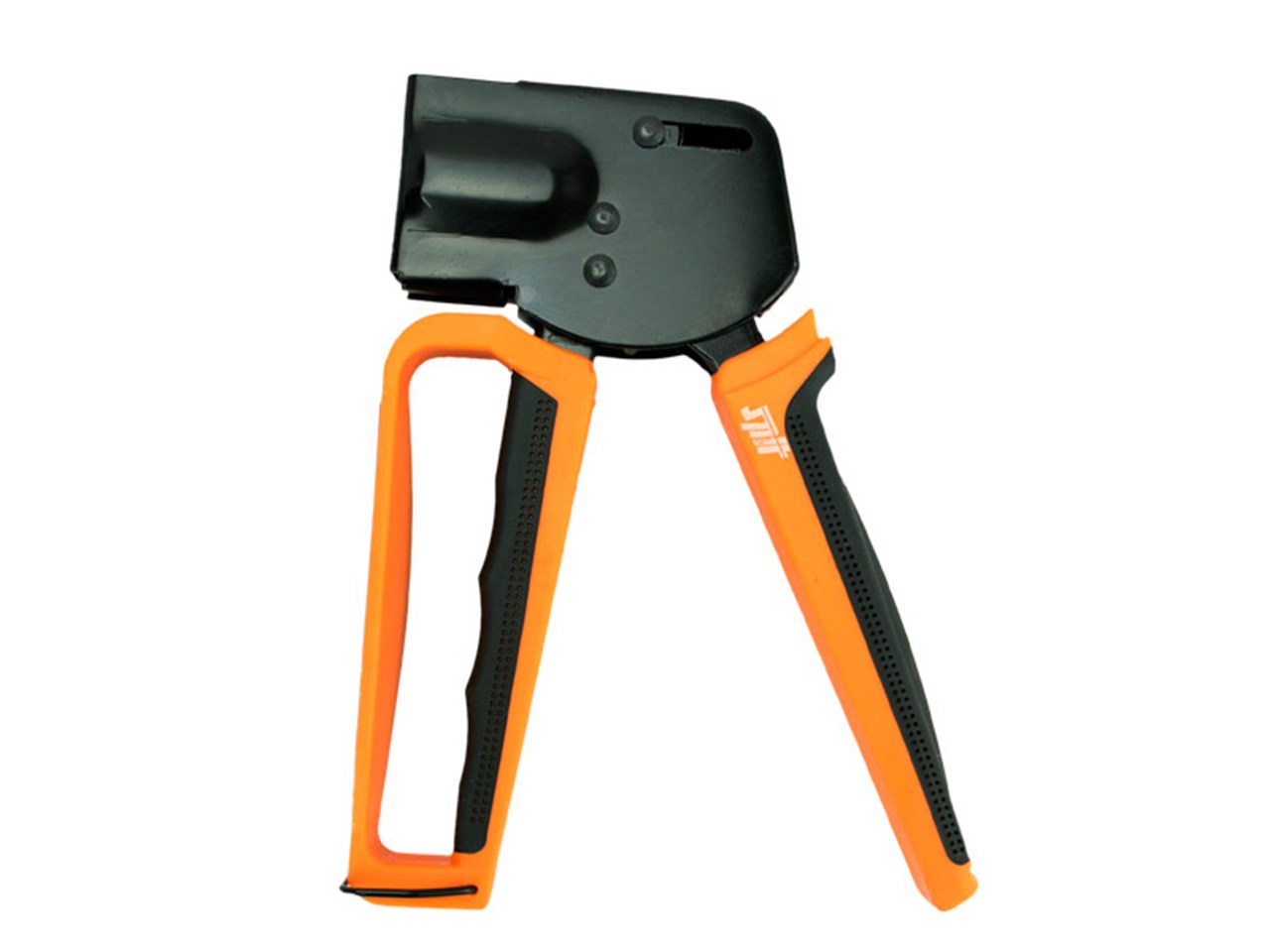

Available in different sizes for different wall thicknesses (most domestics would need 32 to 45mm length). Ideally needs a setting tool for best fix (this is a Spit one, other brands available):
Go for better quality fixings such as Rawl, Fischer, Spit, etc rather than cheap own-brand ones
