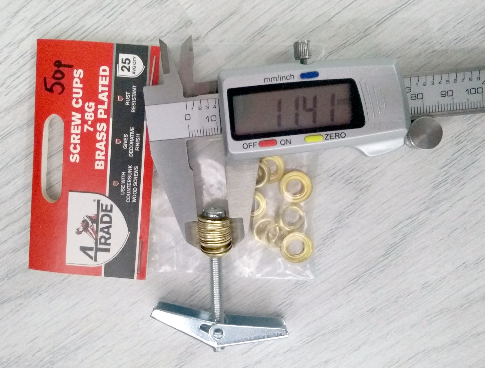

I found these cups but still not wide enough but they do stack nicely and sort of self level.

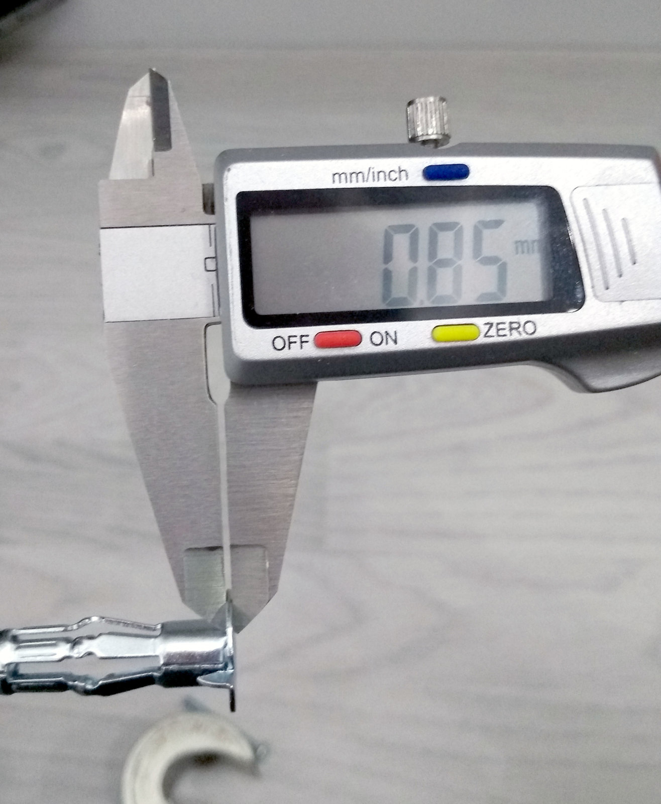

The nut in the spring toggle looks very thin, they are rawl plug ones - is that about normal.
And here is the measurement of the flange on the rawlplug 5x 37
I would not trust the bottom of the bracket to make it any thinner. Its plastic. I don't have them with me to post a picture
Don't worry about the spring, they are purely to open the toggle after insertion, nothing at all to do with the strength of the fixing. They would work fine without it there at all, with a little jiggling to open the 'wings'.
there must be something out there
Closest I can find is nylon spacers 15mm OD...
https://www.ebay.co.uk/itm/192581956316
The last item on the drop-down menu, or scroll down the page to where it says NEW SIZE. They are M6, that teeny adjustment may come in handy. They're 20mm long though, but nylon is easy to cut.
Edit: You musn't let the toggle tighten up against the spacer. I'd be tempted to cut them down to 10mm so that cannot happen.
rsgaz -well done that man !. Good detective work they look like they would do the job but as you say best cut them down a bit.

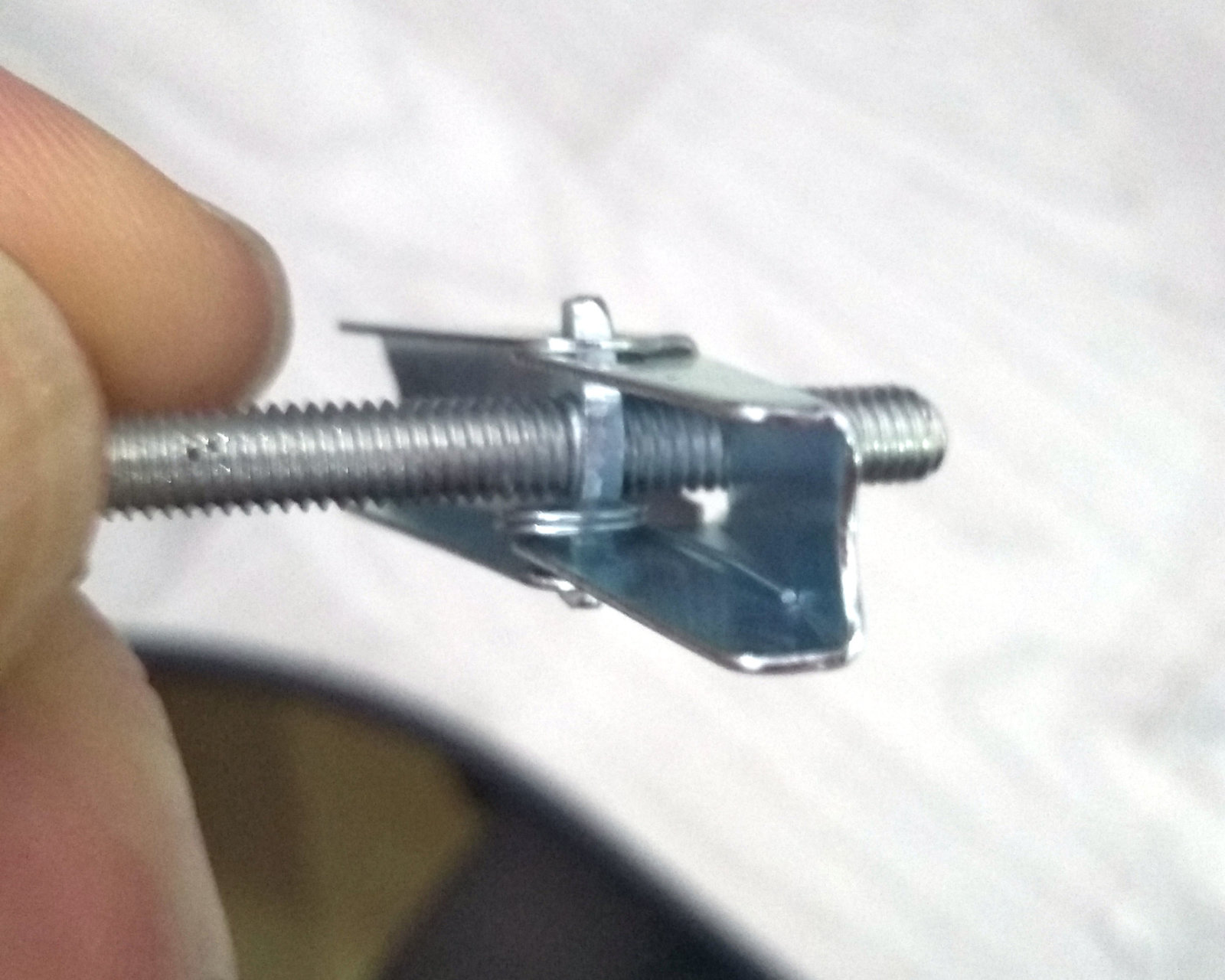

Sorry its not the spring but the nut in the toggle, I was just calling it a spring toggle to make sure people did not think I was talking about the umbrella fixing. The nut looks very thin.
Ahh, sorry. Did I misread that or did you edit that bit? :oops: Anyway...
On a normal nut, it's only the first 2 or 3 threads that actually do anything, look at the stress diagram...
So the nut is fine. You don't want to go crazy tight with any kind of plasterboard fixing anyway, you actually make the situation worse by weakening the board. As a guess, the only reason ordinary nuts are so 'long' is to get a better grip with a spanner and provide some redundancy against worn nuts. Which would only be relevant for nuts which suffer constant vibration, changing stress levels/angles, temperature changes, regular undoing/tightening, etc. Car wheel nuts probably the ultimate example.

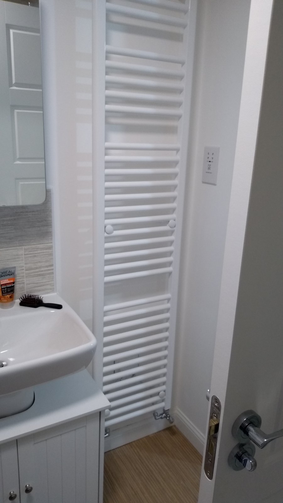

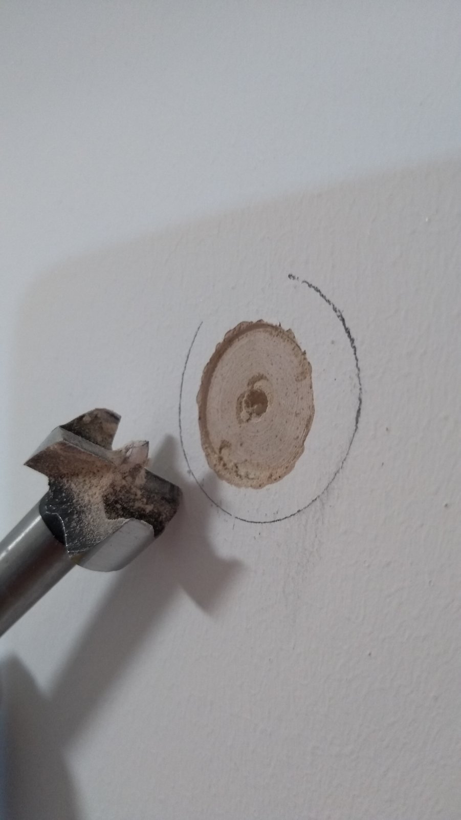

Finally got round to posting an update. I brought a rawlplug setting tool and used those fixings for the towel rad. But I first took off the plasterboard skim with a 15mm forstner bit (being carefull not to cut into the plasterboard paper )which then meant that the flange on the plug would sit below the surface, future fixings I will forstner the back of what is being fixed but in this case I could not. First picture shows that.
Second picture is the bracket nice flat on the wall.
Last picture is the job done but out of shot is another pair of brackets right at the top.
I brought an extra set of brackets as in the middle I had a good fixing behind the plasterboard into a stud and wanted to use that but that also meant that there was nothing from the middle to the top because you only get 4 brackets. My case 2 at bottom at 2 in the middle. I did not fancy such a big rad with just fixings into plasterboard. So you can see on my photo of the bracket I had to cut it down to match the other 4. You can not see the end as it is the unseen telescopic part.

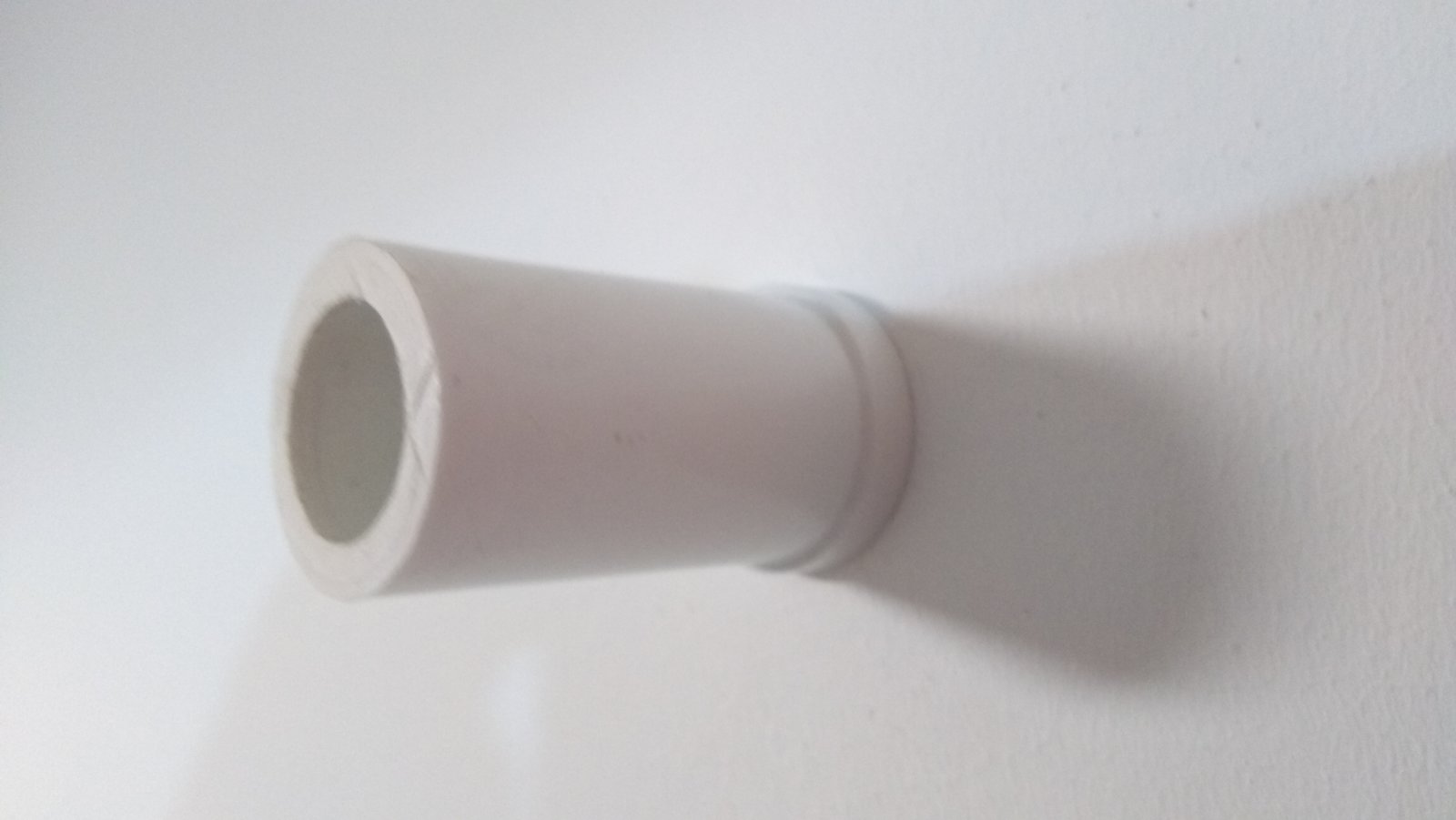

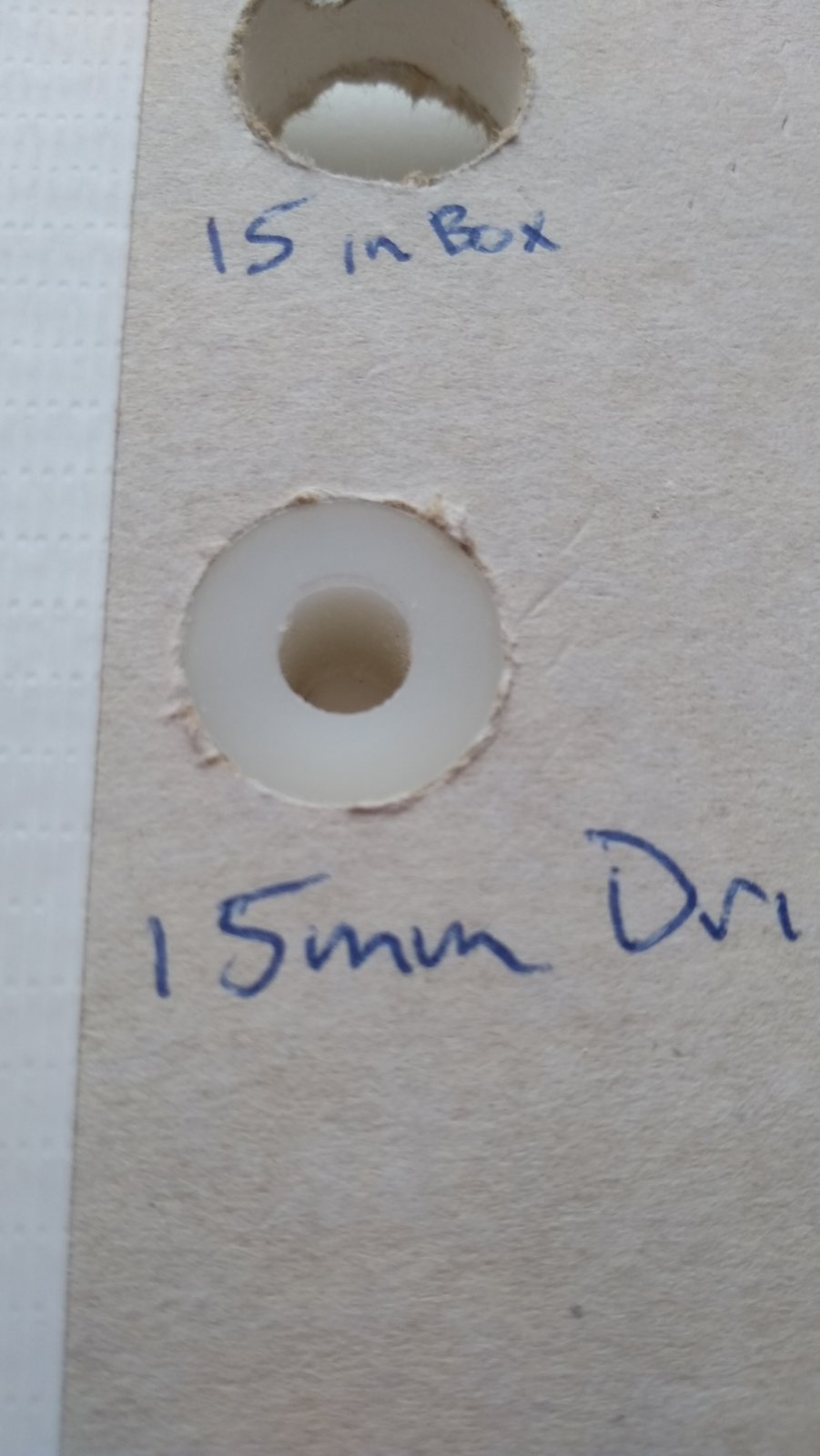

@rsgaz I brought the spacers that you found- or similar, I looked and looked for something shorter but could not find so I got the slightly too long ones and cut them down. Picture shows one in place. They are 15mm diameter so I Brought a 15mm engineers drill a 15mm forstner bit and a 15mm hole saw and tested to see which one gave the tightest cut for the spacer and also that did not do too much damage to the rear of the plasterboard on break out. The best for non break out was the hole saw but it was a bit of a loose 15mm hole - as was the forstner which also was the worse for break out damage. So the best was the standard 15mm drill bit. So with the spacer inserted the 15mm hole becomes 7mm
Although in the end I did not use the butterfly fixings.
