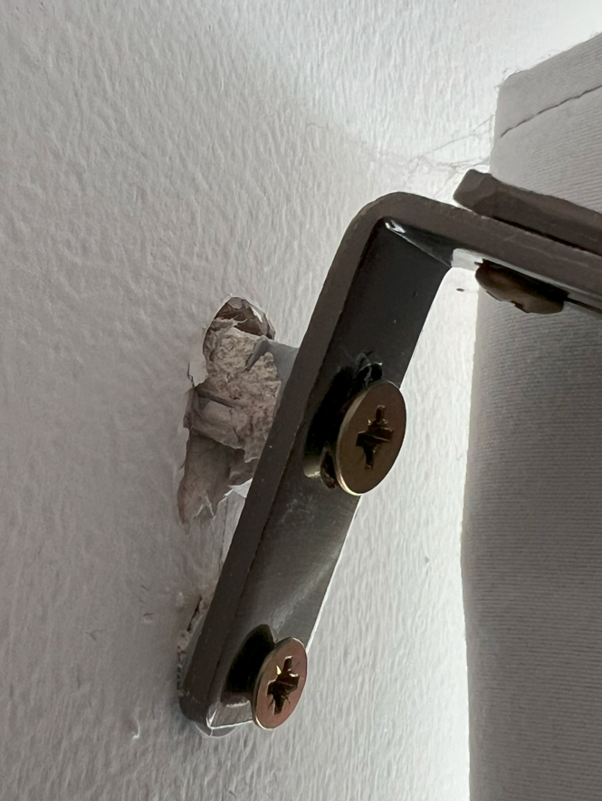

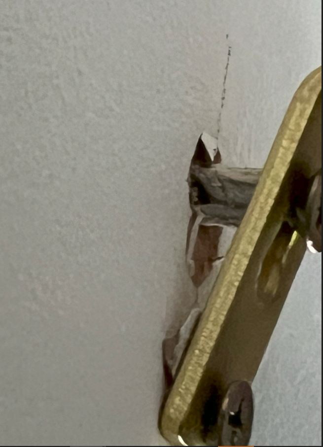

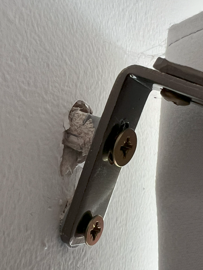

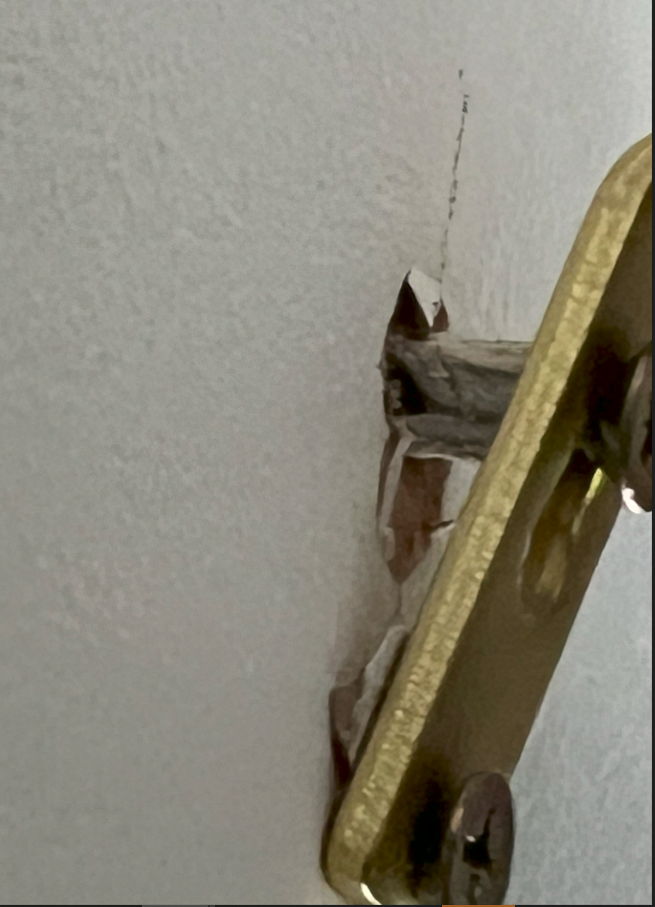

Emboldened by this success, I want to tackle two curtain rail brackets that are pulling away from the wall.
The wall in question has cellotex backed plasterbaord that is dabbed onto blocks. I don't think these wall anchors would work with the cellotex backed board?
Also, the holes in the plasterboard are now wider than when originally drilled.

Can you take photos of the fittings?
Here are images of the two affected brackets. They are on different walls and for two different curtain poles:
In my opinion they are significantly far enough from each other for you to be able the interset cavity fittings that you have. Perhaps try to ensure that "wings" will be at 45 degrees to horizontal to ensure that one doesn't clash with the other. Or rather that one will be at 90 degrees and the other at 45 degrees- thereby avoiding any clash.
