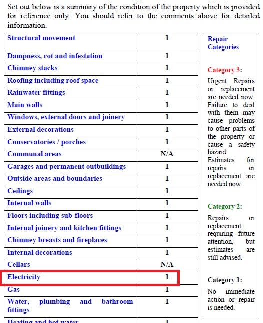

I recently viewed a house which is on the open market, with a view to purchase. This is one of the fuseboxes in the house:
I had read the statutory Home Report before viewing the house. Here are all the parts of the Home Report that make reference to "Electric"
Would it be reasonable to expect the Home Report to make some mention of the fact that one of the fuseboxes has apparently undergone some stress?
Incidentally, the fusebox had been in that state since the house was built in 1998. The home report is dated 2014.

The Home Report is a sham. Name and shame the company responsible pls! Last two properties where I am familiar with the electrical installation whose home reports I looked at. 1) PVC/PVC wiring throughout with an earth, split load 6yr old CU - got a code 2 for electrics because some sockets are low in the wall and there was an old, redundant (disconnected) 3036 fuseboard which has previously served storage heaters many years ago. 2) No earth in cloth/rubber/conduit lighting circuit; multiple unsheathed in-service wiring; masses of rubber and lead sheath cable; wooden back-boxes and ancient accessories; dodgy diy alterations everywhere (and much more...) got a code 1. The electrics parts of a home report are worthless!
The MCB that was next to the main switch was the first failure from severe overload and /or loose terminal. The heat from that fault melted the cover and therefor was hot enough to have damaged the adjacent main switch. The MCB that had been next was scorched and has been replaced but then fitted as the far end of the row of MCBs

That's appalling that the home report assessor scored that as a one.

As you say, it's somewhat of a difficult situation. However, that report is clearly plain ridiculous, at least as far as the electrical bits are concerned - hence a potential danger to anyone who interprets it as meaning that the electrical installation is safe. He has, of course, covered himself to some extent by recommending that the installation should be inspected by an electrical engineer - but that's still no excuse for what he's written in the report.
One has to assume that he didn't even see that consumer unit (so what else didn't he look at?) - since even a 5-year-old who saw that would probably realise that something was wrong!
