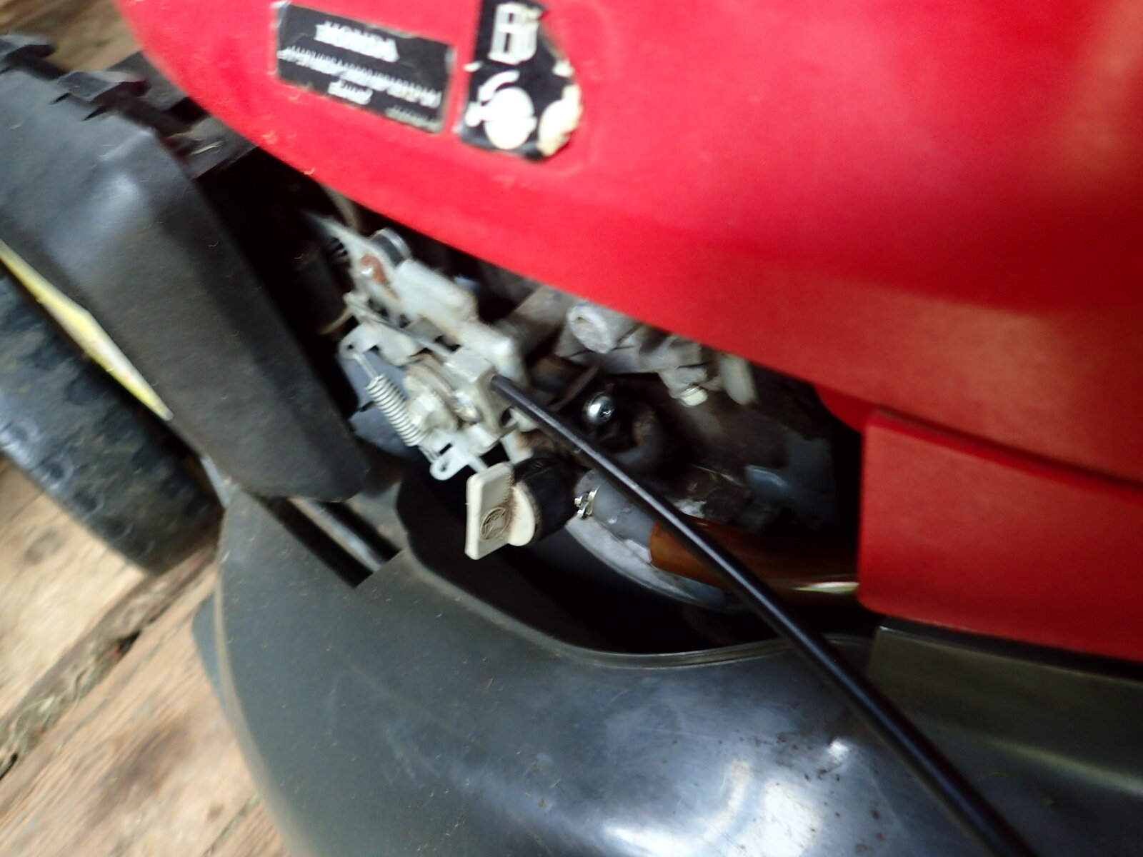

The tap on my machine is very hard to turn on/off.
Have Honda replacement, how do I get to the one cross head screw to remove tap.
Have tried right angle screwdriver but this proved no good.
Thanks for any help.

The screw is at the back of the tap, I am unable to get a straight line with the screwdriver !
Thumbnail pic may be better, sorry.

You can buy various screwdrivers with a right angle close to the tip, or if you have a cheap one and a vice - you might be able to bend the shaft to a right angle.
If you have a small socket set and some phillips bits, that might work.

Tried a right angle screwdriver unable to move it, have given it a spray of WD will leave it to soak and try one of your suggestions, thanks
Is access any better if you remove the red fan cover.....3 x 10mm nuts?

Thanks john.
Is there anything that may be lose or something that will come away if this cover is lifted off ??
No, you can't go wrong there - the recoil unit comes away, just watch for the three spacers that lurk in the plastic below!
The rest can be lifted clear complete with the fuel tank - no need to disconnect, just move it out of the way.

The screw is at the back of the tap, I am unable to get a straight line with the screwdriver !View attachment 232425
Manager to undo the screw with a flexi shaft screwdriver.
But then got stuck with the two clips front and back holding the fuel line, not get them to move, giving up for the moment, I was using circlip pliers, what a job just to replace tap.
Those horrible wire circlips that never undo? First things into the bin for me - never had a leak yet!

My reasoning.....those wire circlips don't compress enough to slide off the rubber pipe - which expands slightly after its pushed onto the tap and I end up pulling them off, more often than not as they deform so much.
Maybe that sounds a bit cavalier, but its fine on these - however I have an arsenal of kosher tiny screw clips that I call on if needed.
