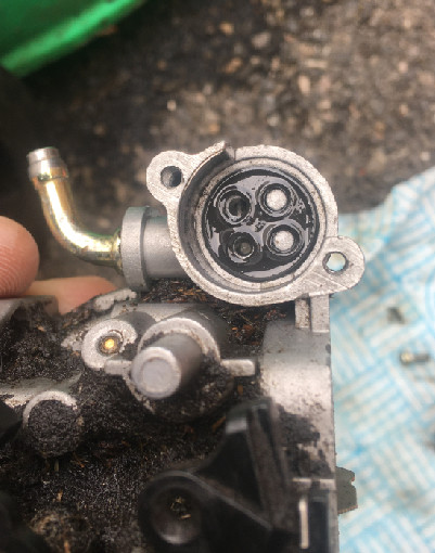

The fuel tap has a rubber washer like thing inside with 4 holes in it.
2 holes locate on 2 pegs to locate it & the other 2 holes must be the in / out for the fuel depending on where the tap is positioned.
Its clean & ive noticed a screw had been damaged in the process so somebody has been here before.
With the tap cover off & the fuel from the tank flowing i can see it making bubbles as it comes through one of the holes BUT is it then going down the hole it should be ?

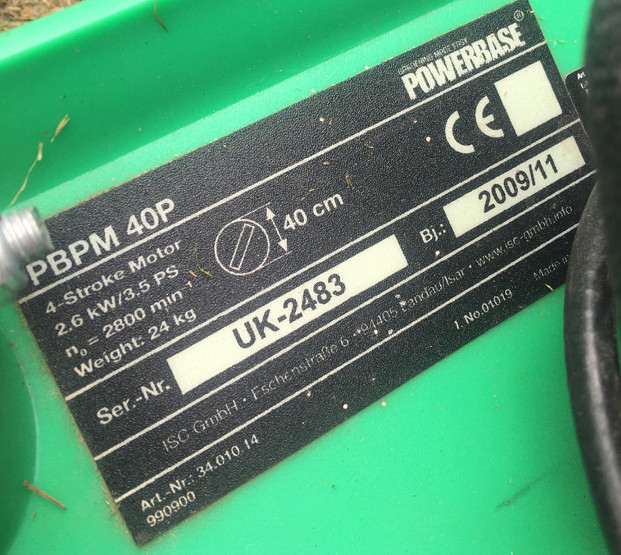

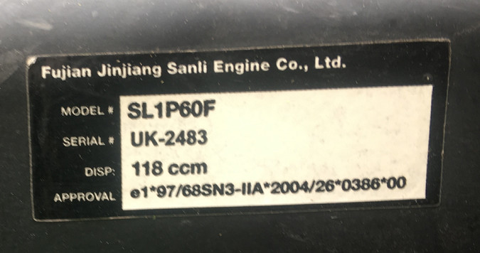

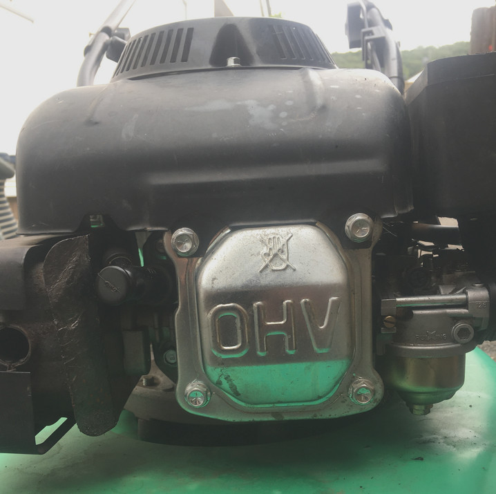

Im looking for a carb so supplied photos to see if you know what motor it is.

Its a Chinese special, marketed by Homebase.

Ah, so the tap is integral with the carburettor then, two screws holding it in?
Similar to the Honda GX100 type, drop the float bowl off and work the tap - let’s see what happens.

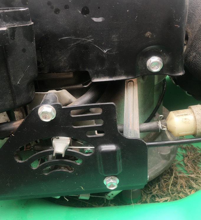

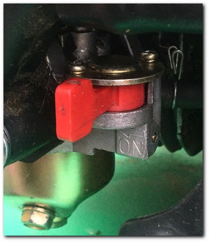

There are 2 screws holding the tap cover on and has a red lever.
This is why i asked about removing the rubber washer with the holes etc.
If the tap can be bypassed then good.
Tomorrow i will remove float bowl & with fuel in the tank operate the tap & see if fuel then flows.
See photo of tap set up.

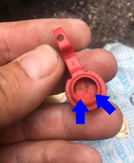

Morning,
Ive managed to get outside now the rain has stopped.
Fuel in the tank and fuel drain from the float bow when the 10mm bolt on the side is used,this is the drain bolt.
Now float bowl empty.
No fuel is flowing from this hole so i assume the tap is in the off position.
I then move the tap across but still no fuel.
I pull the fuel pipe off the tap & it flows.
So my issue is the tap.

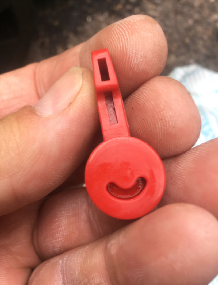

So i was thinking that to keep the fuel tap sealed & to have no leaks i would drill a hole through the red plastic piece.
Operating the tap will have no effect but fuel will then always flow.
Do you agree ?
See attached images which show the two ports for the fuel when the tap is rotated,i need to drill down through both

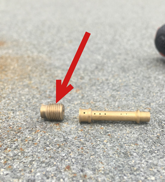

Hi,
That didnt make any difference putting a hole through it.
There must be a blockage etc.
I have supplied a photo.
In the float bowl there is a long metal tube which this long holed part fits into,all the small holes are clear & i can also look through its length no problem.
The piece arrowed has what looks like a hole but i cant see through it.
Should i be able to look right through it as i cant so this could be why it will not start ?
Im not sure of the route taken once the fuel goes through the tap
The arrow shows the main jet which must be clear.
the other photo is the emulsion tube, fed by the main jet.
John :)
