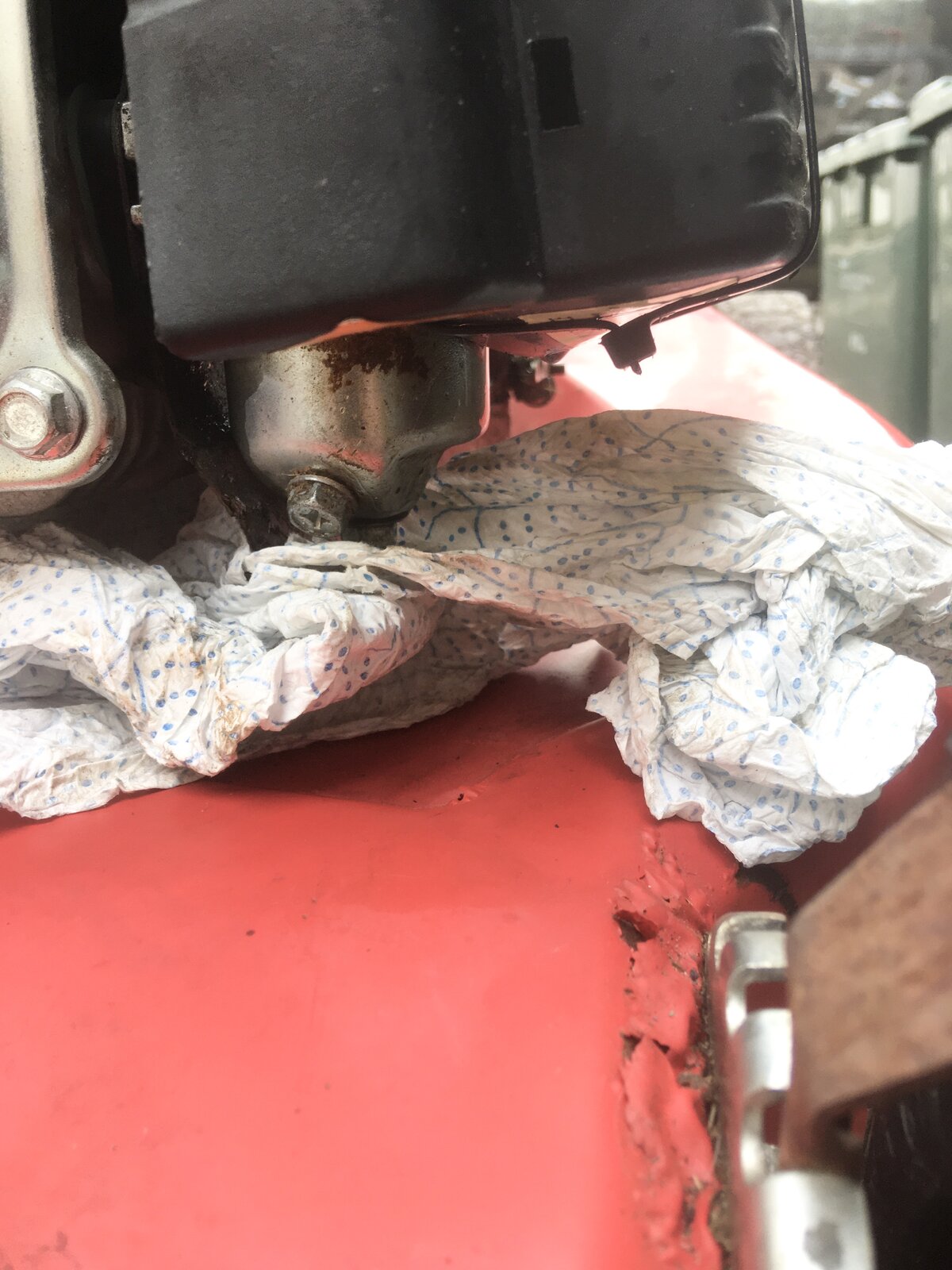

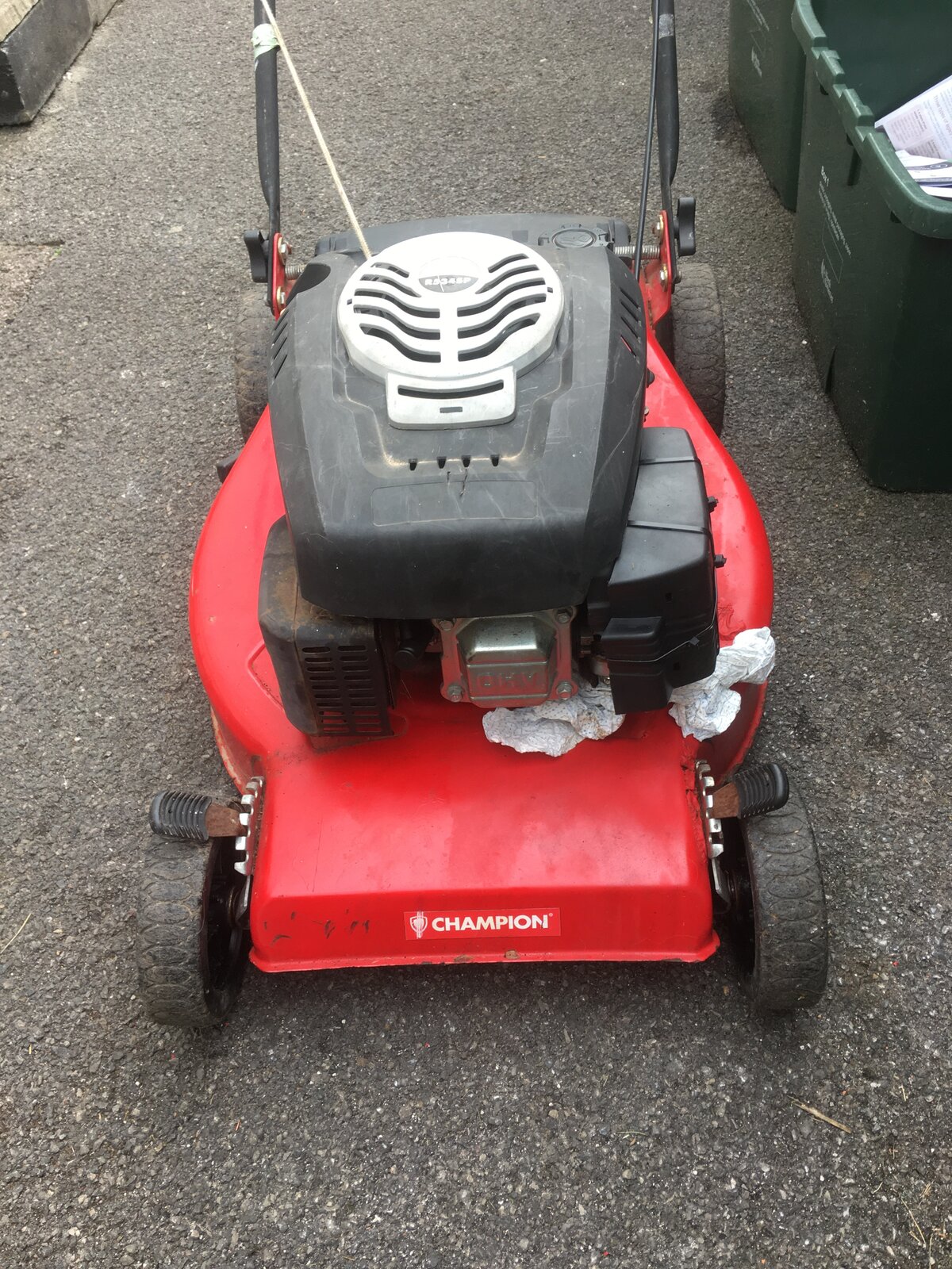

I’ve bought the mower shown in the supplied photo.
I noticed fuel dripping from the air filter.
Remove filter / housing & carb.
Cleaned carb & made sure all jets were clear & that when the float was raised I was then unable to blow through the fuel inlet pipe until I lowered the float.
I’ve put it all back together but still see fuel dripping out the air filter.
Why or how is this possible if the float was cutting off the supply when I was trying to blow down the pipe ?
I can start the mower & it runs lovely without any up / down tick over issues.

The pressure one can put on the needle valve by lifting up on the float can be far greater than the bouyacy of fuel so not an infallible test especially if the needle is rubber tipped
I agree with LITL - the fuel level is just that little bit too high. Ideally the level should be just below the emulsion tube outlet (not that you could ever see that!)
As far as I know, its only Briggs and Stratton that use a rubber ring on the needle valve so I guess the needle on yours is worn or maybe there’s a tiny bit of grit in there.
Fitting a petrol tap is a good idea!
John :)

If there's no leak on tank or pipe joints the only possibility is a needle valve letting by.
Unless you have a rat hooked on ethanol:LOL:
I see no leaks at all.
Before the fuel was dripping from the air filter housing onto the deck.
So if the fuel is now going into the bore then surely i would expect some to come out the air filter again but it isnt.
Also i dont know of oil level before i started
Unless the machine is perfectly level then the fuel will drain either out of the air filter housing or into the engine. It could pass through the inlet valve guide and dilute the oil or it may just flood into the barrel, past the piston rings and enter the sump that way.
Sometimes you can smell petrol in the lube oil, sometimes when you try to start the mower it locks up, due to excess fuel trapped in the combustion chamber area......this is called a 'hydraulic lock' and is best avoided - just on the off chance the connecting rod can be bent.
