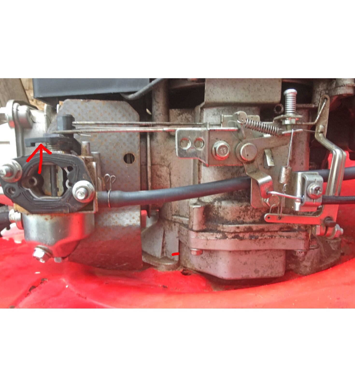

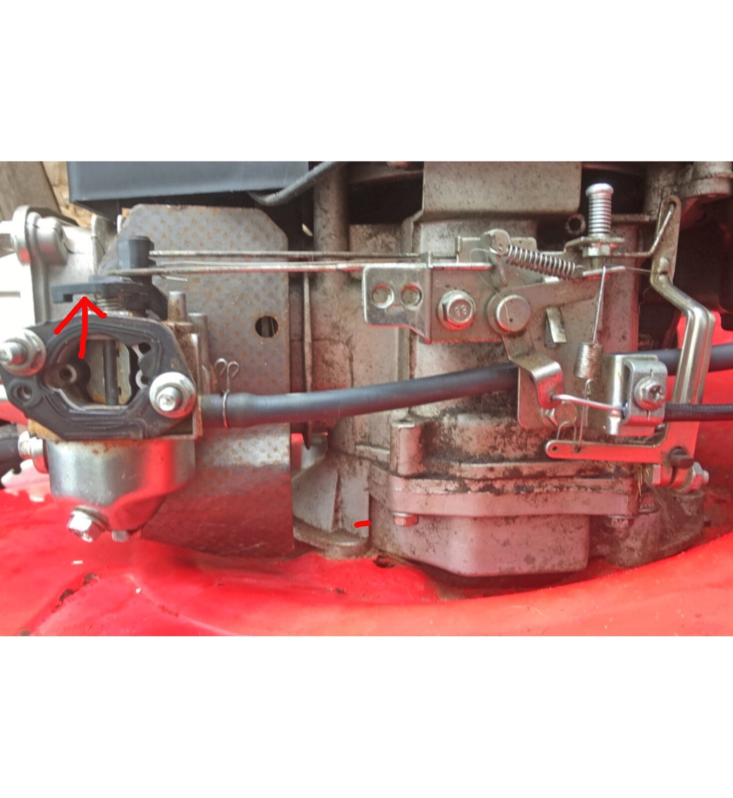

So looking at the photo with the yellow arrow if i screw it down then the lever would operate & thus the inner cable would then start to come out of black outer which in effect is the same as moving the throttle lever towards the TORTOISE.
So this sounds correct.
Im sure ive got the cable locked up in the wrong place or the inner cable is too long etc etc
That would possibly explain why when screwing in the revs go down then
Simple to check.... Move the lever on the handle back and forth, from slow to fast - if the lever coincides with fast and touches the end of the screw, then it must be a maximum speed setting. However, as said - I have never seen a maximum setting ever.
The yellow arrowed screw is the maximum speed adjuster.....undoing it will cause the maximum revs to be achieved - the governor will take over eventually, of course.
The pre set maximum revs are purposely kept on the low side to maximise fuel economy and minimise pollution.
The tickover screw should be on the top of the carb - we'll need a pic of it for that.

I should have said, the max speed screw is often of the tamper proof variety......Honda use a tamper proof torx which is easily turned by pliers instead :whistle:
John :)
The screw is a torx with a pin in the middle so it is the type you mention.
I have the tool for it anyway.

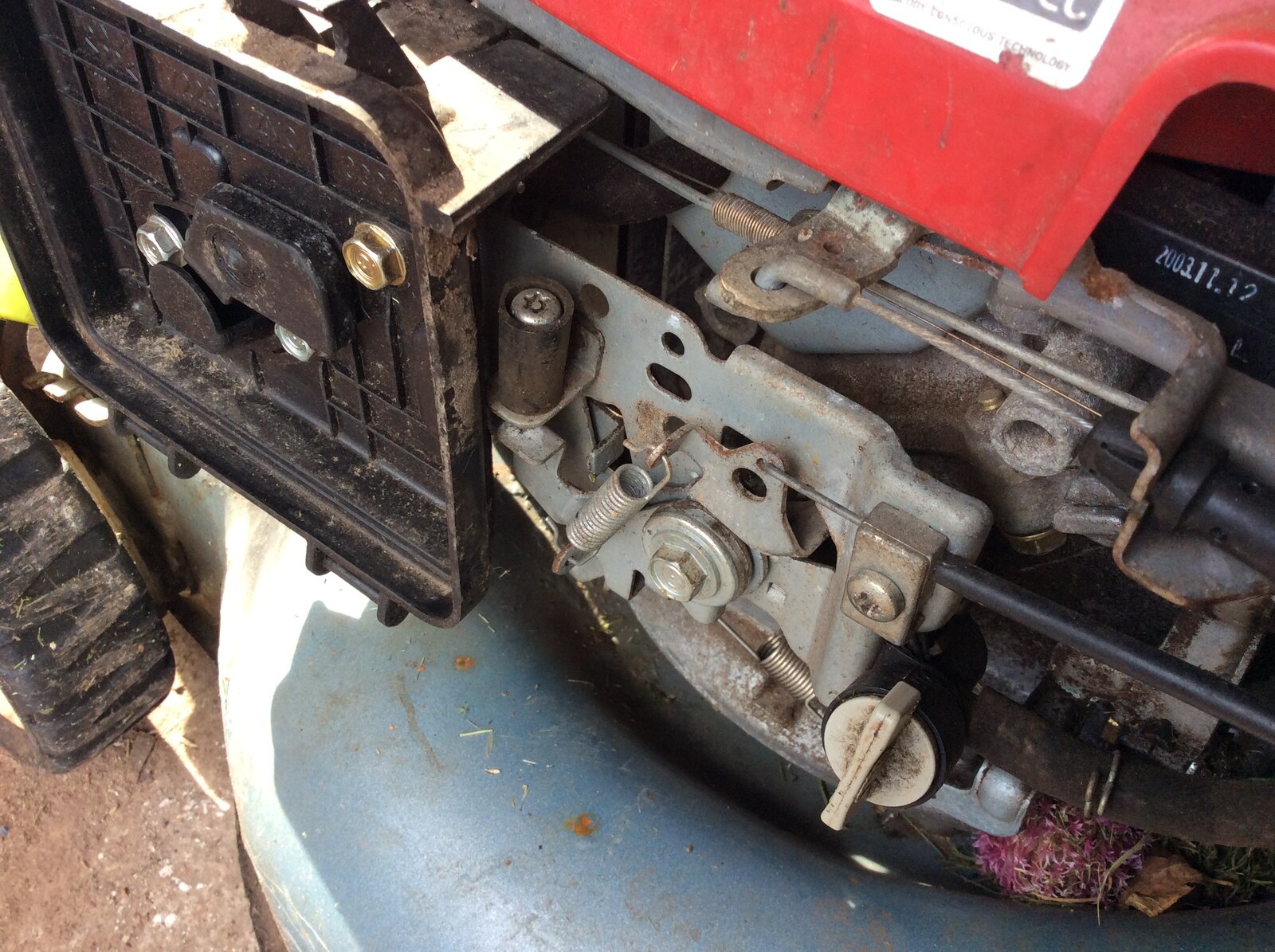

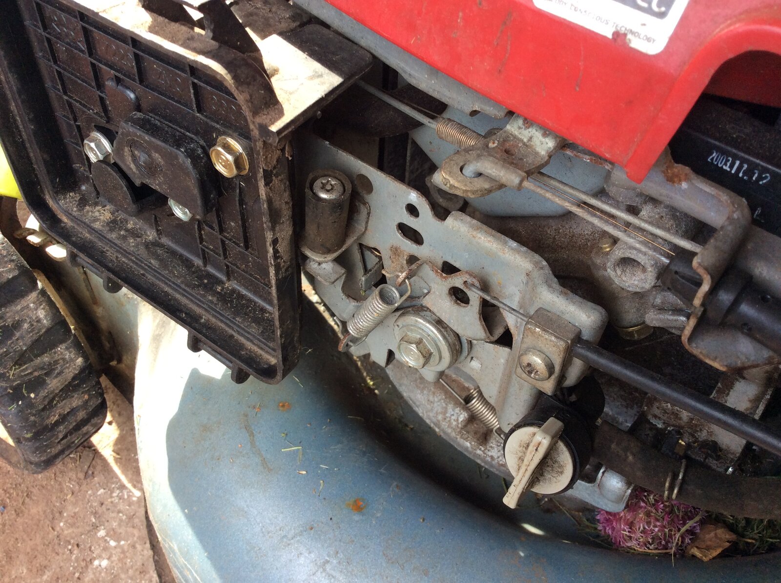

Again, looking at your last picture.
If that part of the throttle linkage is touching the bottom of that tamper proof screw, that's as fast as the engine will go.
On the tortoise setting, the engine should come down to tick over. It should have a stop indent that holds it there. Moving the throttle lever further from tortoise should engage the choke flap.
John :)
That’s what I mean in a post or two back.
If I move the lever towards the tortoise tick over doesn’t happen and you get the sense it’s going to stall. You must then move the lever back towards the hare.

Still unable to sort this so I took the cable off & started from scratch again.
I’ve now got the cable fitted so when the throttle lever is on the choke logo the butterfly in the carb is fully closed. When the lever is on the tortoise logo the butterfly is fully open.
I put the lever on choke & start the mower. I wait a while & start to move the throttle lever off choke back towards the hare. I hear the revs start to drop. If I keep moving it back towards the tortoise I can see it’s going to stall so needs to back towards the choke logo.
There is a black screw on top the carb and I can screw it in all the way but doing the above with the lever still happens.
If the engine won't run without choke then it's a fuel starvation issue.
If the engine won't run at slow speed then it's still a fuel starvation issue - the pilot jet this time. This item controls the engine slow speed, and the main jet is bypassed. The pilot air supply is from one of the small holes at the side of the main venturi - visible with the air cleaner off.
