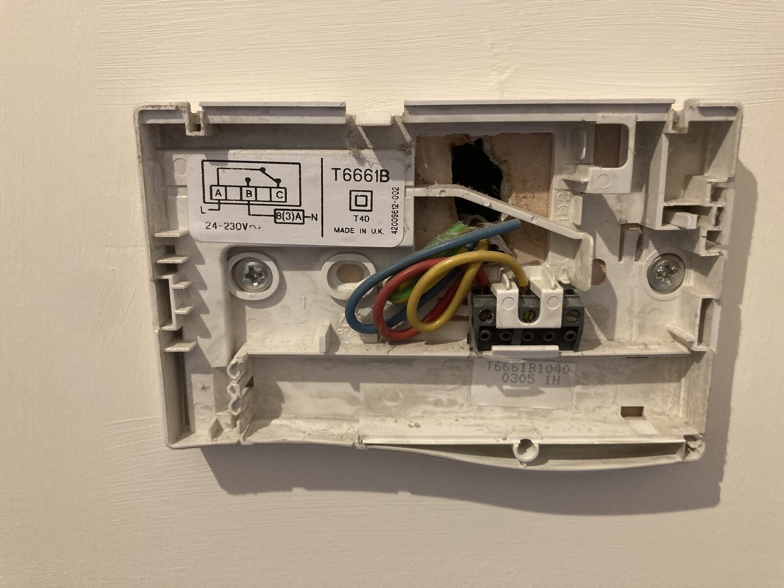

Hello, I’m looking to install my hive on place of a Honeywell cm61 the cabling looks different to my old stat no neutral.
At my old place I just linked from L to no 1 with a N and pin 3 as the switch … any ideas ?
Do you have a combi boiler or conventional/system boiler with motorised valves?
Looking at the wiring it’s likely going back to the fused connection unit, which is better for you so you don’t need to remove the boiler casing (would need checking for safety afterwards). If you can find out if the blue is connected to the neutral, and if not, it could be done. This would give you a permanent live and permanent neutral, then linking the L to com and then use the switch live to the boiler, which is your yellow.
