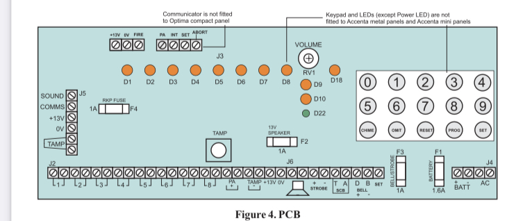

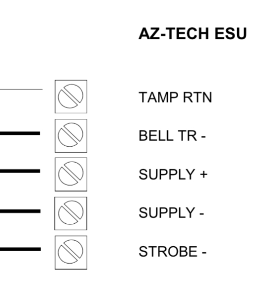

Hi guys new to this but replaced my old Honeywell g3 alarm as keypad buttons worn out so replace it with g4 version alarm and new bell box can anyone help me wire up my new bell box it’s a kinitic az220 alarm bell box to g4 alarm panel

bell tamper, panel tamper keypad tamper?
if you place a link between T and A in the panel, this would rule out the bell tamper
Tested each wire from panel to junction box in loft and every wire is tested and all good take panel out of engineering mode and goes back to tamper lock out going to look at bell box outside now
Finally found it was the screw holding the bell box bending the backplate in top right screw which was the problem happy days
Micro switch was pressing down
