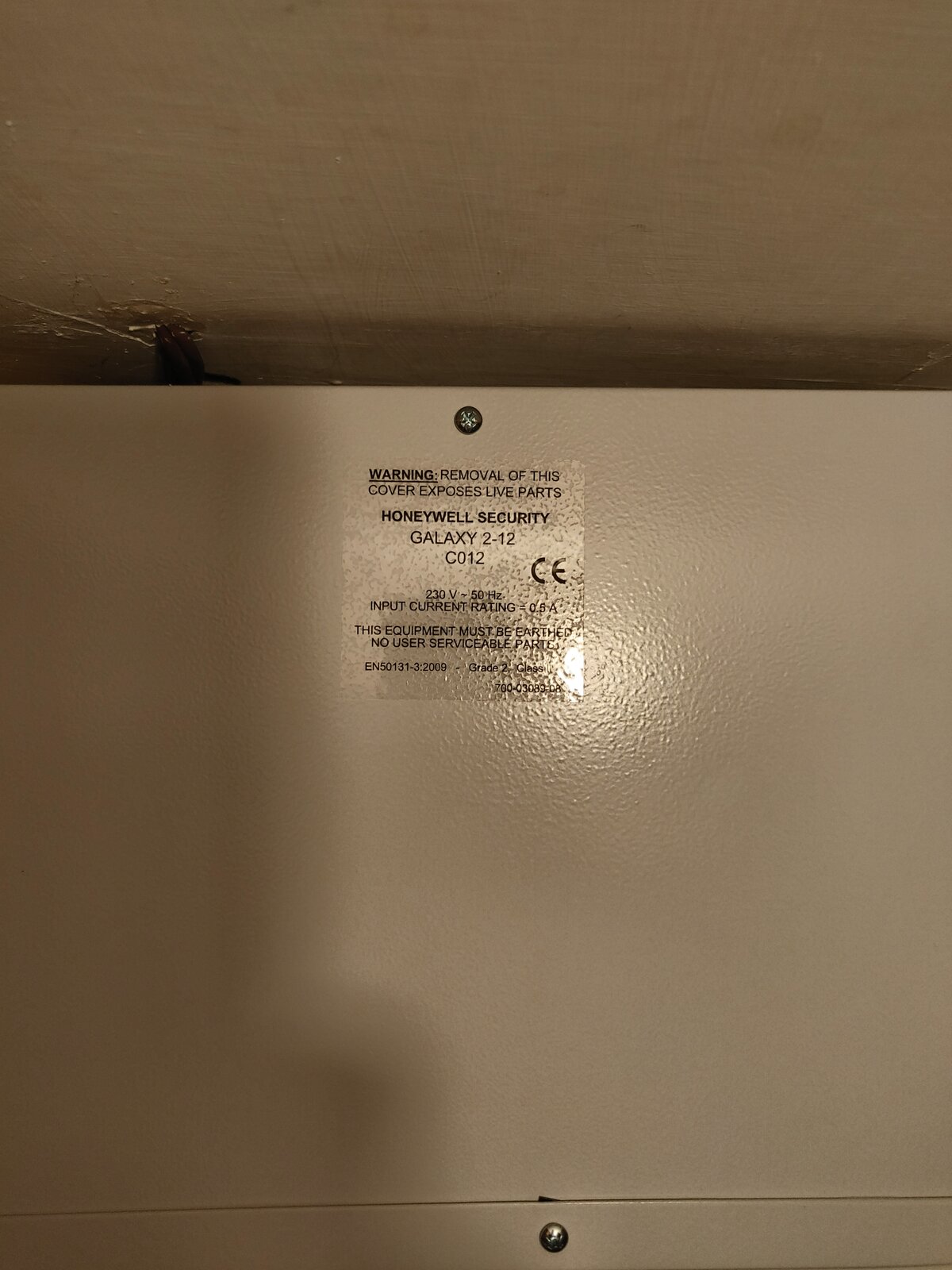

Hi All
It's time to change the battery
Reading all the posts I know what to buy and I think how to change
My concern is that I don't know is if the panel has the tamper alarm connected or not.
What happens if it is?
Will my User Code silence the bell
Am I able to change the battery using my User code only or do I need the Engineers code?
Thank you all in advance
The user code will stop any sirens sounding. You need the engineer code to clear the tampers.
Hi
Had the guy who installed it come round and do this
He also gave me the Engineer Code, so now I have our user code and engineer code
Will I ever need any other code ?
That should be all you'll need. Engineer menu 51.21 can reset the manager code if required.
