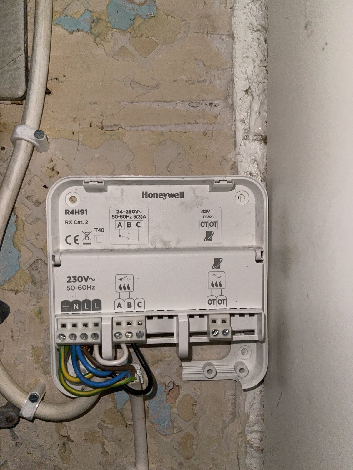

Hi all,
Could someone please be kind enough to walk me through swapping over my current Honeywell smart thermostat for the hive if possible?
I’ve bought the hive active heating 2 and my current boiler is a combi boiler - Worcester green star 25i. As you can see on the attached photo this is my current installation of when the boiler was originally fitted. Will this be a straight swap for the new one. Mine will be the single channel receiver. I’m familiar with all of the others but the black and the white cables.
Any help is much appreciated.
thank you

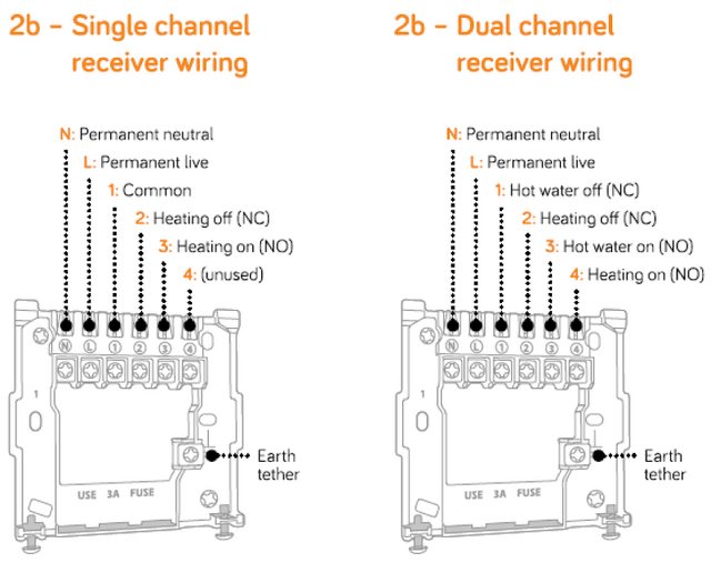

The wires in the existing thermostat N & L will go to he Hive Single Channel N and L. [The two L terminals in the Honeywell are connected together so are really the same terminal]
The white loop wire will go between Hive L and Hive 1 (Common)
The black wire in B will go to Hive 3 (Heating On)
Earth wires go in the Hive Earth Tether

Thank you so much for taking the time to explain it to me. I will do it tomorrow and post back if there’s any issues. Thank you again

I wasn't sure exactly what the OP had. I recognised the R4H91 receiver, and I know a Lyric, but I don't know a Lyric T40. AFAIK T40 is what the old Honeywell mechanical dial thermostat is sometimes referred to. However the photo of the receiver reveals that the original thermostat does offer OT control (although not connected in this case) which Hive doesn't.
