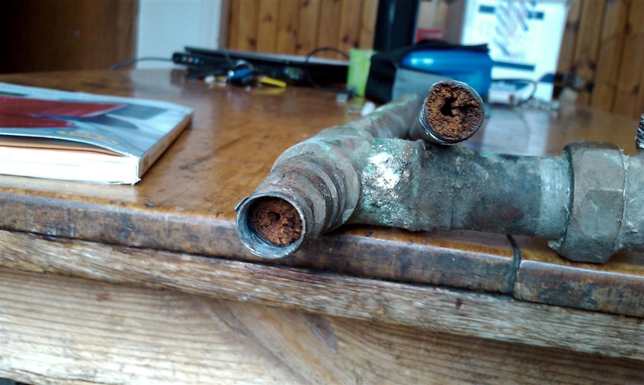

Well anyway, I have removed the pump and I don't seem to be getting any water feed to the inlet of the pump, even with the isolation valves open.
Looks like I may have to get a "man in". The device for indicating the presence of water has not been indicating this for some months, so perhaps my problem is more serious than just a pump or valve problem.
That was the conclusion I initially came to, but then I realised that required that there is a constant loss of water in the system when the heating is used intensively that has to be made up with the feed. Perhaps that is a reasonable assumption.
Is there a good way to clear it such a pipe?
I do have a bendy wire thing for clearing pipes, would that be a good thing to try?
I did have an incident with the expansion tank some months ago when the ballcock stuck and the water level became low, perhaps something went down the feed?
I was a little reluctant to come to that conclusion as that would only occur if there is a constant loss of water in the system when the heating is used intensively. Perhaps that is a reasonable assumption
The problem with assumptions.
Is there a good way to clear it?
Cut it out and replace it.
Well I can do that. I even have pipe benders and the like.
Hhhhhhhhhmmm.......... and the amount of copper tubing required is quite small and I can join onto the existing pipe work with a simple joint.
It doesn't seem like there can be any other explanation for the lack of water.
And of course this would account for my pump running and there being no flow, it was running on air, and I thought the poor valve was at fault.
This would also explain why the problems have occurred when the heating was running more intensively and there was greater water loss.
Is it worth trying to stick my bendy wiry pipe cleaner down it first? Or is that just a waste of time?
WOW!!!!!!!!!!!!!!!!!
Those are some scary pictures!!!!!!!!!
Are they of feed pipes or just pipes in general?
The pipes near the pump are not clogged up, but then that is new pipework put in 8 years ago, I don't think the rest of the central heating can be like that because it was all working fine a week or so ago or at least it would work when I bashed the area around the pump for a bit.
Dan, anyway, thank you so very much for that suggestion, I do believe that is what I will do!
I suppose if I cut the feed and find that it isn't horribly blocked I can always join the old pipes together.
