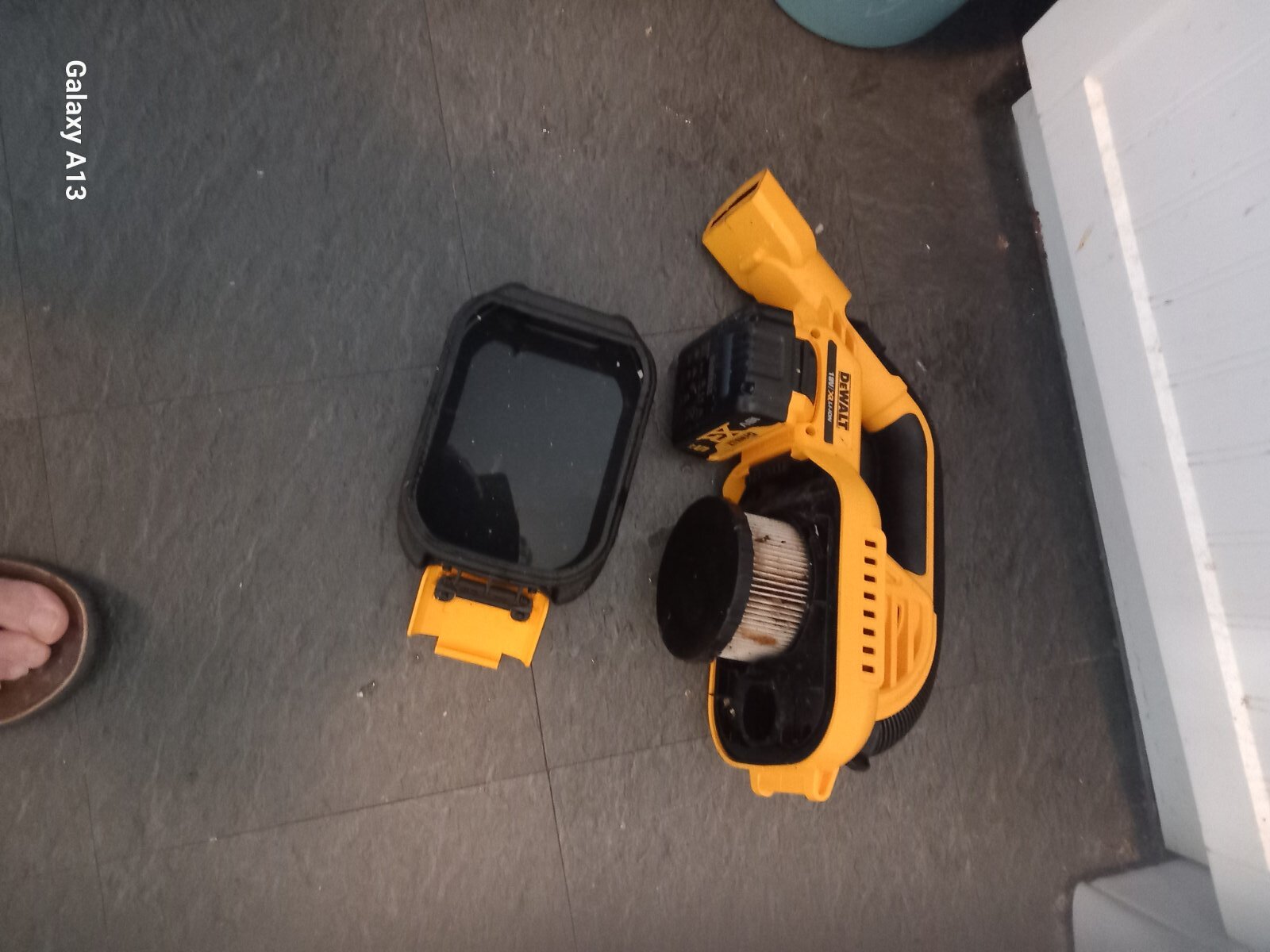

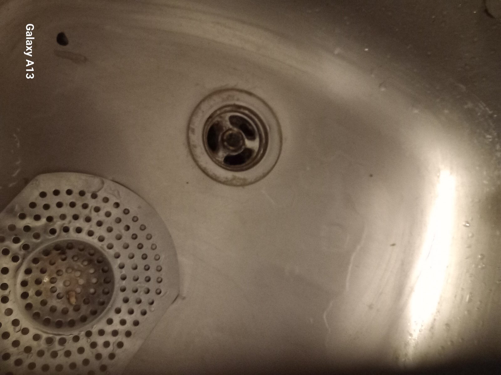

This little hoover isn't sucking into waste storage bit, why's that? Also if I've unblocked the crap in plug hole why isn't it draining quickly?
remove the filter when sucking water
the filter needs to be dried and possibly replaced iff paper and ruined
The sink waste is blocked .
The vacuum filter is probably blocked ( they are wet and dry filters).
Under the filter, is a float valve, which closes, when the water in the container rises beyond a set point, to avoid water entering the motor. Likely, judging by the level of water, in that container, that point has been reached, so it needs to be drained...

This guy seems to be charging customers for his services, and work, as a professional would - yet here is on a DIY forum asking the most basic of questions, many of which are just basic common sense, or easily answered by reading the instructions on the box.
It's a feeble dust removing device, not a drain unblocker.
Blocked further away.
If you want a vac to unblock a plughole or similar, then get one of these: https://www.wickes.co.uk/Wickes-Wet+Dry-Vacuum-Cleaner-With-Blower---1250W/p/215735
Or more likely remove the trap under the sink and clean it.
Do you never read the instructions provided with these things?
No. It was pushing the water out the side vents though when the container got completely full with filter taken out
