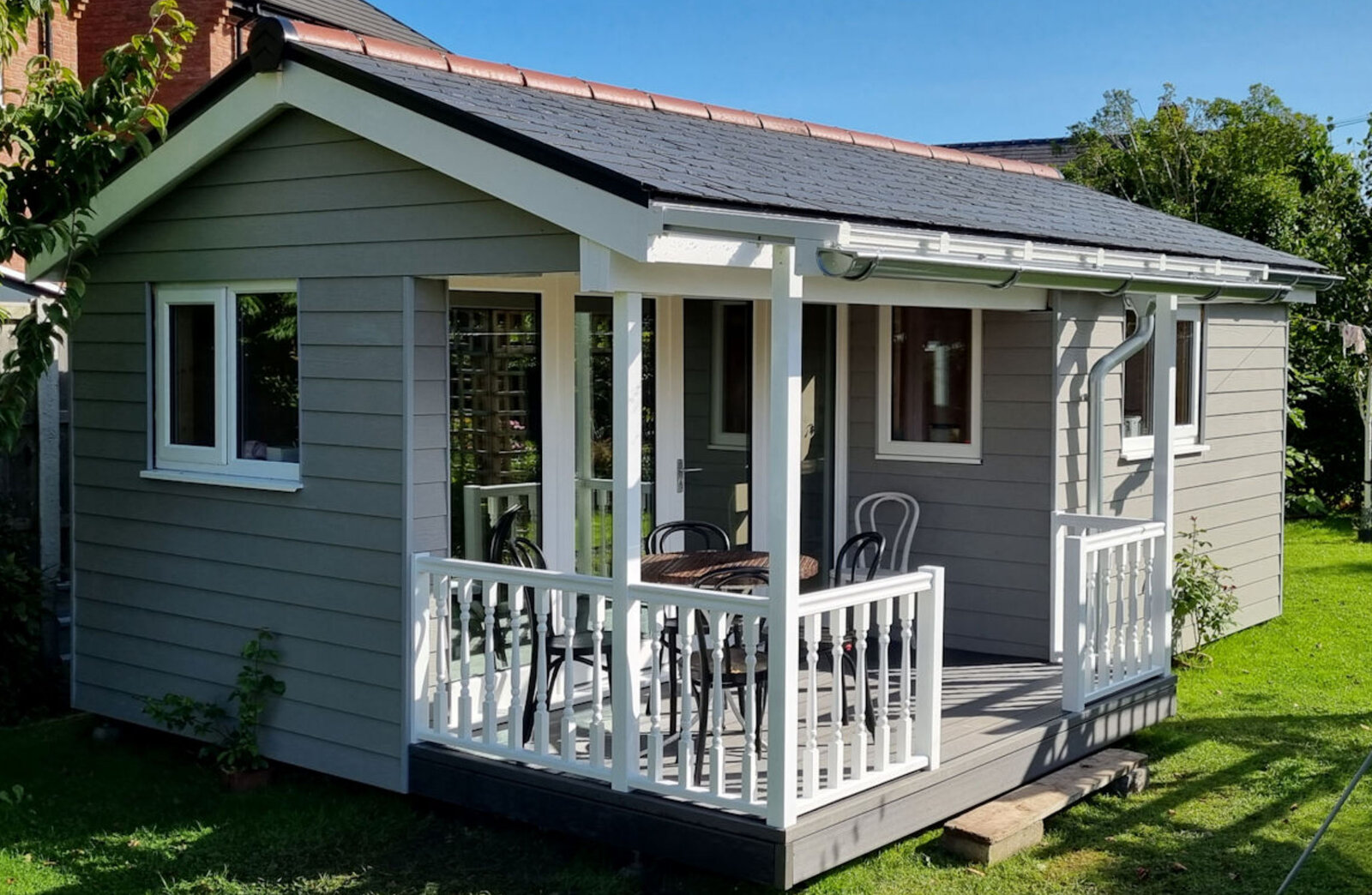

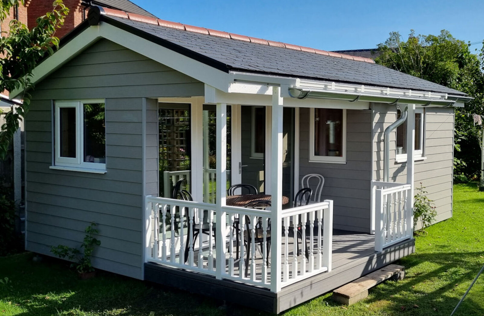

Mine's 6.5 x 3.6 with a 3.3m ridge and 2.3m eaves
only just over the 1m from boundary nonsense
Y mine too. When I went for planning I illustrated how a pitched roof with 2.3m eaves a bit away from the boundary was going to be better for the fairly close neighbours than a 2.5m wall right on the boundary......
