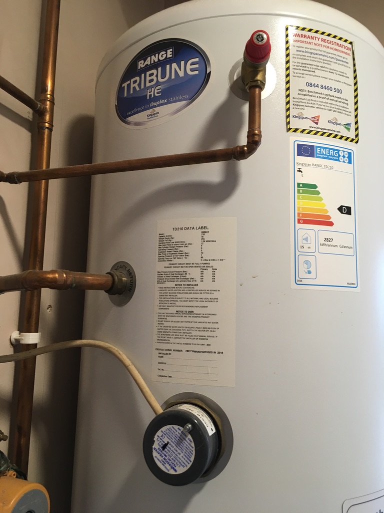

I have a Horstmann Economy 7 quartz controller fitted to a Kingspan Range Tribune HW tank. Both are relatively new (4 years old). For no apparent reason the hot water has stopped heating up overnight.
The boost setting still works, and the 'timed' light comes on on the controller when it should be heating the water overnight, but the water isn't getting heated on the timed setting.
Any ideas what the issue might be?

4. A photograph of the cylinder, immersion heater(s) and controls would help if you need further advice.

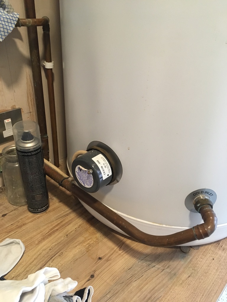

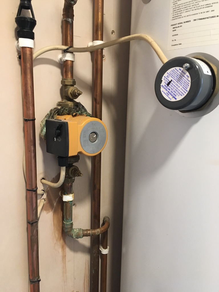

Oldbuffer - I've attached some photos - there don't appear to be any obvious reset buttons...
1. You have to remove the black circular covers from the heaters to see the reset button, hence the warning about exposed terminals and mains voltage.
2. Isolate power, both standard and economy tariff.
3. Undo small nut, remove cover.
4. Reset as appropriate, replace cover, do up nut reasonably tight so children can't undo it, power back on.
5. The economy tariff (if any) will almost certainly power the lower immersion, heating up the whole tank overnight on cheap rate. There will only be power on this circuit at preset hours, normally around midnight to 5 am. However, there are different tariffs with different hours, so the time of day must not be used to assume no power.
6. The top immersion will be on the standard tariff and will boost the top third of the tank if you run out of hot water.
