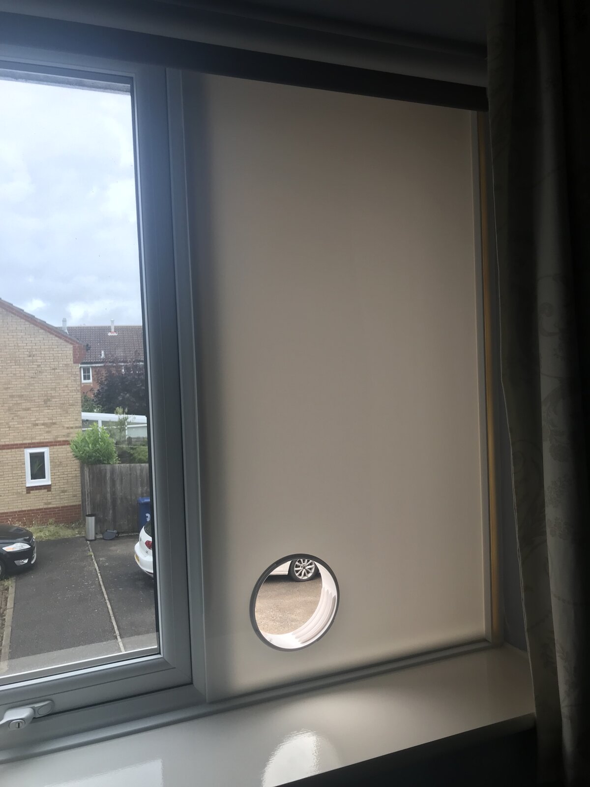

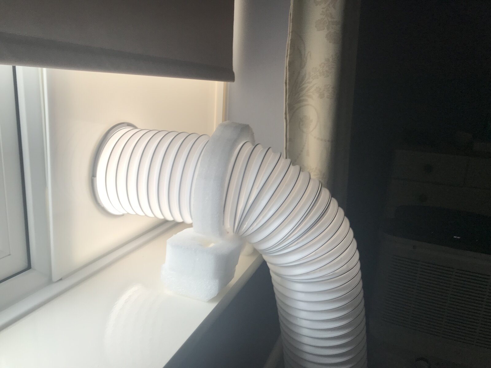

Quite a few people rubbish portable air conditioners but I bought one earlier this year for the hot spells, but I had a plan. I designed and had made up a sheet of Perspex made to spec to fit over the inside of half of the office window, allowing the air-con duct to attach with little or no leak of the hot air from outside making its way in. Today is the first real test. The outside air temp reached 30C, the office was 25C with a stuffy 65% RH. Within an hour of running the air-con the temp in the office is now 23C and the humidity down to 59%. Yes, the air-con unit is quite noisy but I have active noise cancelling headphones and can happily listen to the First Night of the Proms with no distraction.
