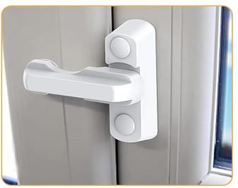

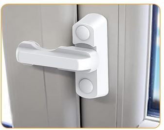

I did a very similar thing as your window design only I used 4mm mdf and once the window is opened I manoeuvre it in and put in place of the opener I then hold it in place with window security turns.Quite a few people rubbish portable air conditioners but I bought one earlier this year for the hot spells, but I had a plan. I designed and had made up a sheet of Perspex made to spec to fit over the inside of half of the office window, allowing the air-con duct to attach with little or no leak of the hot air from outside making its way in. Today is the first real test. The outside air temp reached 30C, the office was 25C with a stuffy 65% RH. Within an hour of running the air-con the temp in the office is now 23C and the humidity down to 59%. Yes, the air-con unit is quite noisy but I have active noise cancelling headphones and can happily listen to the First Night of the Proms with no distraction.
Nice idea, that may have worked for my window if I made it to fit from the front and slotted in, so to speak. I have two small strips of velcro along the centre gripping mine along with Stormguard E profile draft proofing tape that provides a tight seal and holds the Perspex and hose flange in place.I did a very similar thing as your window design only I used 4mm mdf and once the window is opened I manoeuvre it in and put in place of the opener I then hold it in place with window security turns.
So like in the picture imagine the opener being my MDF and I have a turn on each corner. I then designed the hose connection to be a slide fit into the MDF and the whole thing is set up in 1 min. I used the plastic window kit that came with the Unit and modified it and attached it to the MDF
