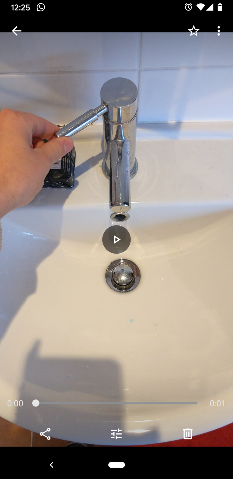

Hey there, thanks in advance.
My upstairs bathroom HOT tap (mixer tap) HOT ONLY (COLD IS FINE) VIBRATES when on.
To stop vibration i i ha to let less water out. But the stream is verry small.
Only happens to one tap
Kitchen/shower ect is fine
Will changing the tap fix? As to me, thats an easy and reletivly cheep fix.
Or is it something else?
Thanks.
I tried to upload vid but file was too large. :/

Ah, ok clicker waste (after a quick google) is the plug. So thats fine :)

CHANGED THE TAP
PROBLEM STILL PERSISTS.
so what else could it be?
I hazerd. Guess that maybe its a water presure problem? Maybe not enough? But strange that it happens to this tap ONLY. How would i i about sorting that? Our system is the "old" way. Boiler. Hot water tank. Cold water tank in loft.
Have you checked the float valve that serves the hot water cylinder?
Your cylinder is fed from a cold water storage cistern (aka tank), which when you run hot water from your cylinder the hot water drawn gets replenished with cold water by this cistern. If the valve washer has perished, then chances are this could be the cause of some noise. If you changed the tap, is it still this tap that makes the noise?
But the problem only occurs with this perticular tap.
As an intrest,
I was playing around with the isolator valve by the hot water pipe into the tap. With the tap on hot fullblast, it will make the noise n water will be on off on off on off. But as i turn the isolator off it stops, the water runs of course, but slower, but no noise, no judder
