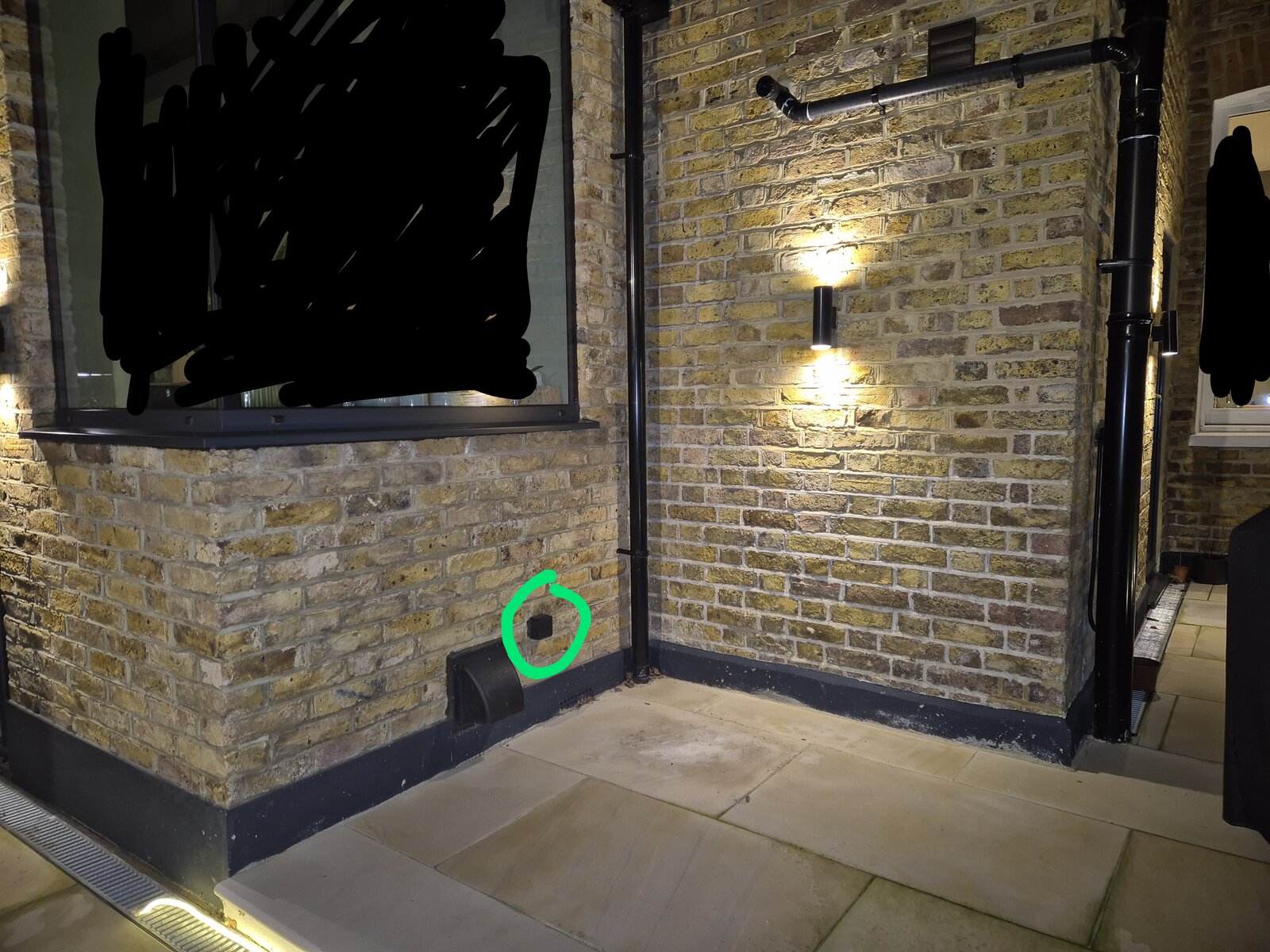

Hi
From reading around, I understand that the recommendation is for an isolator to be 2m away, this is to avoid someone in the tub being able to access the isolator.
See photo. Circled is where the 32AMP supply comes to.
This is also the exact spot we want to put the hot tub.
Grateful for recommendations of where we can put the isolator. Can it stay there, is the 2m figure just a recommendation, rather than a rule. If it it below the height of the tub, with a 20cm gap and an IP67 rated isolator.
2m is the requirement from Section 702 in BS7671, and excludes switchgear and junction boxes from that 2m distance around the tub.
Even without that, you can't locate anything where that box currently is with the tub up against it, as there will be insufficient access to it.
The light currently on the other wall is also a problem, as are those further away as they appear to be less than 2m distance.
Then there is the rope light affair towards the lower left corner of the photo.
There may be other problems and considerations that are not possible to determine from the photo.

If the regs exclude Switch Gear and Junction Boxes.
- Can the isolator be located above that?
Or can I leave the junction box where it is, run cable externally, and locate the isolator a few metres away?
The wall light can be moved or just capped off, as necessary. The rope light is a non-fixed temporary decoration.
Just concerned about the junction box and isolator.
Excludes means you can't have them there. Within 2m of the edge of the tub, no switchgear, no junction boxes, no lighting fixtures.
If it's connected to 230V AC, then it must be at least 2m from the tub horizontally, and at least 2.5m vertically.
There is also the question of how you expect to be able to open the cover of the tub if it's against a wall on 2 sides.
The reality is that the tub needs to go somewhere else.
The cover is fine. The hot tub fits fine.
The other option is I could run a new supply if I needed to. But, I find life a more fulfilling experience when I look at what's there and come up either with a solution, or with options, rather than deal in absolutes and have a 'computer says no' approach.
Admittedly, I'm not sure why these exist, if they are not allowed. But given that they do, presumably there is a way to have a junction box in Zone 1.
So is there a reason I couldn't use one of these?

Junction boxes are not permitted within 2m of the tub.
What level of protection the box has is irrelevant.

There is only one zone around a hot tub and that 2m means nothing electrical within it apart from the items within the hot tub and the original connexion cable supplied with it.
Everything else is excluded... Everything!

@flameport has answered your question. Not liking the answer will not change it. There is also the question about equal-potential zones, type of earthing, also what any pipes are made from, it looks to be outside, so there is a lot to consider, personally I would not do the job, too much can go wrong.

What does your electrician say, the last thing you want is after installed for the LABC to say no rip it out, new bathrooms are notifiable.
