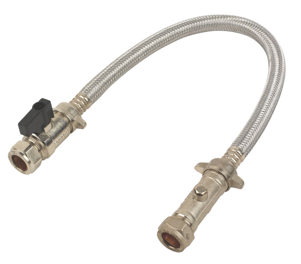

Apparently so, I don't have a filling loop connected directly to the cold water inlet valve part itself. However I do have a loop which goes from the middle of that cold water pipe, attached just above a tube marked "SESI", then looping across to another pipe. I'm assuming that's not the filling loop (based on the engineer saying "there is no filling loop") but then again, what is that thing if it isn't the filling loop?
Can we have a photo?
Probably not, my internal SD card reader is down so I can't transfer across from the camera without hassle.
But it looks like a filling loop, just not sure why the engineer would say there is none. Maybe he was talking about a loop going specifically from the valve itself because this loop is going from the pipe as I described.
It looks similar to this filling loop:
ae235
The existence of a secondary filling loop on the pipework doesn't change the fact that the boiler's built in filling loop is missing. Did your plumber fit something to the back of the service valve that was changed? NRV & blank maybe? If not you will get very wet if it gets turned. I guess he didn't fit the grey plastic tap that goes on the valve?
The plumber did show me that there was an NRV attached to the newly-replaced cold water inlet valve, and compared it with the original valve which didn't have an NRV attached.
To comply with Water Regulations the separate filling loop should have two shut off valves.
One at each end and normally the heating circuit end has one incorporated in the non return valve!
