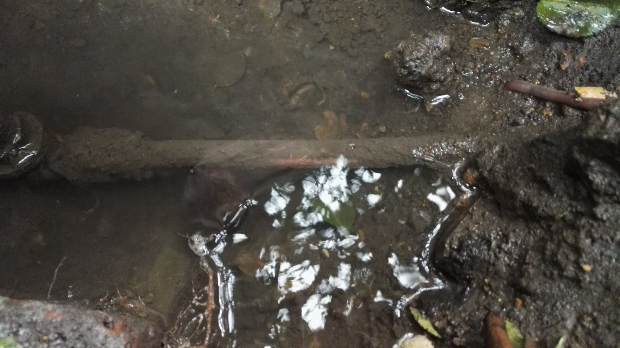

Oh, is it lead then? if it is, ask the water co to test your drinking water for lead content (free) and they may have a subsidy.
try a magnet and scratching it with a blunt knife.

Unfortunately, it's currently under 3 inches of muddy water because of the leak so I can't do the scratch test at the moment. I just tried a magnet, though, and it's not magnetic.
Sadly that's not the kitchen on the other side of that wall - that's the pavement/road. So the mains stoptap is only about 3-4 feet away.
The kitchen is in the other direction - behind me as I'm holding the camera. That pipe almost certainly runs under my front garden (about 10'), under my hallway/front room (about 20-30'), then under my tiled kitchen floor (about 20') before it reaches the kitchen tap. So replacing the pipe would, I guess, cost me thousands. I'm going to have to save that for a very rainy day.

Apologies, I did it the lazy way: I turned off the main stopcock and let some of the water drain, then did the scrape test.
It's difficult to reach, so my photo isn't great, but wouldn't you say this looks like copper?

Good call on the magnet, wise thinking. That does look rather coppery.
While the hole is sort of dry ish, have a scratch at that bulge where the pipe meets the tap, also have a look at the pipe on the other end of the tap (where it goes to the main).
It may be that your supply pipe from garden stop tap to house is copper (hurrah) but the link to the street may still be lead (would make sense if the job was done by a previous householder & they couldn't be bothered/got hassle from water company).
Under these circs, def get Thames out to replace the lead link to the street while you have a hole in the ground.
Copper, while not as strong as steel is still fairly robust- I'd definitely be having a go at carefully dismantling the stop tap if the alternative was £250.
If it's copper it will probably be old 1/2 thick wall and maybe soft temper too.
Blowlamp to the headgear washer to soften it up and swap it over...save the hassle of pipe cutting.

Once he'd finished, I watched the stopcock as he switched the water mains back on. Water came gushing from somewhere between the stopcock and the meter. Impossible to tell exactly where the leak is, but it is somewhere around my property boundary. My stopcock and the water meter in the road are only about a meter apart and my stopcock is probably 0.5m from the boundary. To find the leak will require a lot of bricks, probably with a pneumatic drill - a big job.
I immediately phoned Thames Water whose first response was that it's my responsibility. They claim anything inside my boundary is my problem. I said you can't tell exactly where the leak is right now because it's underneath a brick wall. Eventually they agreed to send someone to take a look next week.
Are they correct in saying **anything** within my boundary is my responsibility? I had believed that the pipe between the meter and my stopcock was their property?
Also, isn't a leak more likely to be where the pipe connects to the meter? I'd assume that leaks generally occur at a fitting rather than in the middle of a pipe, or is that not right?

Thames are correct- the pipe is your problem once it crosses your property boundary. If you can, I'd suggest digging towards the boundary from your stoptap to see if the leak is on your side (doubt Thames will be cheap if it is your side of the line)
The bad news- I'd expect the break to be fairly near your stoptap- in order to remove the whole tap plumber will have had to lift or wiggle the pipework & that'll almost certainly have caused the pipe to fail (if it is heavily furred-up lead then the mechanism is the lead flexes, the furring doesn't & causes the pipe to rupture instead of bending. Depends how rough he was when doing the job.......

I was there the whole time the plumber worked on the stopcock. He was extremely cautious in everything he did as he suspected this pipe was lead. He dug out as much as he could around the stopcock before trying to unscrew the old fittings and I couldn't see any lifting or wiggling as he did so.
When he turned the water back on, I could see a few inches back from the stopcock (i.e. in the direction of the mains) where the pipe is exposed and the leak was not occurring there. It was definitely somewhere further back underneath the boundary wall, but where exactly it wasn't clear.
One other thing to mention is that the chamber of the water meter has been full of water every time it's been opened up for the last few weeks, even when it has previously been pumped out. Is this significant? Doesn't that mean a leak has been there the whole time?
That's better news, if my wiggle theory was correct then water would have come straight out into your new hole
Stoptap pot full of water- if your hole hasn't filled up then its not high water table so prob been a leak there somewhere....
