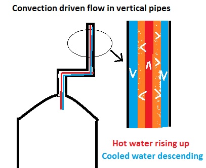

the heat stops at the valve. This implies to me that water is actually flowing slowly along the pipe.
If there is a length of vertical pipe on the hot water then this may be applicable.
It goes against "normality" that water can flow in two directions in the same pipe but in the lab with glass pipes it can be clearly seen.
Wow really?
The hot comes out of the cylinder HORIZONTALLY. Then there are a number of 90 degree fittings, and then a 45 degree upward and sideways movement, then horizontally to the Tee piece. Then both of the Tee'ed pieces go vertical. The pipe is only hot for the first 3-4 metres (where the pipe is all horizontal) from the cylinder
Convection flow can also occur in a horizontal pipe. Hot water at the top of the pipe from the tank and cooler water at the bottom flowing back to the tank.
The effect is small, very small if the pipe is adequately lagged.
