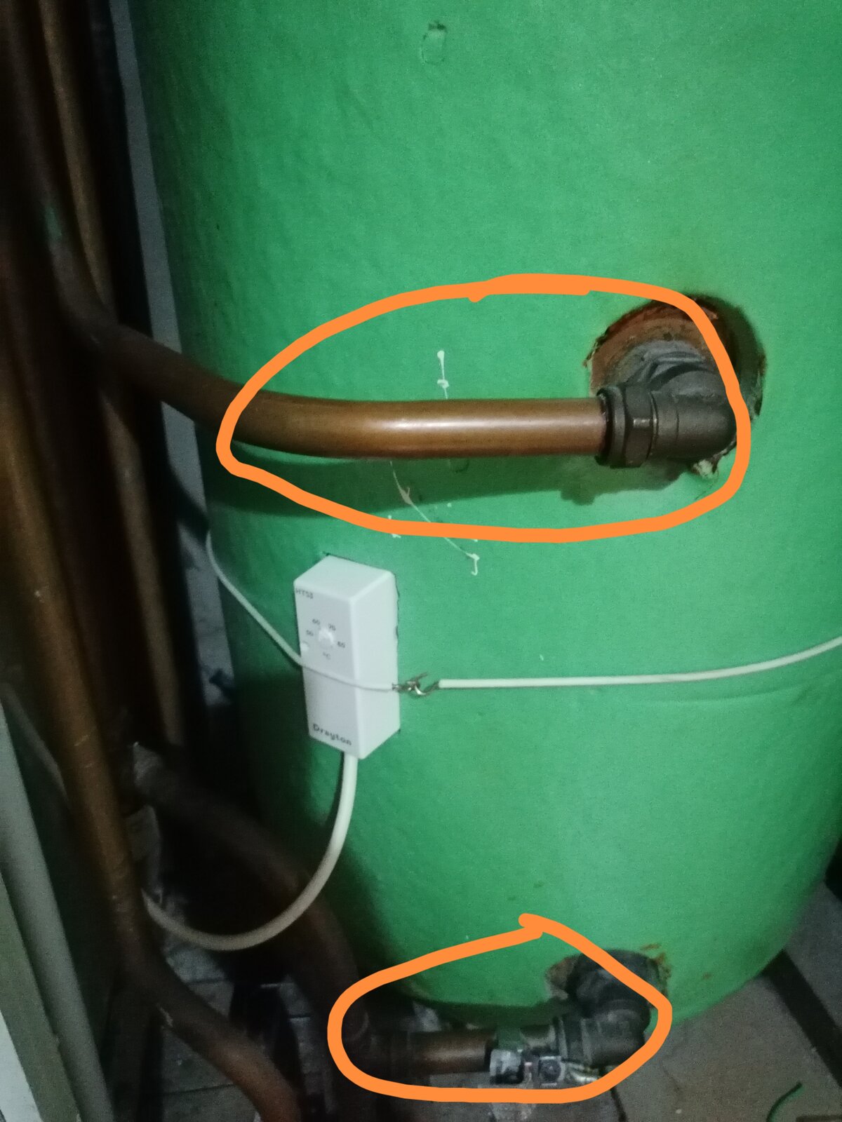

Pipe below HW motorised valve has change in temperature when HW turned on at programmer and shuts off when turned off. Any ideas what needs looked at next why water so hot in hot water tank when not turned on? I also got a new pump installed last month. Cheers
For the hot water in your cylinder to heat ,then hot water from your boiler has to flow through the cylinder coil ,and back to the boiler. The mechanical part of the valve body would need to be open ,even partially,for that to happen.
With no demand for hot water at the programmer ,and central heating on at programmer ,feel the two pipes that connect to the cylinder coil . If both get to the same temperature ,then hot boiler water is flowing through the coil.
If there is no heated water going into the cylinder heating coils when the HW is turned to off, then that is obviously not the source of heat. You need to be looking elsewhere and the only other likely source is the immersion heater. Try turning the MCB/RCBO for the immersion heater off.
The two pipes that connect to coil are hot same temperature. The pipe from HW motorised valve is only hot in the circle part above the stat.
Do you mean the pipework ,from the area you circled ,upto the zone valve is not hot ? And the bottom pipe from coil is VERY hot ? All with only central heating running ?
Yes that's correct both circled areas hot and pipework from valve until it bends coming down not hot. Heating off now 1hr30mins and circled area above the stat is still hot all other pipes cold and immersion still off at circuit.
Have you noticed any discolouration in your domestic hot water ?
If you run programmer on hot water only ,no central heating ,and feel the two pipes ( circled) where they meet the cylinder ,which one heats up the first ??

When turned on HW and water started to flow top circled pipe went cool(was still hot before HW turned on) and bottom one warm but top one was first to heat up properly were u could just touch it.
